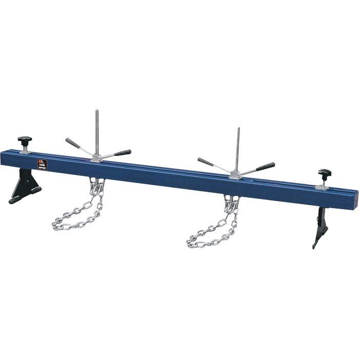

Try the shop manual. Was it an engine mount? Anyway for most shade tree DIY'ers you need to raise the engine with one of these. About $60 @ Harbor Freight
