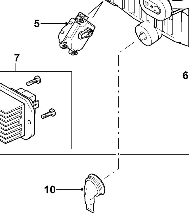

what is a duckbill?

The duckbill is the description given to the end of the air-con drain (item 10). The end looks looks a bit like a ducks beak and opens when there is sufficient water collected to force it open.
In supposedly stops insects crawling in.
Cutting the end off allows water to drain more easily but it is a pain to get to.
