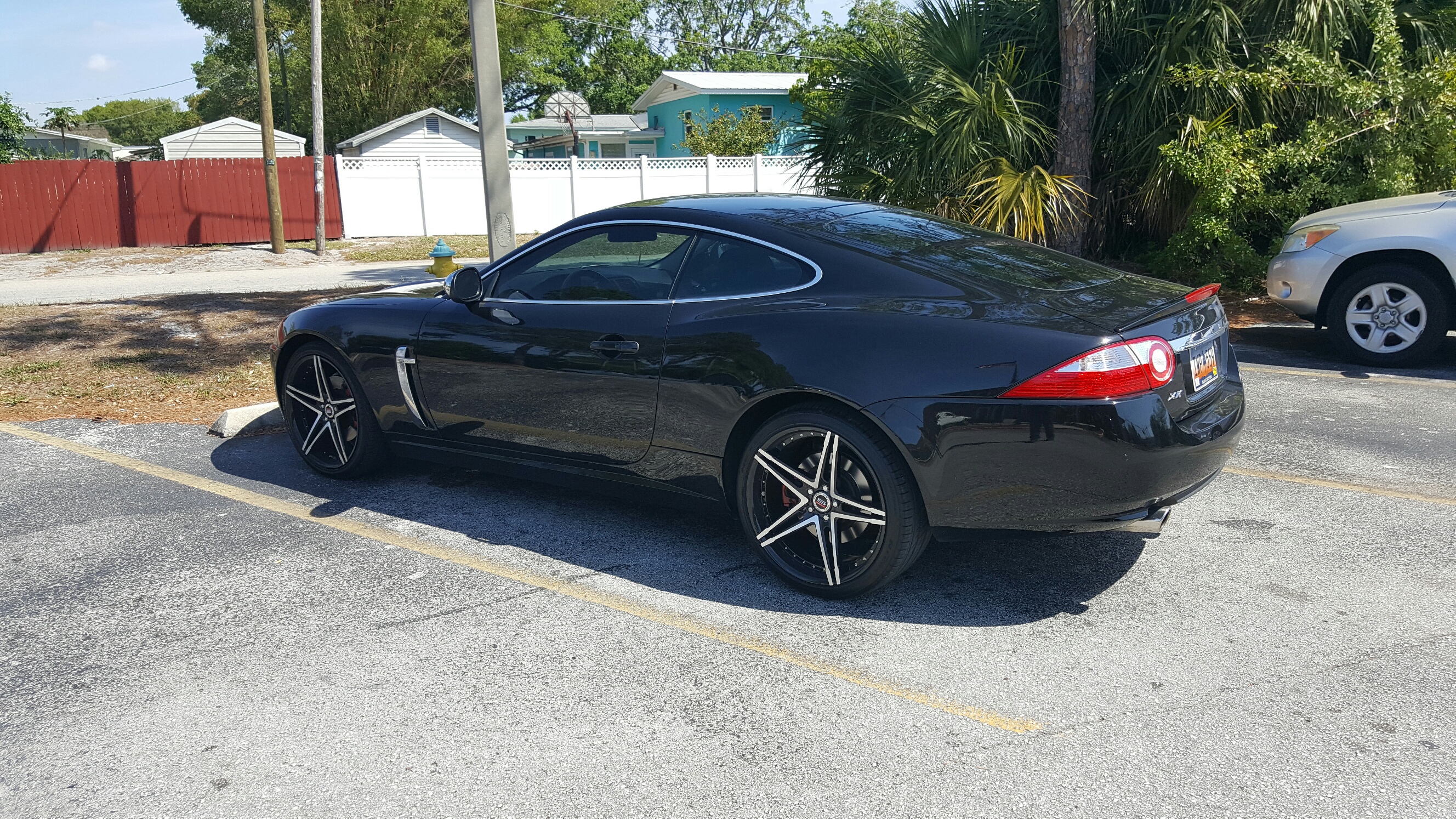

I tinted my 07 Coupe...
Here are a couple pics...
All the tint is a dark as I could go legally in FL
Attached Thumbnails Tinted rear windows-20170330_114243_resized.jpg   Tinted rear windows-20170401_183104_resized.jpg   Tinted rear windows-20170401_183136_resized.jpg
