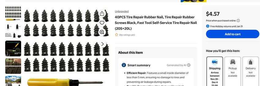

I carry a squirt bottle of green slime, a can of fix-a-flat, a small halo battery backup/air pump + a 'new' spare + rubber coated screws.

Some tire manufacturers void their warranty if you use that slime crap. Many tire repair shops will also refuse to work on them. rubber screws and an air pump should get them to a shop, or a AAA card that includes towing.
