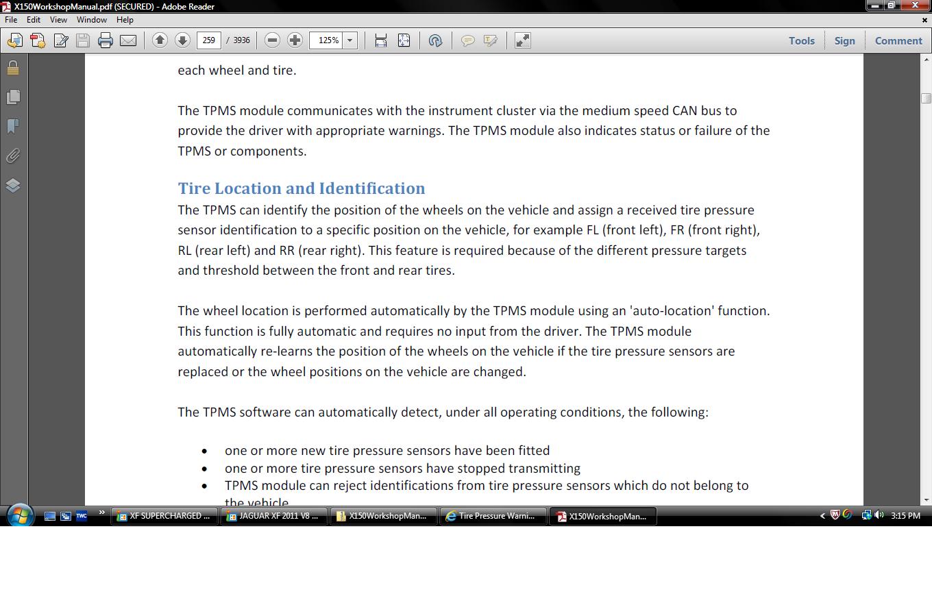

Thanks for the in-depth explanation on the altitudes influence on air pressure. The fact is, I have been driving the XK, as well as, two Land Rovers up and down the hill for 10 years. The problem, as described in my post, is a recent "phenomena" which very well may be amplified by the climb.
With that said, it's my understanding that the warning is triggered by either; (1) a difference in a tires pressure, as it compares to the others and or (2) if the tire is 4 to 6 psi lower than the required pressure.
What I am failing to understand is why the dash icon warning, that illustrates which tire is out of range, was rotating clockwise highlighting each tire?

I suspect that the rapid 7,000 foot increase in altitude caused the pressure in all 4 tires to fall below the required minimum, thereby triggering the warning for all 4 tires.
I'm not a tech (and I flunked out of engineering school, fortunately!), so that's just my WAG.
Stuart
p.s. When you're parked at home (sea level) let the air out of all 4 tires to 20 psi and see if you get the same rotating tpms display. If so, you know that the increased altitude was the culprit and the tpms did what it was supposed to do.

Probably the module behind the rear seats
The wiring to the INITIATORS for the rear wheels can be seen by laying on the gnd near the rear wheels and looking up infront of the rear wheel are. The front INITIATORS require removal of the front tires and the panel in front of the front tires to see the wiring. Neither of which is the cause imho.
The RECIVER is next to your right knee under the console.
Memory here: INITATORS send signal to SENSOR in the wheel .........SENSOR responds by sending data to the RECIEVER near your knee. .............Reciever is hard wired to the MODULE which sucks up that reciever data, massages it and if all is not well, sends a message on the CAN bus.
I've had this problem for a year. I checked the INITIATOR wiring. Good. I massaged the two harness plugs to the MODULE. That resulted in very long periods of no TPMS message faults. UNTIL about a week ago where nothing will fix the problem except probably installing a new MODULE. I believe once this is done a JAGUAR techy in so many words, has to mess with it to make it communicate with the CAN. I'm not real sure of that. All I know is that TPMS is and was made for politicians and is close to being a useless piece of equipment that I care not to fix. Money thrown down the drain imho. I've had flats before. I do not need this bs piece of equip to tell me a tire is low. IF I can't tell a tire i low.......then I need to sell the car and take the taxi. I'm not a cheapskate. I own a SL.

You've nailed it. I received a call from the service manager at SF British Motors, who came up with the same diagnosis, given the symptoms. I'll have the module replaced, next time I'm in the Bay Area
Thanks to everyone for helping me out...
