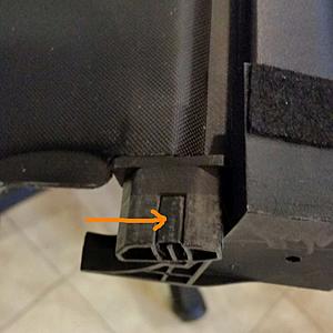

Just a metal clip on the left side of the divider. Sometimes they do fall out.

Take your luggage cover out and verify the clip, as shown in post #5, is there. Pretty sure that’s the left side of the luggage cover.
