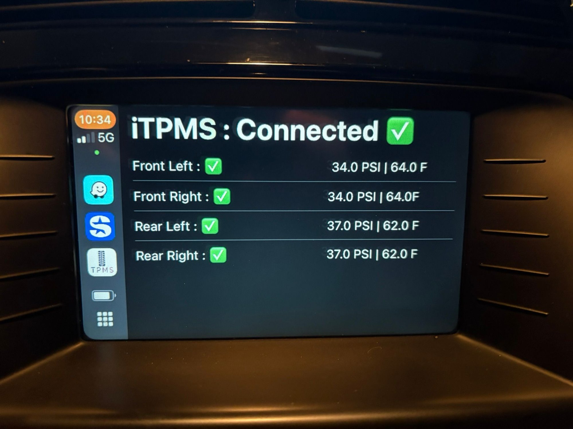

I disabled my TPMS using Autologic awhile ago…like you, tired of false warnings. Installed internal Bluetooth 5.0 sensors and added the iTPMS app to my iPhone. They work great, easy to see in CarPlay…I do have Mr12Volt…

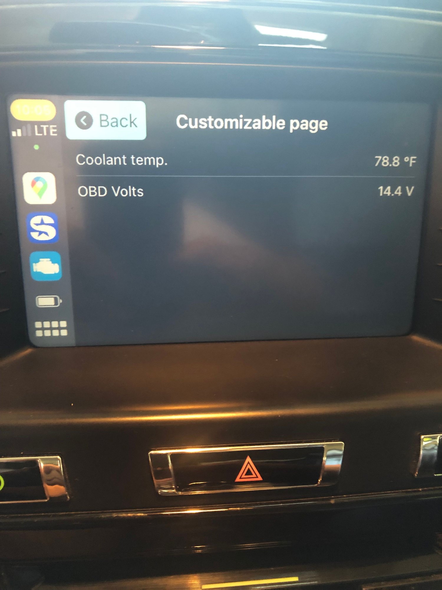

I’m more interested in the gauges app which is on iPhone now. That shows coolant temp and such.
but TPMS would be good too.

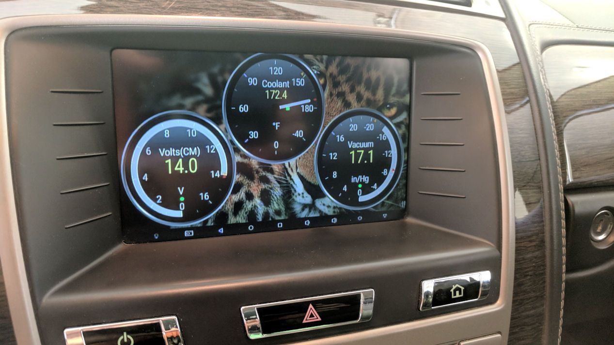

This is me, eight years ago. The entire Torque Pro program. This is only one of the possible screens.

I use OBDFusion in CarPlay…free version

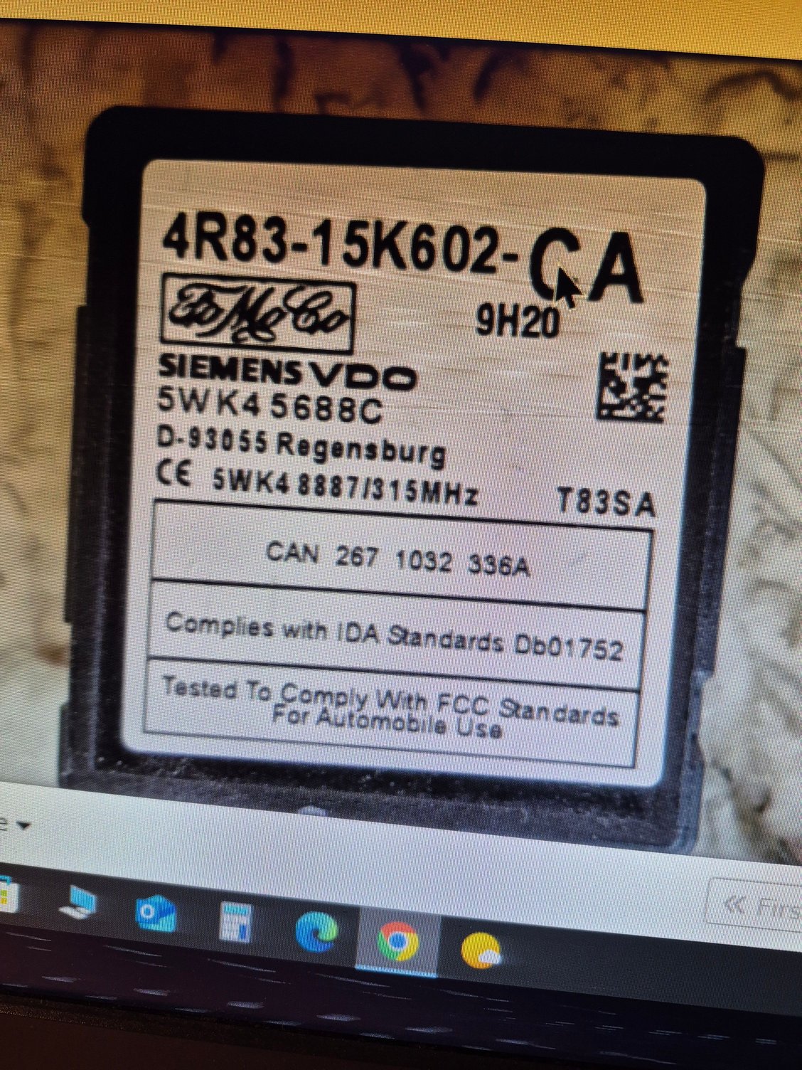

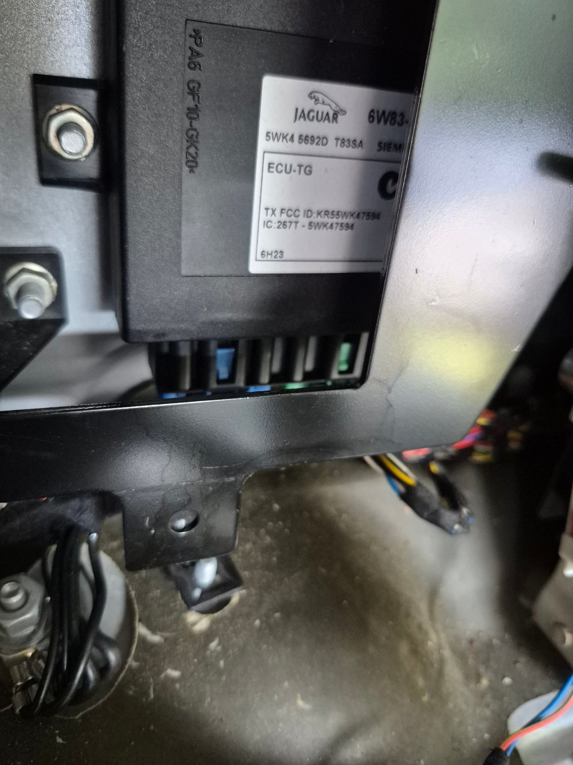

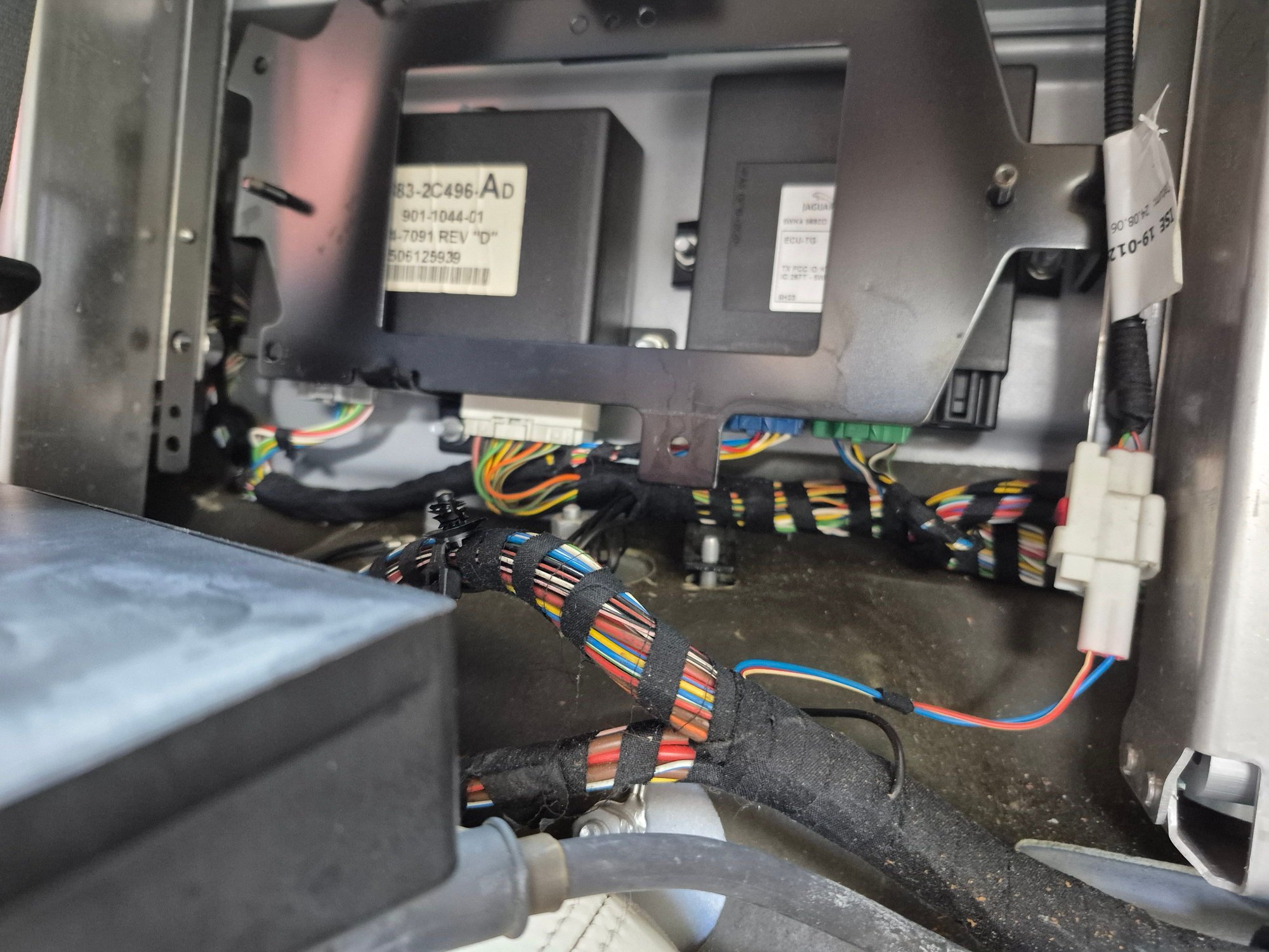

Disconnected battery and removed the rear seat fuse control. The TPMS module is on the right. Pulling lightly on the connect was successful. Then I sprayed it with contact cleaner and shoved it back in until it fails again. But now I can match the model numbers,
to find an Ebay replacement. My first attempt to load pictures!

Still the module is searching the tires for an answer. The tires are transmitting, and the module is searching so possibly the antenna is not receiving the signals from the tires. I cleaned the contacts on the antenna and let lie on the back seat, away from the fuse box and its magnetic field. Time will tell.
