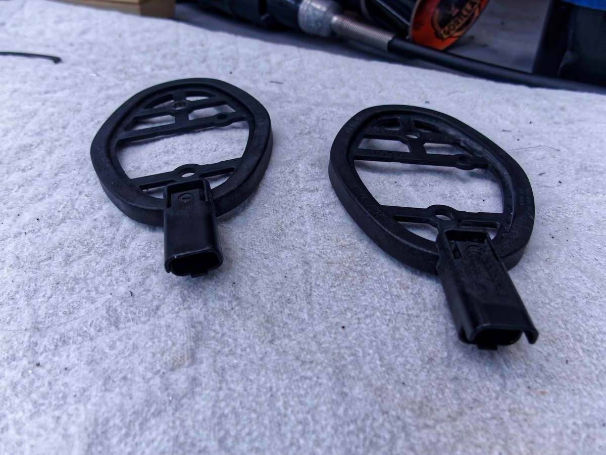

This will probably be my last attempt at getting the TPMS functioning properly in this XK!
I received two initiators yesterday, will replace the original in front right wheel well and drive for a while. If I still get errors will install the second one. Test again. If still have errors will trace front wiring and confirm that there are no issues. Then, install the other replacement in the left front and test. Hoping that the RF unit is the culprit.
My reasoning is that when I take the car to a high pressure (hand held) car wash and wash the RF wheel well (front area) I almost always get a TPMS fault immediately. (yes I've tested washing wheel well by wheel well over the months, one one week and then one another week, the RF generally (will give an immediate error). I've been doing this for several years now!
Hoping this works, will install this weekend, fingers crossed.
wj
