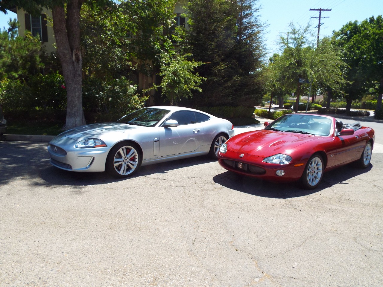

RobB,
I'll be interested in hearing your about your sessions. My (new to me) 2010 XKR is going in, today, for a few cosmetic upgrades, new exhaust, and new tires, and then I plan on taking it to the tract a little later this summer. I have found the brakes a little spongy, but I suspect the previous owner replaced pads with inferior aftermarket ones. Are you still using OEM pads and rotors?
