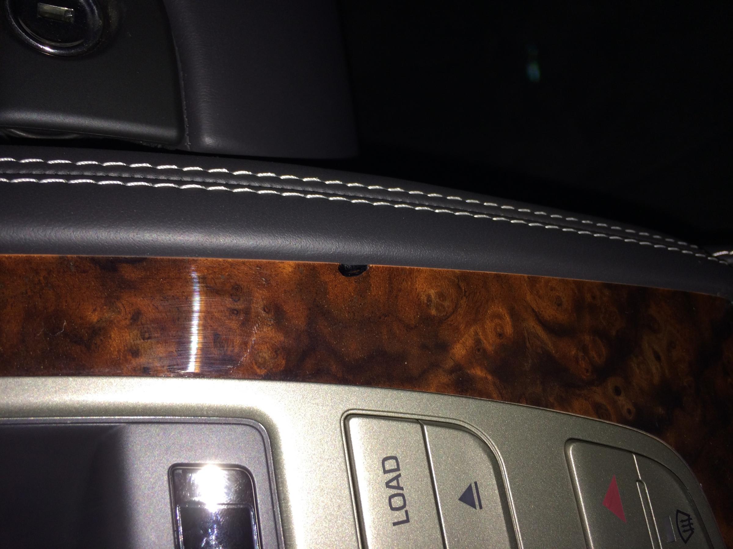

ON the XKR (5.0 2010) I bought i have fixed most of the faults and error - but still have this on the trim veneer Wood - any ideas on how to fix?
Thanks in advance
Kren

Do you like the wood trim? If you dont, you could always putty it over and wrap it in black or something else. Mine had the wood trim, which I wrapped, but some people love the wood.

You need to contact British Autowood, they can make a new one and tell you how to take old off and install the new one. I don't know about cost but it may be the best way to go.

Taking out the old one is easy. There are plenty of threads in here about that if you search interior trim removal. One linked a service booklet for it. I use the plastic trim tools you get from the auto shops, though I found for the tight fit between the lather and the centre trim, a butter knife is pretty handy.

+ 1 on Saul @ British Autowood in Orlando Florida.
British Autowood | Dashboard and Woodwork Restoration
I am also selling the wood pieces from my car if you are interested.
