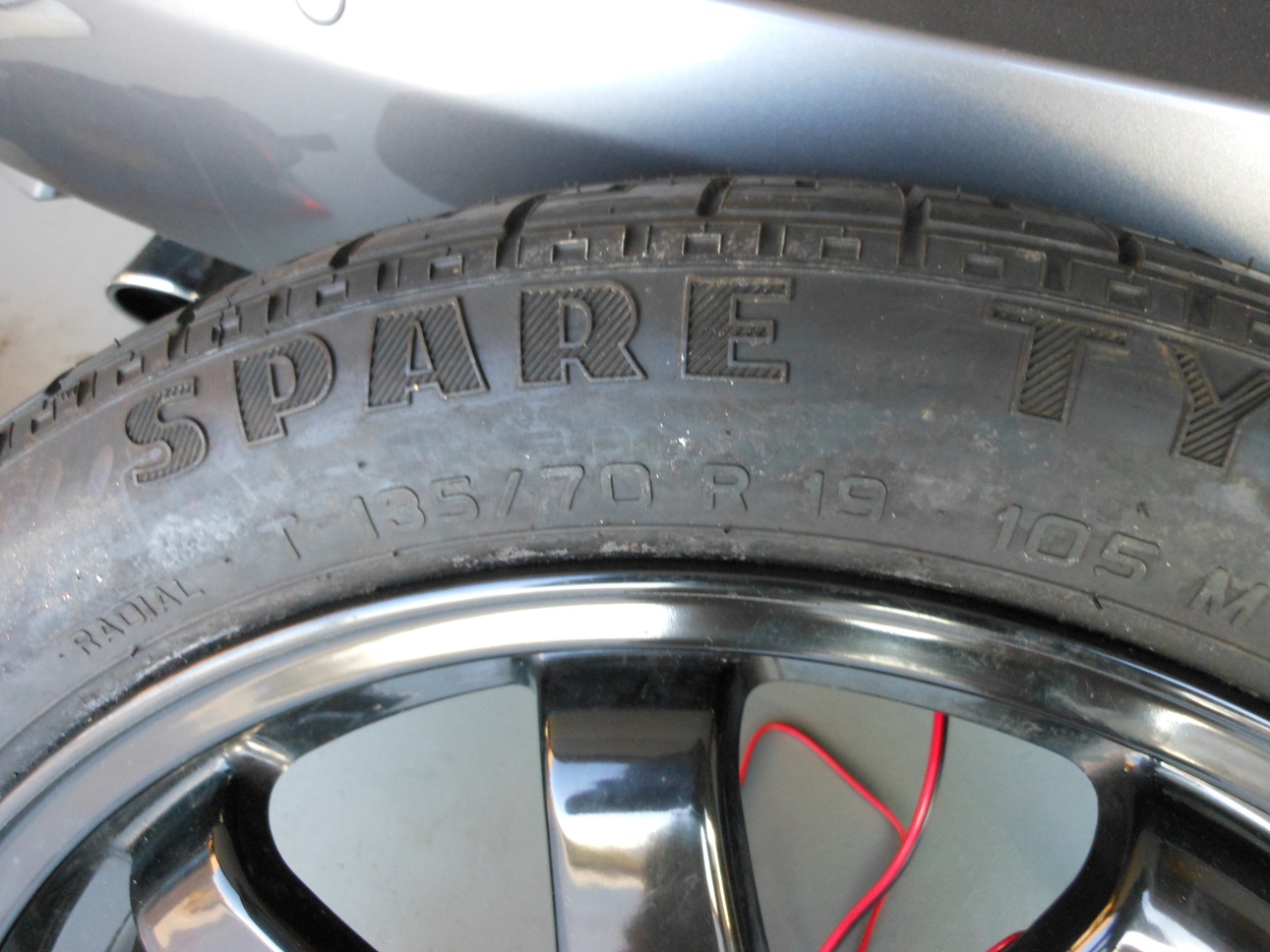

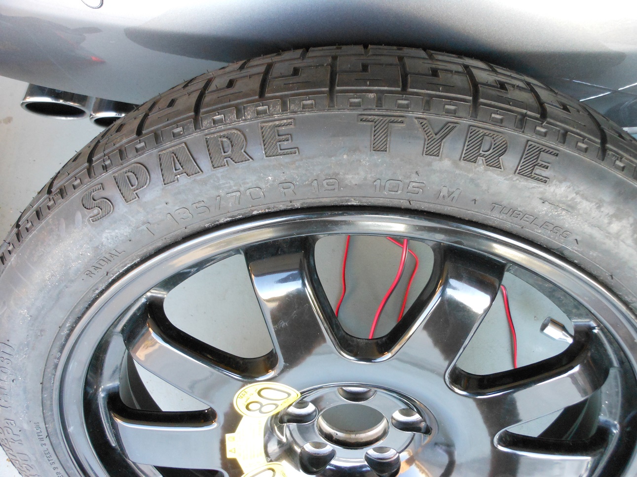

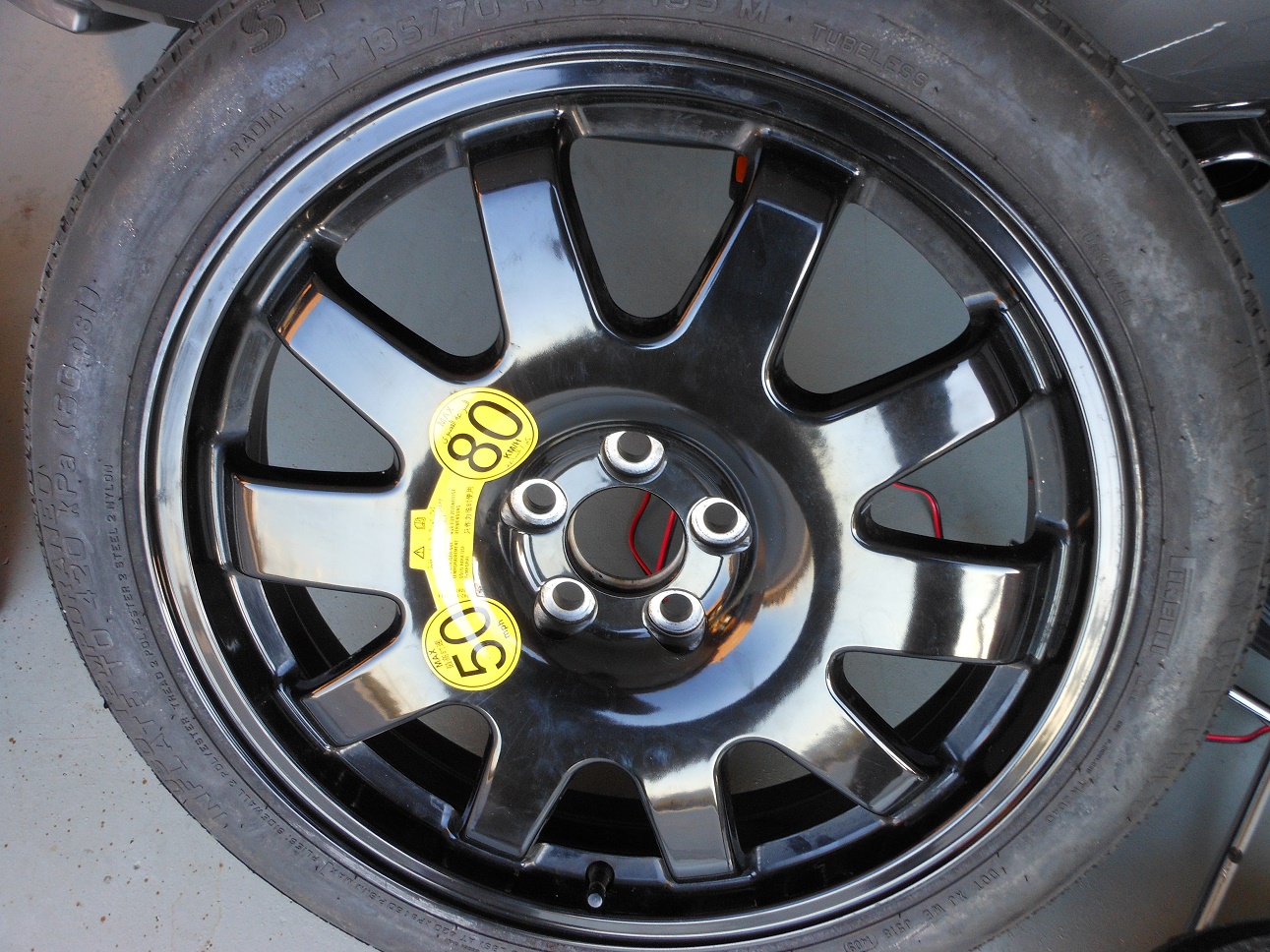

The wheel is a 19" Jaguar spare. There is NO 20" spare. The tire size is:
T135/70 x 19

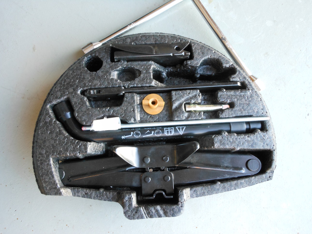

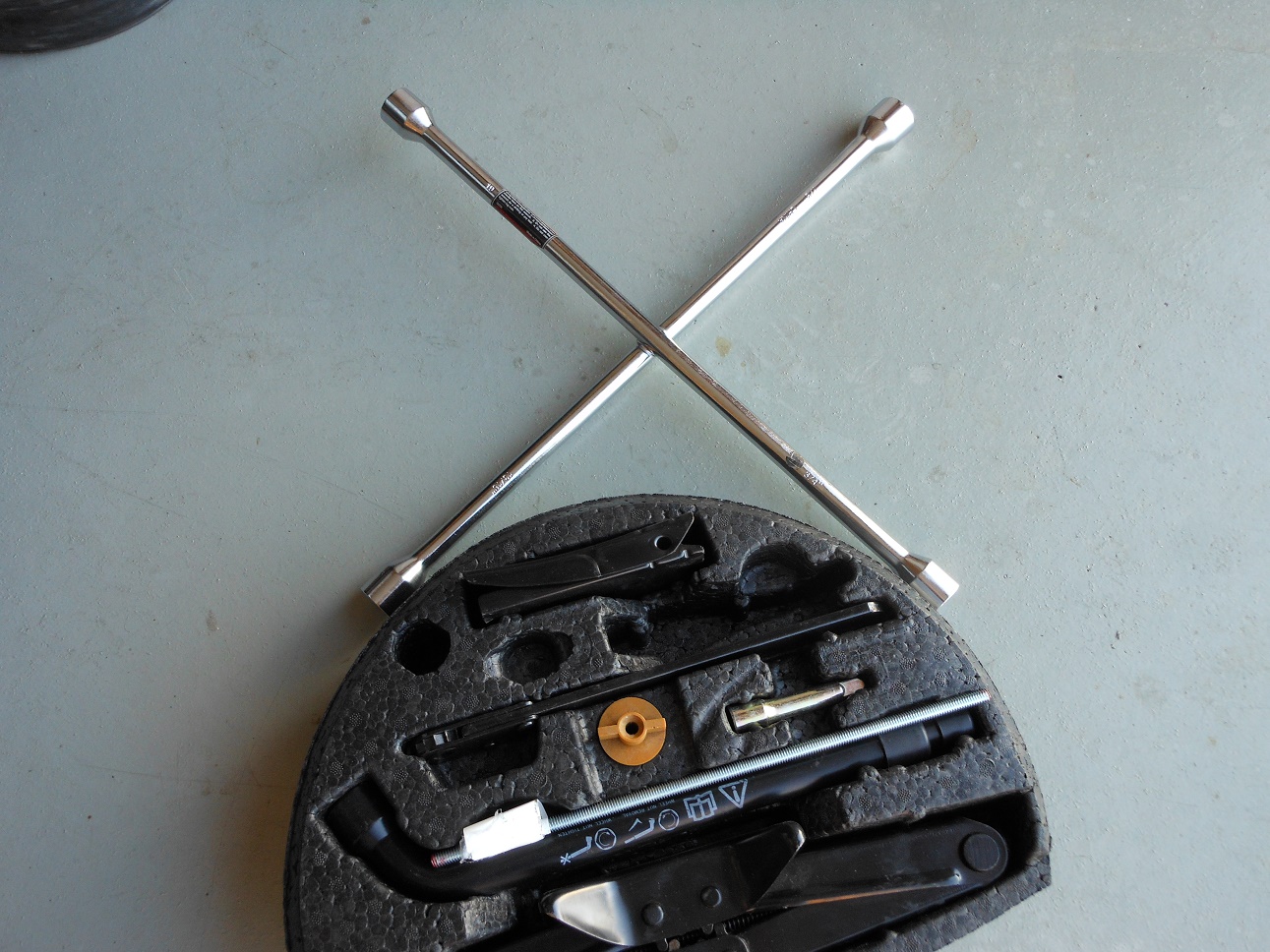

I have attached photos of my Jaguar spare tire used on my 2009 XKR Portfolio w/ the Alcon brakes for your review.
You will also need to order a 7mm spacer for the wheel to fit over the Alcon brake caliper. Without the spacer the spare wheel will rub against the caliper. You can order at Motorsports Tech as they specialize in the making the spacer. The spacer is hub centric. 7mm ....5x108 Bolt pattern.... 63.4mm centerbore... milled aluminum.
Cost is about $40-50.00 USD, they are located in Nevada. Here's their link to make it easy for you.
Wheel Adapters, Wheel Spacers, Hub Rings, and much more! | Motorsport Tech
You will also need to buy the tool kit or jack. I also carry a 4 way lug wrench.
This info should help. These spare tire/wheels are very hard to find. I had mine shipped from the UK, bought the tool kit off eBay from an earlier MY Jaguar. I still carry a tire plug kit and a low priced compact air compressor that uses the 12V outlet.

Richzak failed to mention that there are 2 different compact spare wheels for late model Jaguars. One is red and the other is black. You want the 19" black one, as he indicated, since the red one won't fit. See my post #41 in the above referenced thread. My black spare came off a parted-out wrecked 2011 XJ Supersport in the UK. Again, thanks to Brutal for pointing me in the right direction.
Richzak also mentioned that he keeps a 4-way lug wrench in his trunk. I think that wrench is heavy, takes up too much space, is unnecessary, and won't properly tighten the nuts. In his post #1, he has pictures of all the components but there is no picture of how they all fit in his trunk. I doubt that all of them fit in the spare wheel well. Instead of a bulky 4-way, I recommend that you buy a torque wrench from Harbor Freight for $9.99 to keep in your trunk. The lug nuts should be torqued to 92 lb.-ft. See my post #28 in the above referenced thread. Since I already had several sockets that fit, I didn't need to buy a new one to keep on that torque wrench. Also, be sure to loosen the torque when the wrench is not in use.
Here's the compact spare, torque wrench in its hard plastic case (upper left corner), OEM 12v inflator kit as supplied by the factory with Alcon brake equipped XKRs (lower left corner), and OEM tool kit in the foam tray as installed in my trunk: The lid closes perfectly flat.
