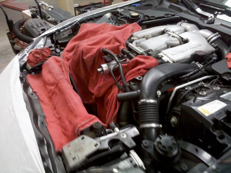

I have installed smaller upper pulleys on the 5 ltr cars with a noticable increase in the midrange. Sorry no dyno numbers. I sent the blower out & had the nose machined & a smaller pulley installed. I have seen photos of superchargers that have been ground down on the car. I would not recomend that at all. I will refrain from comments as to how it looks & be polite. Here is a link to the company who upgraded the supercharger.

I would very much like to see photos of the supercharger & know how they were able to machine the nose on the car. The only photo I have ever seen of someone doing it on the car was awful, they use a hand die grinder. If there is a setup available to machine the nose on the car I would like to buy it. Please post photos. I have also used Mike's pulleys & found them to be of very high quality. What year is your car?
I don't know how to post pics in replies here. I can send them to you via e-mail, or I can send you the whole article about the upgrades to my car, explaining the plan and the implementation process. This is my first encounter with a forum so still learning how things work.

The guy that did the work is a very experienced performance car mechanic at Concours Cars in Colorado Springs. He actually fabricated his own tool to reduce the nosepiece while the S/C was on the car. He did it using the old pulley which he had just removed. My car is a 2007 XKR Convert. My guess is that you could also build one yourself. It's fairly labor intensive and the main reason he did it that way were the time constraints and the fact their regular machinist was out of town. I watched him do it and I consider him an automotive genius.

Here are some pics of the S/C nosepiece being reduced with S/C on the car. I finally figured this out I think. Hope this works
