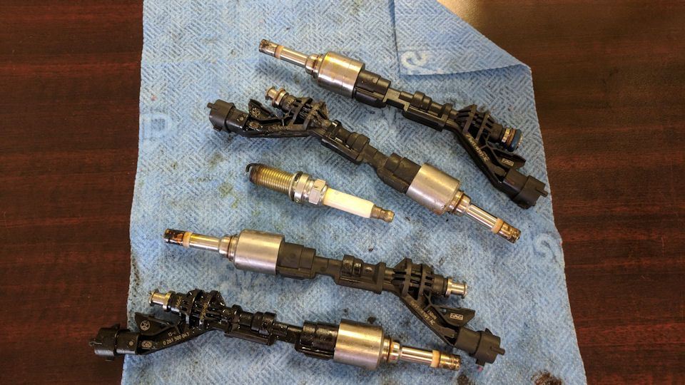

Yeah, me too. Since it was in the shop, I had 'em do a plug swap, and since THERE, a compression check. Well, the plugs were nasty and ONE plug on the misfire side was absolutely coated with raw fuel......... like an injector got stuck open.
The parts have been ordered and will be installed on Monday.
Again, since it was there and I no longer have a lift, I will have them drop the tranny pan and refill the fluid, since I already bought that stuff about six months ago and it's been sitting waiting for me to FIND a lift.
So anyway, So Far the only problem was the one injector and the nasty plugs.

The #4 injector was the bad one, and had all four on the left changed along with all eight plugs. I had SUCH fun driving it home!

Remove and check left four injectors - one check bad, others "ok"
Replace four left injectors

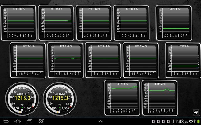

So what does THIS STUFF actually mean???
Current Fuel Trims per cylinder, Long Term per bank and Short Term per bank.....

By the way do we assume you saved the injectors and will get them cleaned and tested. Would be interesting to see the spray pattern before and after.
I told the tech I did want them, but when they were put in front of me I lost all interest. I have WAY too many projects going on now, and since I'm a physical wreck right now I can't even make a dent it those ones. I don't need another right now.

Possible vacuum leak with high STFTs. Check the fuel trims at idle then increase to 2500 rpm and note what happens. If the STFTs come down towards zero, there is a possible vacuum leak.
I thought about that, but I also had/have a "Rich Condition Bank 1 & Bank 2". Figured it'd be Lean with a Vacuum leak. Beats me, man.
I did do the off-idle thing and they did drop. If I remember right, the Long Terms went up at the same time.
Grrrrr........... the shop may have missed a line or something. Bah.

In case something had to relearn parameters or some such weirdness, I did charge up the battery then did a hard reset.
I'm about to take it for a spin again, and keep an eye on those trims AND the vacuum readings.
You need to get them and keep them should you need another- or sell them on here for someone who may just be looking for one.
Looks like you are going back to the shop anyway.
FWIW I read the BMW guys being able to clean them up after soaking for several days

I went for a good ride after the Hard Reset, and everything went perfect! The long term fuel trims went to zero, and the short term were barely negative and stayed pretty much there forever, bar acceleration and such. Zero DTCs and Such Fun! The last half of the trip was in Rush Hour so I didn't get to play at all, but still a good ride.
