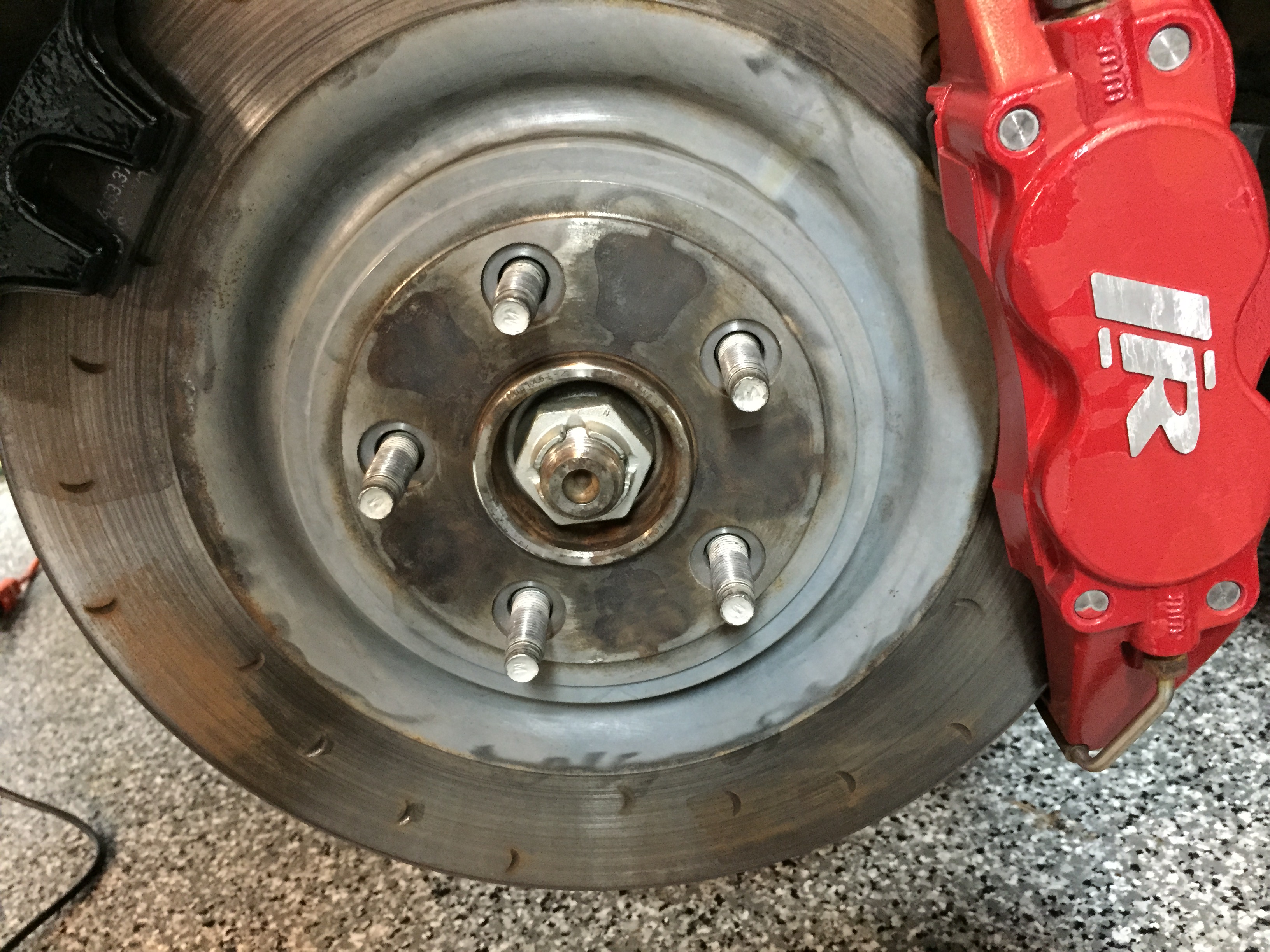

Was detailing me "Jag-u-ar" and came across this ugly rotor.
I have a few ideas, but, what have you guys done to "pretty it up"?
That is, that rusty rotor.....

It appears to be an aftermarket rotor, so replacing it with one that is of higher quality, or removing the rotor and painting the 'hat' part with a paint for high temperature applications may be the best ways.

Really, aftermarket?
Wouldn't think a car with 42K miles and serviced by only by Jag dealers would show up with aftermarket, especially with vented rotors.
But, agree a little cleaning then, perhaps, a high heat caliper paint might Pretty them" a bit.

That rotor is NOT aftermarket, and IS the highest quality. It is easily identifiable by the unique crescent-shape slots as an OEM Alcon rotor that was standard equipment as part of the Portfolio package for 2008. The Alcon performance brake package included 400mm front rotors with 6-piston calipers and 350mm rear rotors with 4-piston calipers. They were the largest brakes ever fitted on a production Jaguar (at least through 2009, as far as I know).

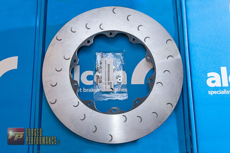

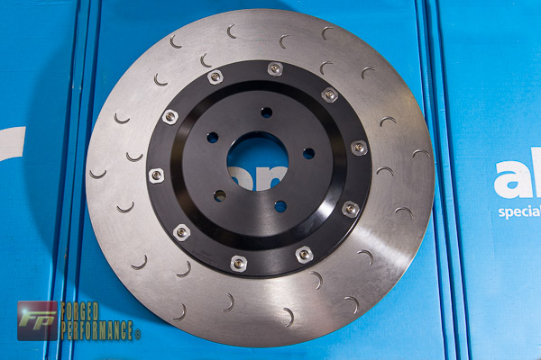

I'm having the same dilemma with my Alcons, just starting to haze some on the fronts. You could tape off nicely and paint or you can do as I plan.
I'm working on locating some 400mm and 350mm floating disks. I then plan to machine the center hats for them. I've talking with performance friction and a few others and can't find the center hats for a floating disk setup.
I spoke with Alcon and they have a 400mm floating rotor that fits but no hat. Forged Performance in Marietta Ga supplies the Alcon 400mm rotors for the GTR. Certainly not cheap but an option to never worry about fading with anodized centers. This is on my to-do list with many other projects. Just need to get the measurements off the rotors.
Appearing with an anodized hat
Attached Thumbnails Ugly rotors....-dsc_3736-2.jpg   Ugly rotors....-dsc_7425-3.jpg

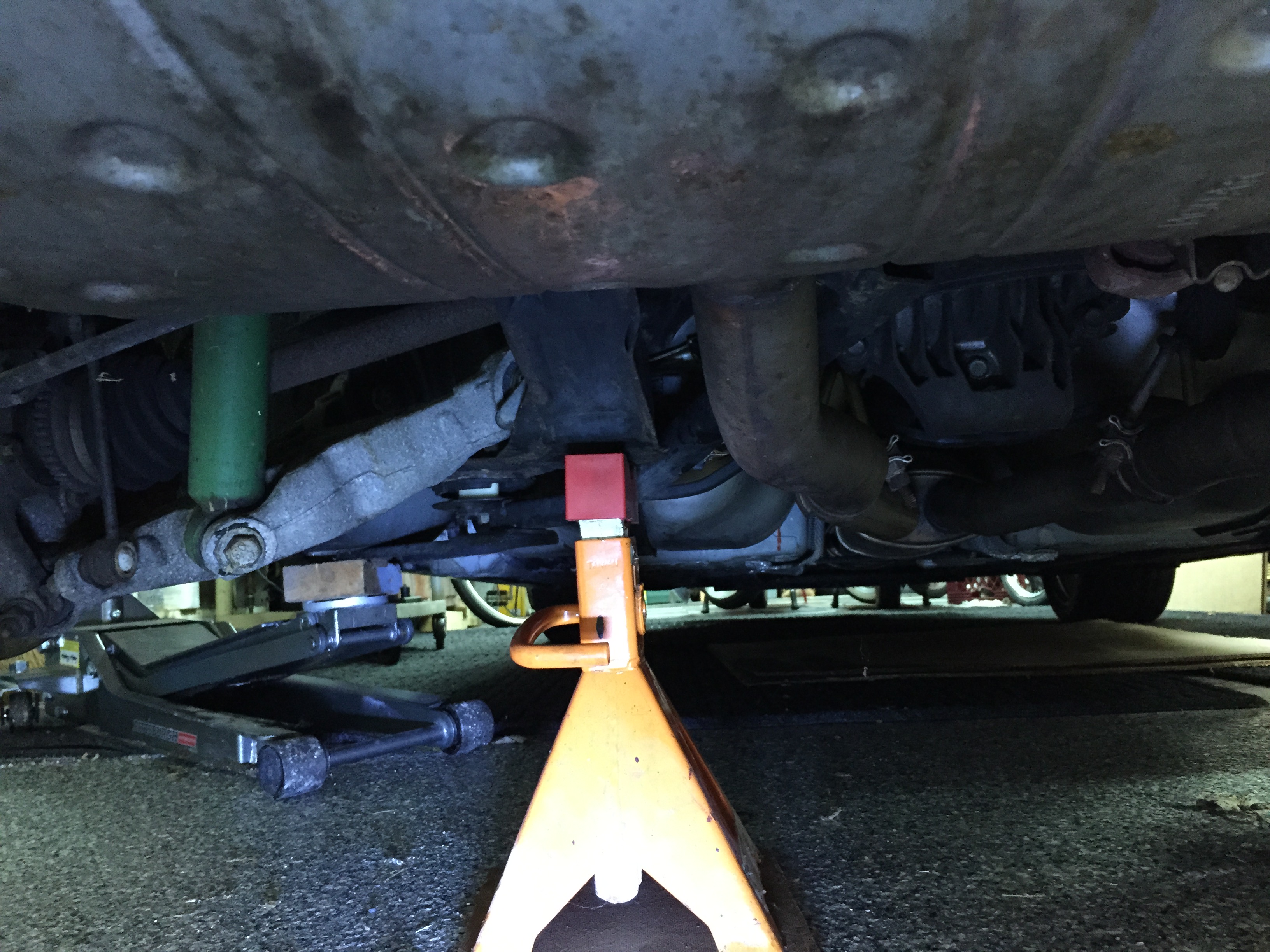

Rear off the floor, wheels removed, here's what I see. First, am able to rotate the hubs using a sturdy wood tool (Thanks, to a non-LSD rear).
The surfaces aren't all that bad. Have been using a small wire brush and my Dremel to remove the bad stuff. Wiped it clean using Ultra Clean product (paint prep product). Now, have to wait for the humidity to go down. Been rainy (off/on) for weeks. Supposed to be thunder boomers today and the rest of the week.

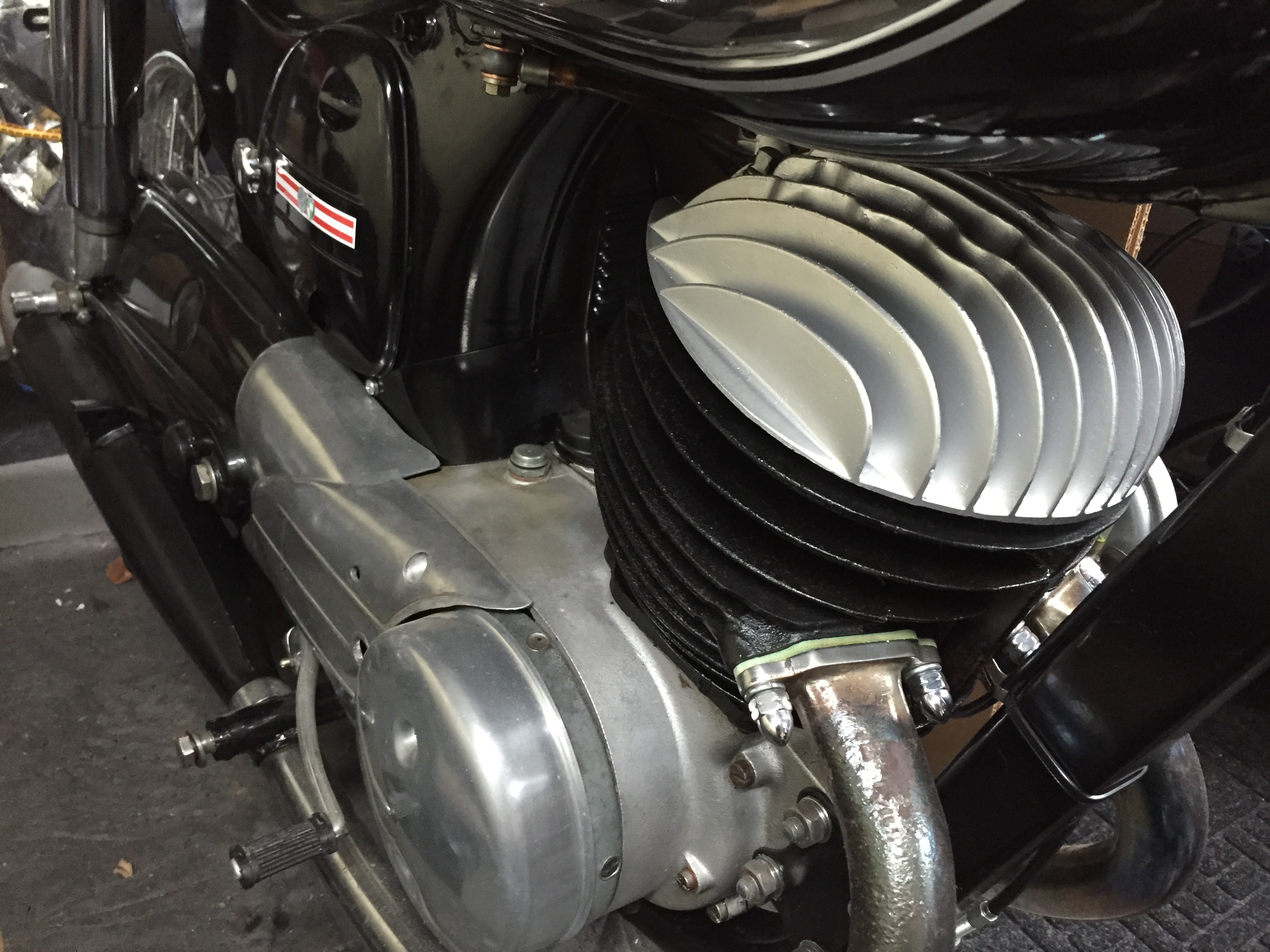

Actually, thought about removing rotors and having them powder coated. Process would be way cheaper. Many colors, from which, to choose. But, would take the girl off the road for a couple weeks. Seriously, look into powder coating as there high-temp formulas available. Had the head on my vintage motor cycle and exhaust system parts coated.
