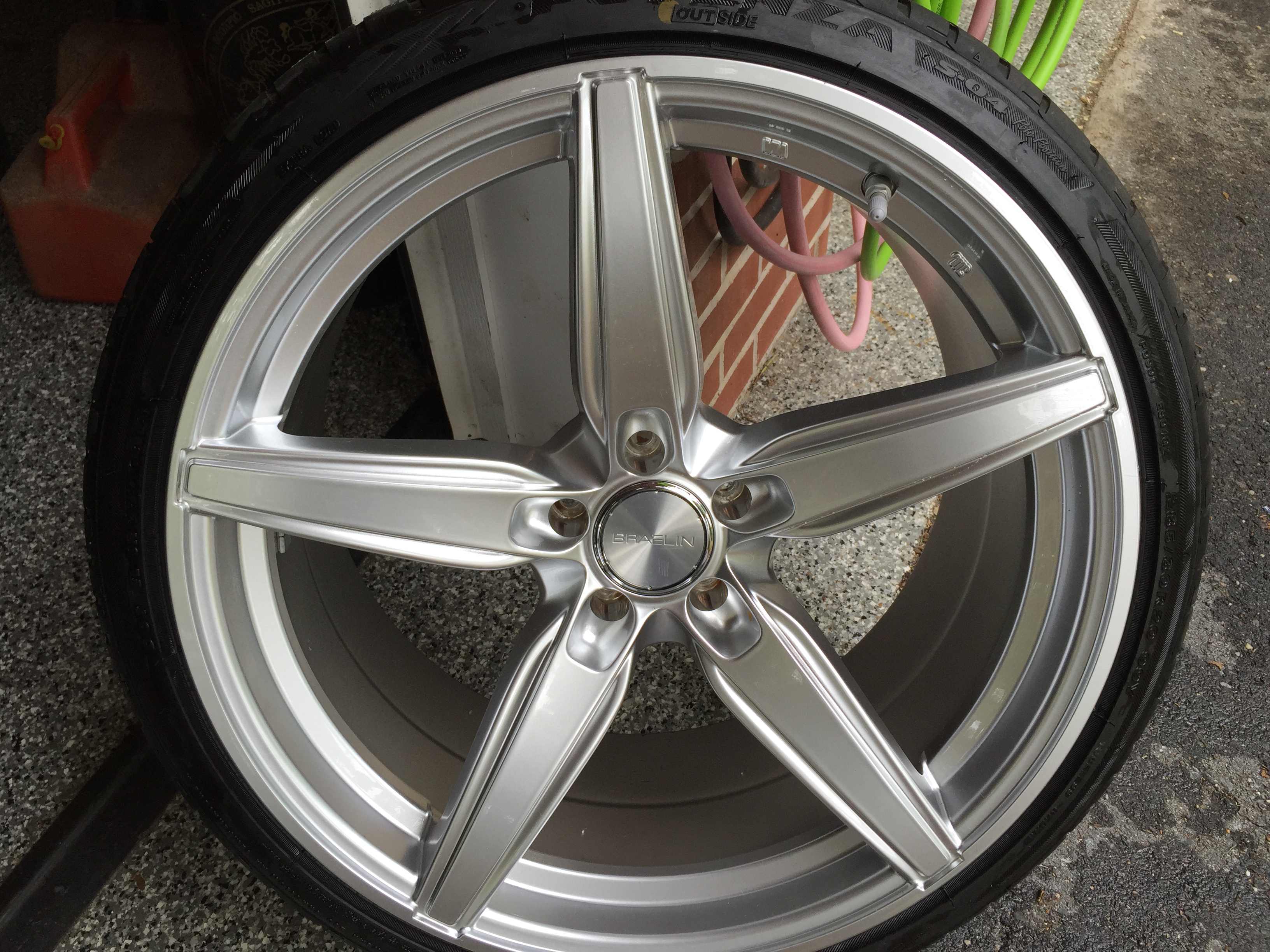

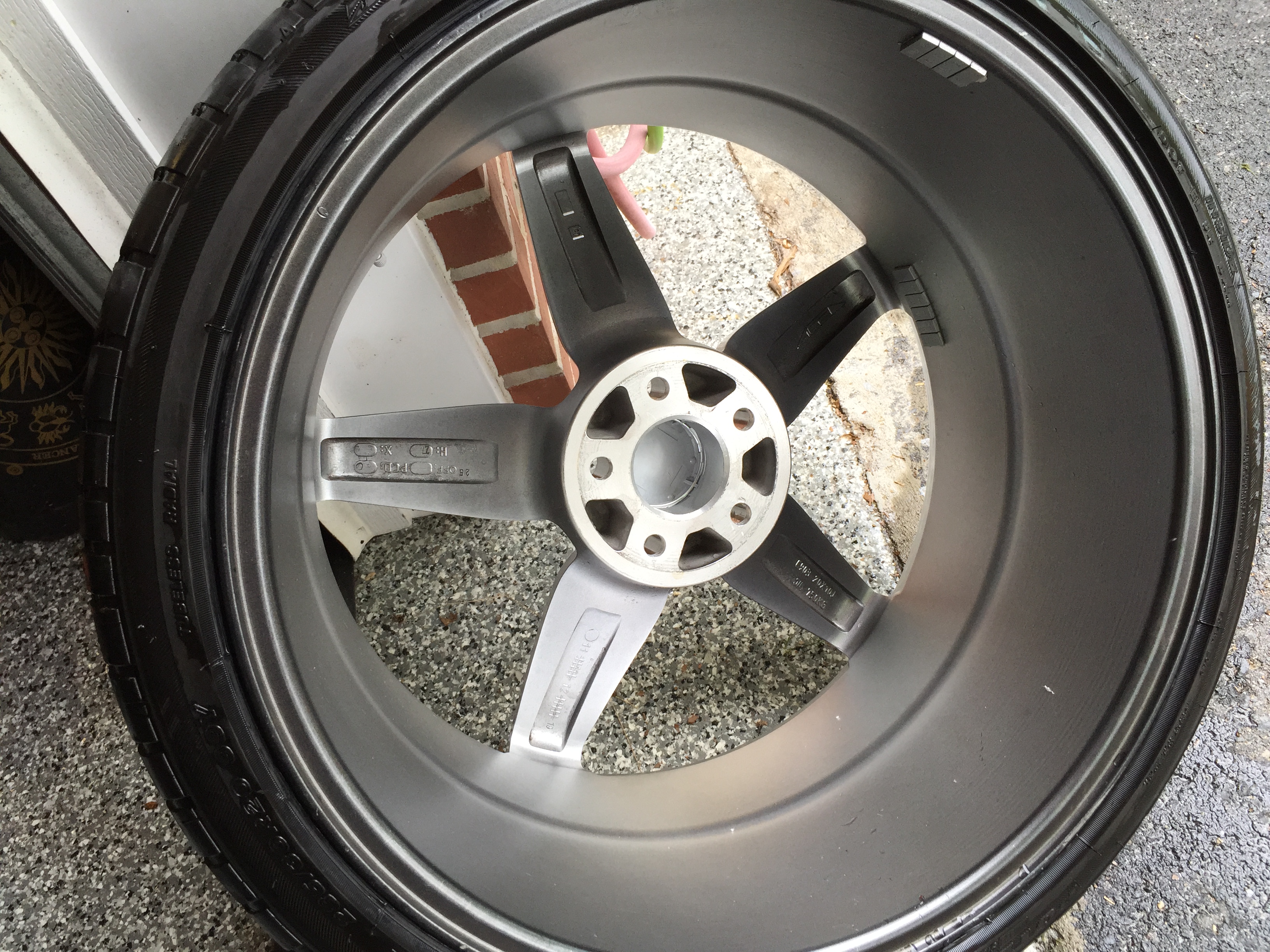

This is a good time to scrub the wheels too.
