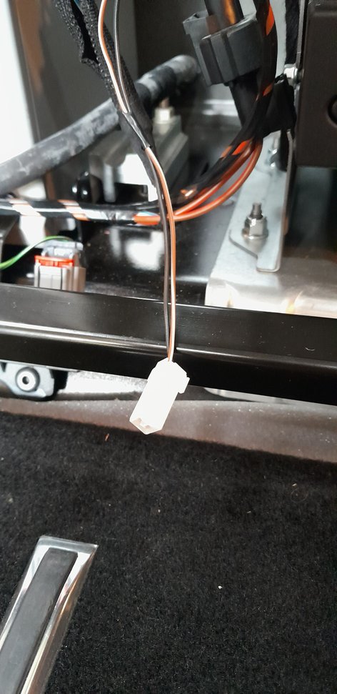

Hello
I have recently taken delivery of my 2009 XKR and decided to change the battery as it was around 6.5 years old.
The battery change went just fine, but there was one lead that wasn't connected to anything. Before changing the battery I had taken the precaution of taking some photos and it appeared to already be there, unconnected. I've attached a clearer photo.
The question is, of course, should it be connected and to what? Or else what's it for?
Many thanks
Tony
Unconnected lead 1

That white connector is used only when transporting the car from the factory to the dealer.
Wires from that white plug connect to a relay behind the rear seats which, when activated with a power source connected to the plug, disconnects the main battery from certain functions to allow transportation from the factory to the dealer. The dealer removes the power pack as part of the Pre Delivery Inspection and leaves the plug.

Thank you both so much for your speedy replies. So nothing to worry about then!
What a wonderful forum this is !!!
Thanks again
Tony
