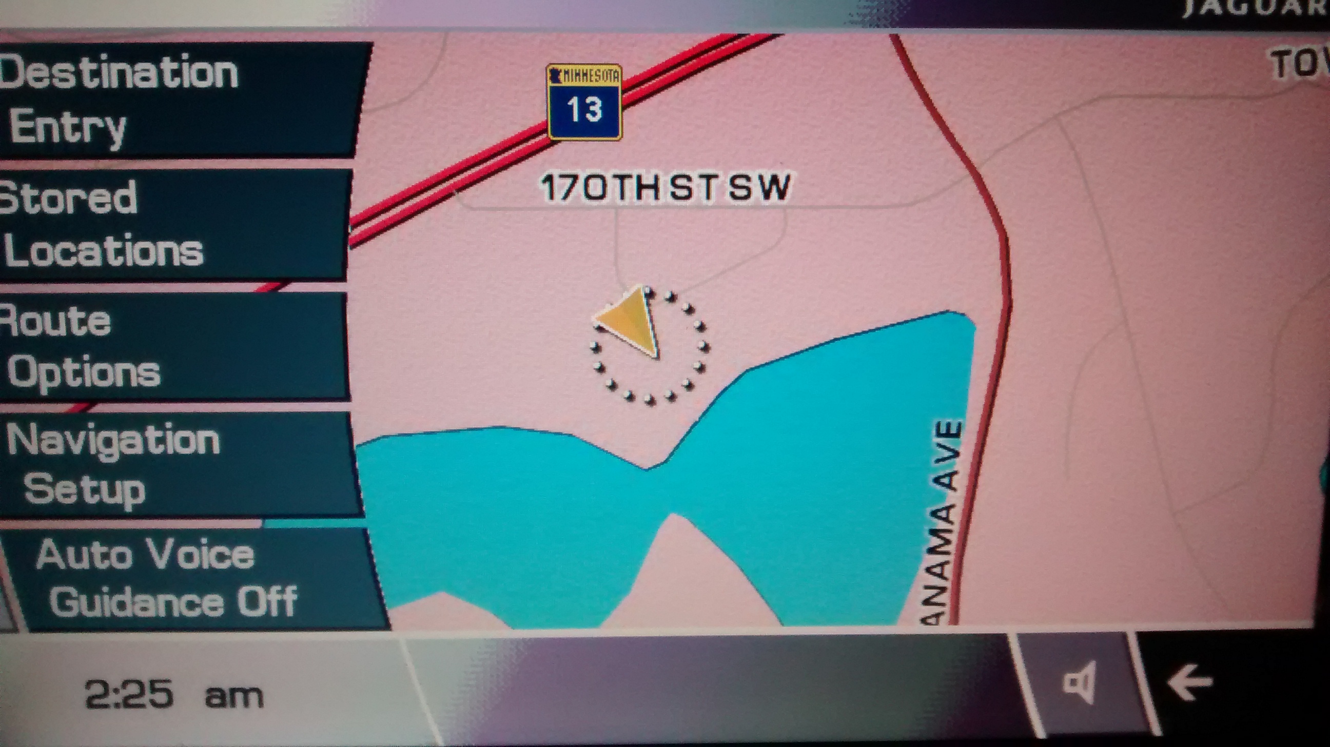

hey guys. I'll do a write up on this shortly but I've installed GVIF. I haven't connected a back up camera yet and may not.
Instead of the HKS Camp 2, I'm using an android media box with Torque Pro. It's similar to HKS Camp 2 but as you know, it connects via bluetooth, then output is HDMI to RCA.
Here's my issue and I'm hoping you have some ideas.
I have a slight flickering and a pinkish hue.
I don't have this issue with the box when it's in the house connected to a monitor. It picks up the BT signs fine and the output is great.
Once I plug it into the GVIF box, I get the problem. They're minor but annoying. Here are a couple of pics. I'd appreciate any input.
Notice the pink on the map and the distorted colors on the gauge background.
I did a GVIF factory reset and attempted to adjust the GVIF color, hue , saturation etc..
The flickering coincides with my voltage fluctuations and my idle is hunting a bit since doing a hard reset on the battery. SO I'm getting interference. Just not sure how to isolate it and eliminate it.

I have since removed the bluetooth dongle and the media box, so now only the GVIF is connected between the nav box and the touch screen.
repeated the factory reset and still have the same problem.
switch 123 are down, the rest are up

My issue is in the GVIF itself, most likely the connections not fitting quite right or altogether loose. That will result in a ping NAV screen.
I'm wondering, will dielectric grease improve the connection or harm it?

Maybe have someone watch the screen while you climb into the trunk and wiggle the connectors and wires into the connectors, to see if any change can be seen. Might be able to locate the issue that way, or at least rule them out.
Thanks kj, I was able to find it. Image is fine now. It was the connection at the touchscreen.
Fantastic! But how did your touchscreen connection get loose?
I've had the touchscreen laying in place while working on Cambo's solution to implement reverse camera via Fakra connection.
I have two different touch screens with different year OS in each. I think continually swapping them out caused the problem.
