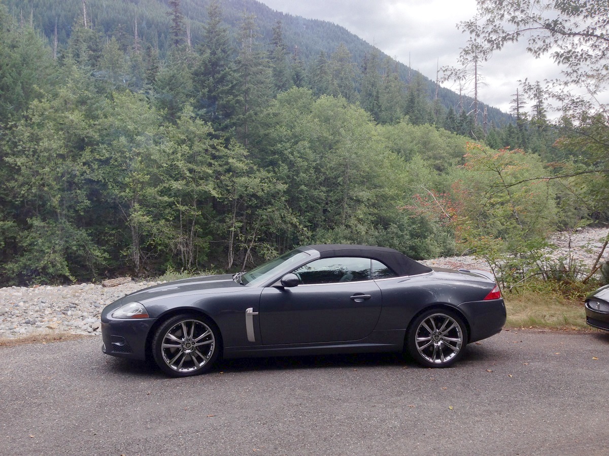

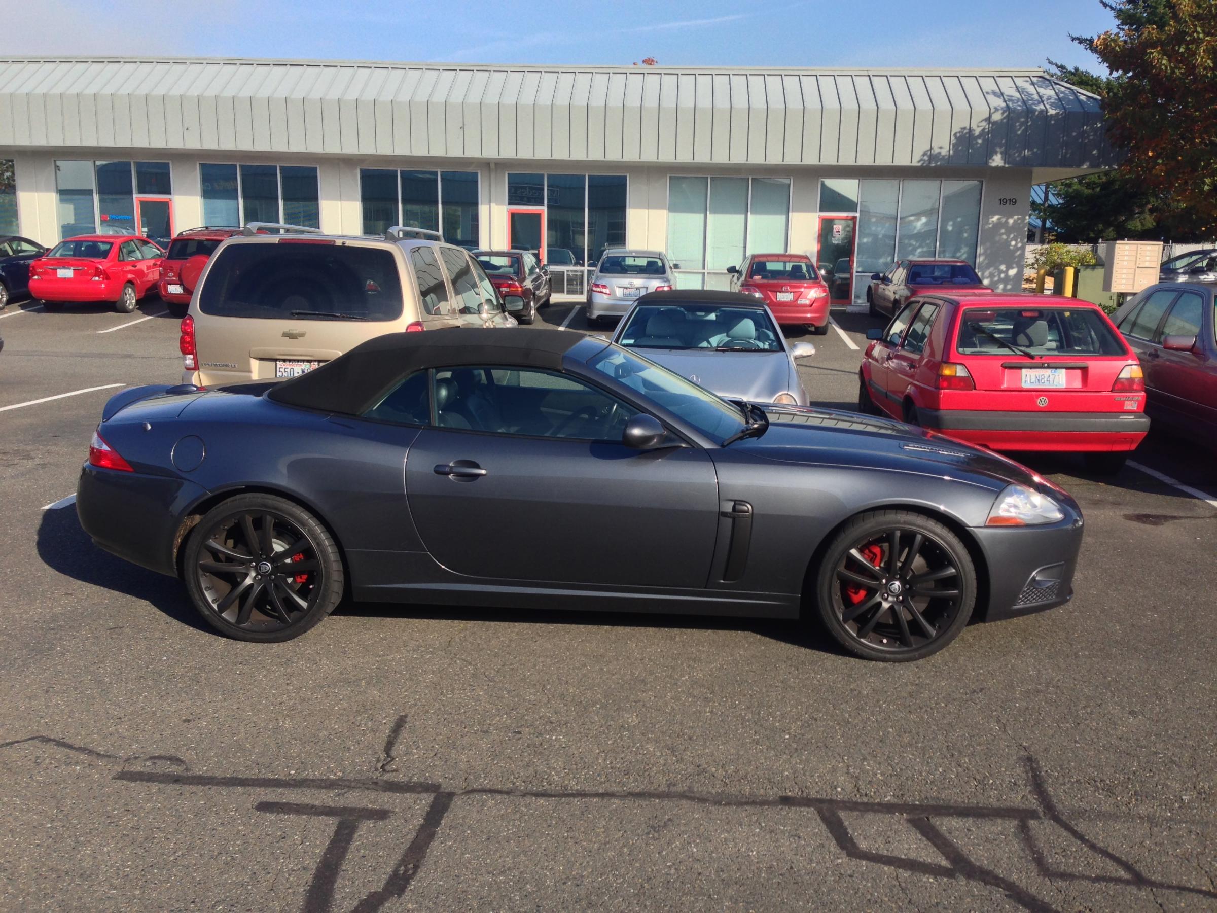

Use case:
My XKR wheels are 20" Sentas in chrome. The chrome look I was never sure about from day one, but new wheels would cost a fortune and I wasn't sure what color/type I wanted to go.
Then I heard of plastidip, and thought I might be able to use that to test painting (or "dipping") my wheels black. Well, that's exactly what I did, and once I was done, I added the trim around my windows (which were also chrome). Lastly, I changed my silver back plate (reading Jaguar) into a gray.
Forgot: I also dipped the plastic right under the windshield, it always fades over time from the sun and washing fluid, looks like new now.
So, I got to:
- Try out a new look
- Protect my chrome wheels/trim
For 6 bucks per can (I needed about 7 for all the work described), a very cost-effective way to test out things, or protect your car. They even have a clear version that some use for chip protection. Plus, I can just remove it if I get tired of it.
Take a look at some pics: The first two are with chrome wheels/trim/back, the others show now blacked-out version using plastidip (wheels, trim, back in gray):

Looks great on your grey car. I like it. I thought about doing it on my 2013 black coupe, but I like the contrast of the polished wheels and chrome trim.

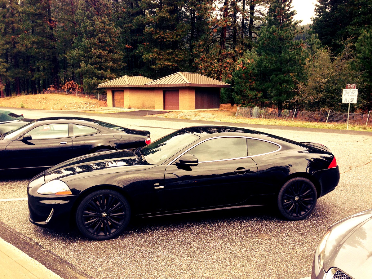

Thanks!
A friend and forum member "Muddydog" has the black coupe (2010) as well. We dipped his wheels (just to try it out), and it looks awesome. We haven't done the trim yet, but I think that would look even cooler. I just love that you can try it out without risks. It's like a non-permanent tattoo.
Here's a pic of Muddy's coupe from one of our drives:
