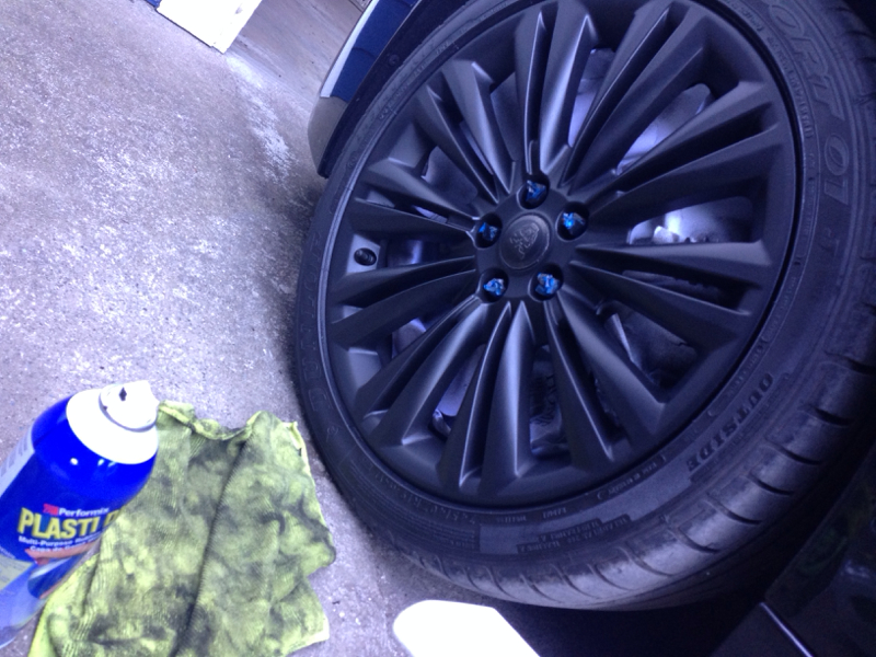

Update: Almost one year on and I got my first tearing of the plastidip on my wheels. Should be easy to touch up since I'll just have to spray the areas that tore loose. The surface underneath looks as good as the day I put the stuff on. While I'm touching it up I think I'll add the glossifier this time.
It only tore because I put some tire-shine petroleum-based stuff to make it look wet, which I've done before, but this time I rubbed it with a cloth. Just like the bug-and-tar remover it started to come right off. Oh well, easy fix.
The important thing to note is that road and weather wear did NOT damage the plastidip at all over the past year. Only me.

Touching up my rims tonight. I plan on using glossifier to see if I can hold onto a bit of shine.
