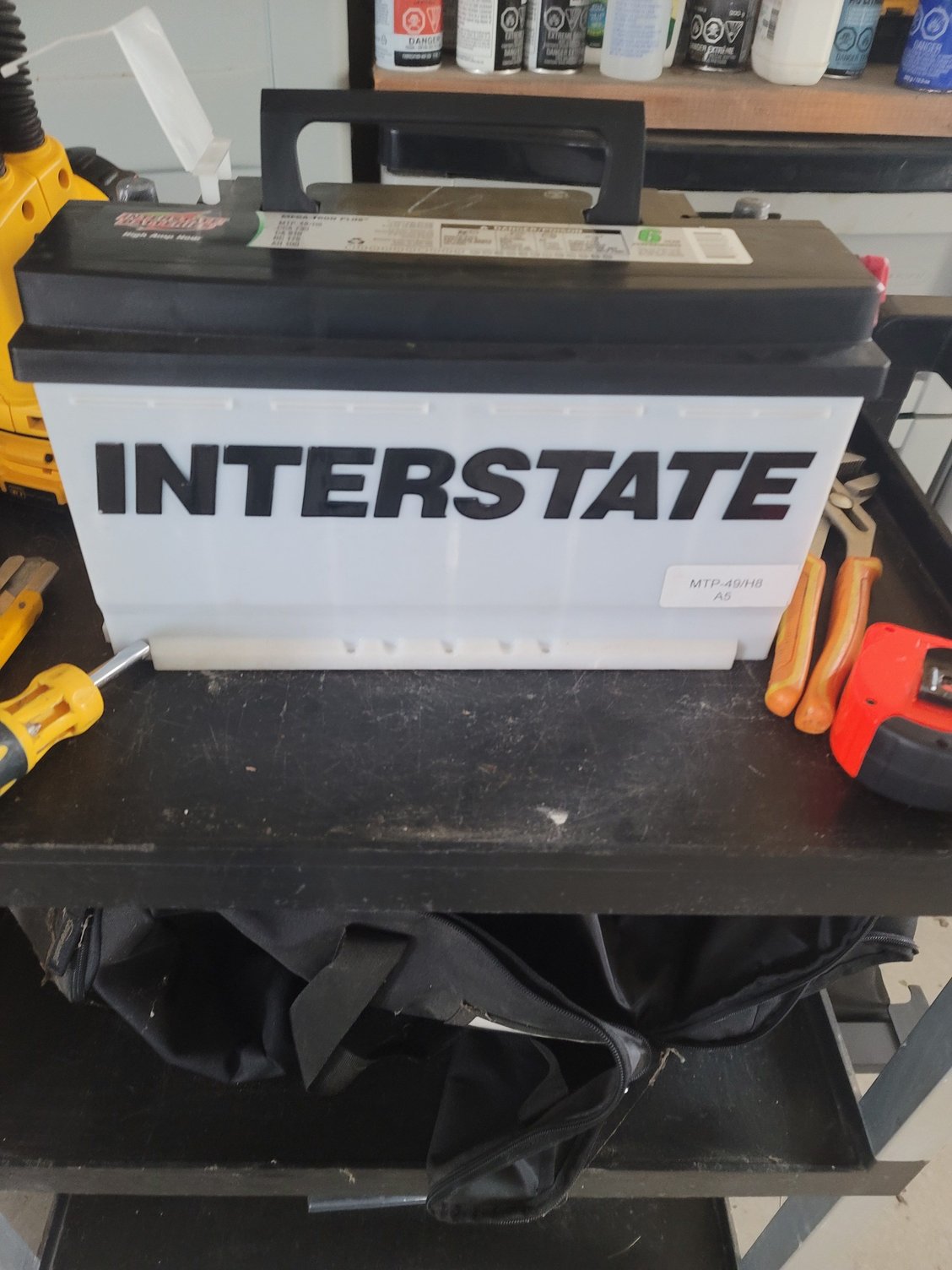

Pulled my battery today. It is dated A5 which translates to January 2015. It's an Interstate ba3.
So it is 6 years old. Could this be why by volts only show 12.2 to 13.4--normally 12. 4? The battery tested out fine.

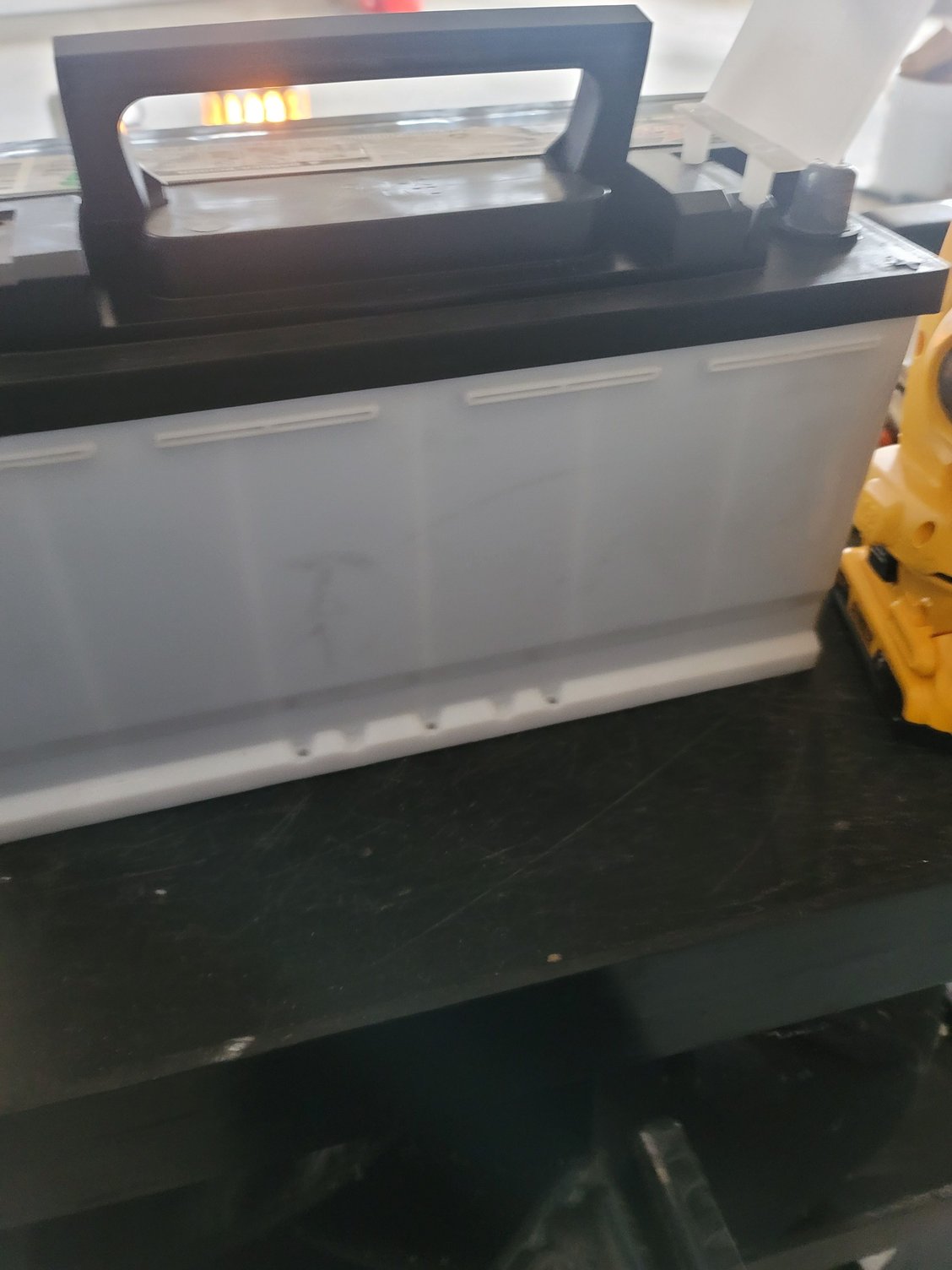

The new AGM Interstate battery is in my garage being charged. When I picked up the battery and returned the old standard flooded battery the sales rep noticed the side had a slight bulge, most likely caused by freezing from the previous owner. Although, the old battery performed perfectly well causing no problems, a 6 year old battery is due be swapped out. I hope the AGM battery works out well. I called my dealer and they tell me the BMS needs to be reset. I'm wondering if my Autel AP200 OBD2 scanner will suffice to do the job. I've used the Autel AP200 to put the EPB in service mode before taking the battery out to replace my brake pads and I could hear the rear EPB motor working. However, the Autel AP200 also comes with the option for BMS. I'm not sure if it just resets itself or reprograms it for either a standard battery or AGM battery. Since I'm changing to an AGM type battery do I need to have the BMS reprogrammed or is a simple reset sufficient? I don't have a battery currently in the car and will not install the new battery until I complete replacing the rear brake pads with ceramic pads, which should arrive Tuesday, so I can't try the Autel AP200 tool to see if there is an option to set the battery as AGM or flooded.

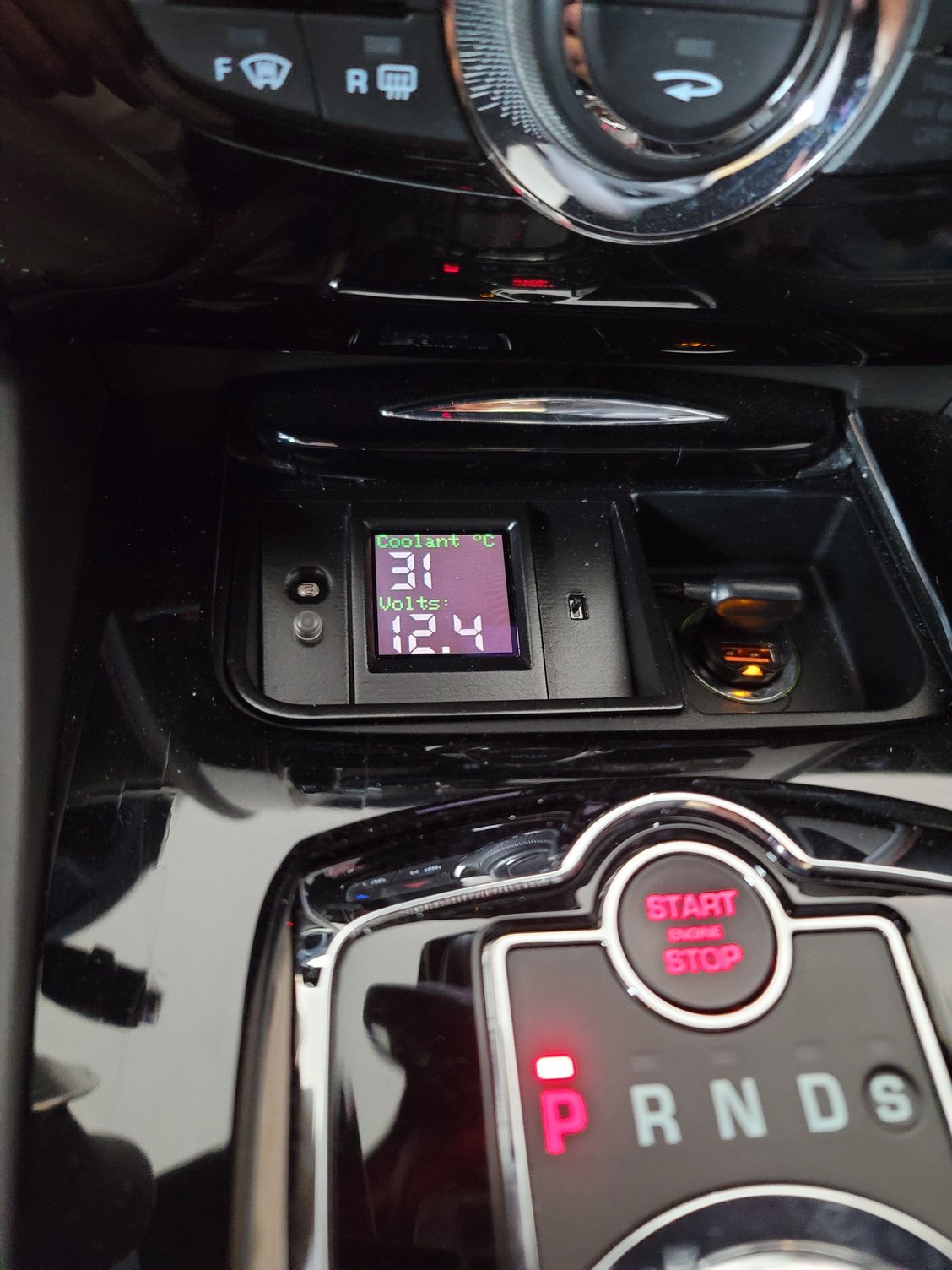

After installing the new AGM battery over the winter I've had the opportunity to have the car out several times. I reset the BMS with my Autel Ap200 and over the last month have not put the battery on a maintainer. I understand after reseting the BMS the BMS allows the battery to be safely depleted before charging to adjust to the new battery. The car works absolutely perfect, like new.
I observed the ADU voltage meter shows 13 to 13.4 when I take my foot off the accelerator. As soon as I slightly press the accelerator it shows 12.2 to 12.4. The ADU will also display 13.2 to 13.4 on over 3.5K acceleration. At rest the ADU displays around 12.4. Just thought I would mention this.
You have a problem! My ADU shows 14.4 as soon as I start the car and stays there til I shut it off. Think your alternator is on it's way out.
