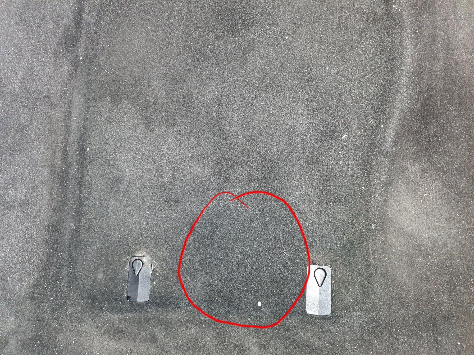

Already posted on Facebook, so I'll repost it here:
Ok, now I'm really confused. I left the car in garage for few days, until this wet stain drains out. And it did. Today I drove the car cca 20 km and when I parked at home, it was wet again, even soaked. No rain, dry weather. So it rules out water from outside and rain.
In front of driver's seat. See on the picture below. Under passenger carpet all is dry. Wtf!!?

If it's not coming from outside ... You just narrowed down the source to the heater or the hoses. I bet that the heat was on when you went for that drive. Did you check the level in the coolant overflow tank? I bet it's not full. Where do you think it went? Remember that liquid flows to the lowest point where it puddles.
It's not rocket science. Find the heater and you'll find the leak.

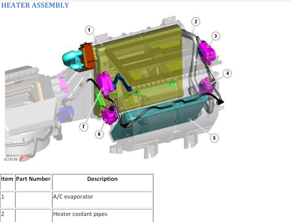

So what you trying ti say is that some of this pipes (n 2) are leaking. Am I right?
This picture is for RHD, this pipes look to driver's side which suports this theory.

Maybe. As I said, it's either the heater core itself or the hoses, or both, that's leaking. There's no other possible source after you eliminated rain intrusion.

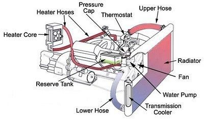

Here's a simple diagram of how your heater works. There are 3 components that can leak: (1) hose in; (2) heater core; and (3) hose out.
The heater core is inside the passenger compartment under the dashboard. It's a mini-radiator that gets hot as coolant from the radiator is circulated through the system. Get under the dash with a flashlight and look around for signs of leakage. See:https://bereadymn.com/how-does-a-car...r-system-work/
