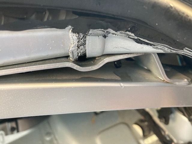

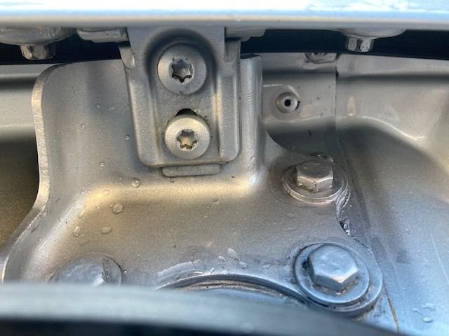

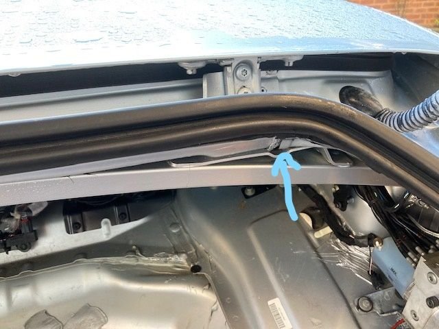

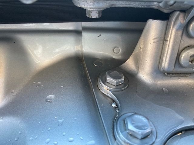

I have sourced the leak into the boot and it is coming from the rear deck hinge mounting bracket.
I have removed all the trim and discovered one of the previous owners has had this issue before and has tried to remedy the problem by running horrendous sealant all around the boot aperture under the boot seal. It also appears someone has tried, very badly, to solve the problem by putting sealant all around the bracket after removing the bracket, (this is an assumption as I have noticed the bracket/hinge plate is held in place with pop rivets on the right hand side as opposed to clenched rivets on the left hand side
( I think the wet seat belt issue may have been as a result of the rear quarter window being left down by me inadvertently as I have not had a re-occurrence of this problem even though I am still getting water into the boot.
I am not sure what is involved in removing the rear deck to access the hinge/bracket so if anyone has any tips they could share I would be most grateful.
clenched rivets on LH hinge mounting bracket
pop rivets on RH hinge mounting bracket
This is where the water is running into the boot although not identified source as yet
The u shaped channel is where the water is running into the boot from although not identified the source as yet
