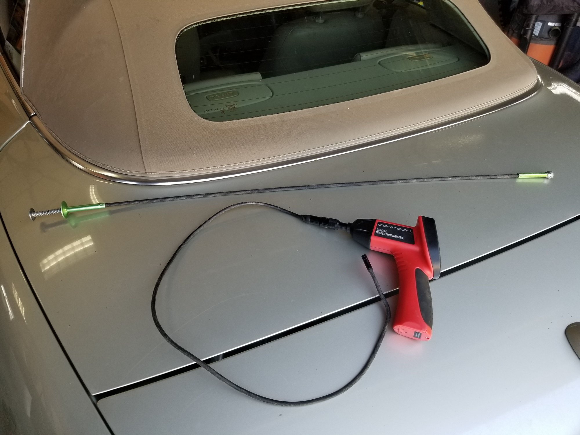

Passenger floor while running AC
Bore scope and flexible reacher tool I used to locate the duck bill drain and eventually blind bumped the duck bill a few times with my flexible teacher tool. After about 5 minutes of jabbing around I bumped the duck bill and all the water came gushing out. Quick periodic fix to the alternatives I've been reading about.
