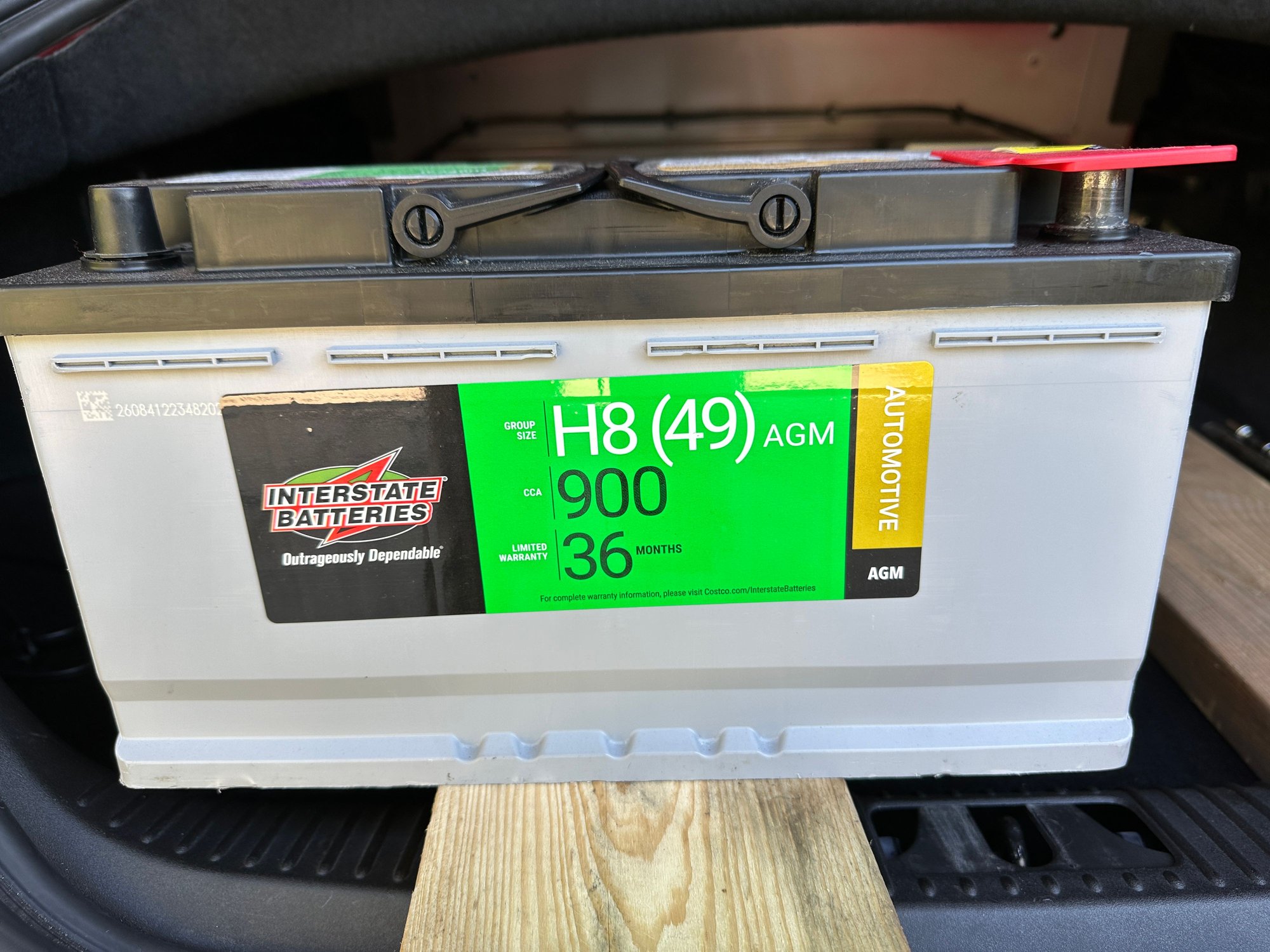

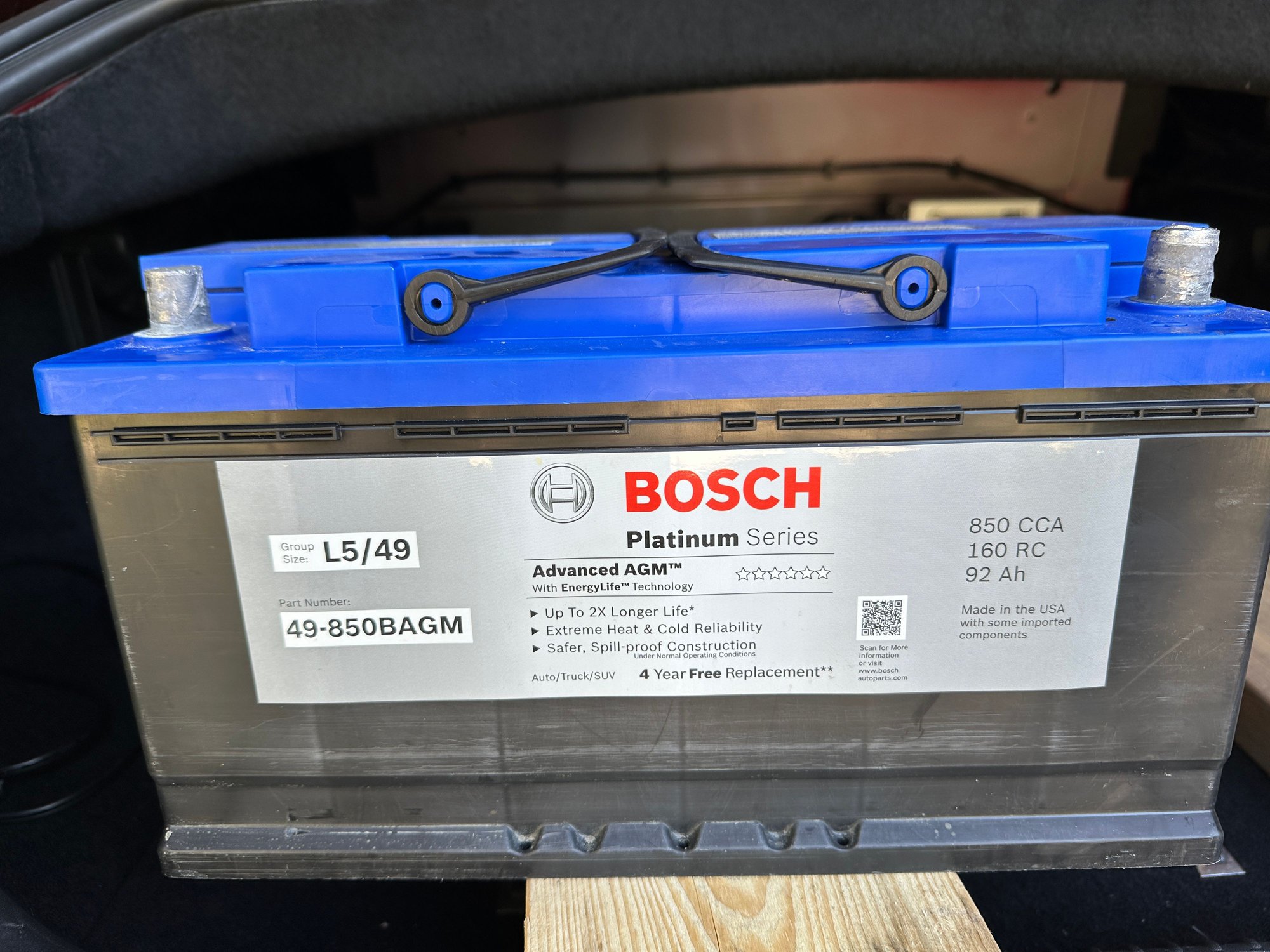

Just today I installed an Interstate AGM (from Costco). Easier job than I expected (using, as suggested, some lumber to make it easy to slide that sucker out). Fit just fine, replacing my 7 year old Bosch AGM (also Group 49 / H8).
New battery
Old battery

No problem fitting the forward bulkhead cover. The H8 size battery is about 1/2 inch taller than the specified T8 battery, but still plenty of room. What size battery do you have as it shouldn’t matter if it is AGM or flooded?
Make sure your battery is fully seated in the hold-down well as there are a couple brackets it can hang up on.
