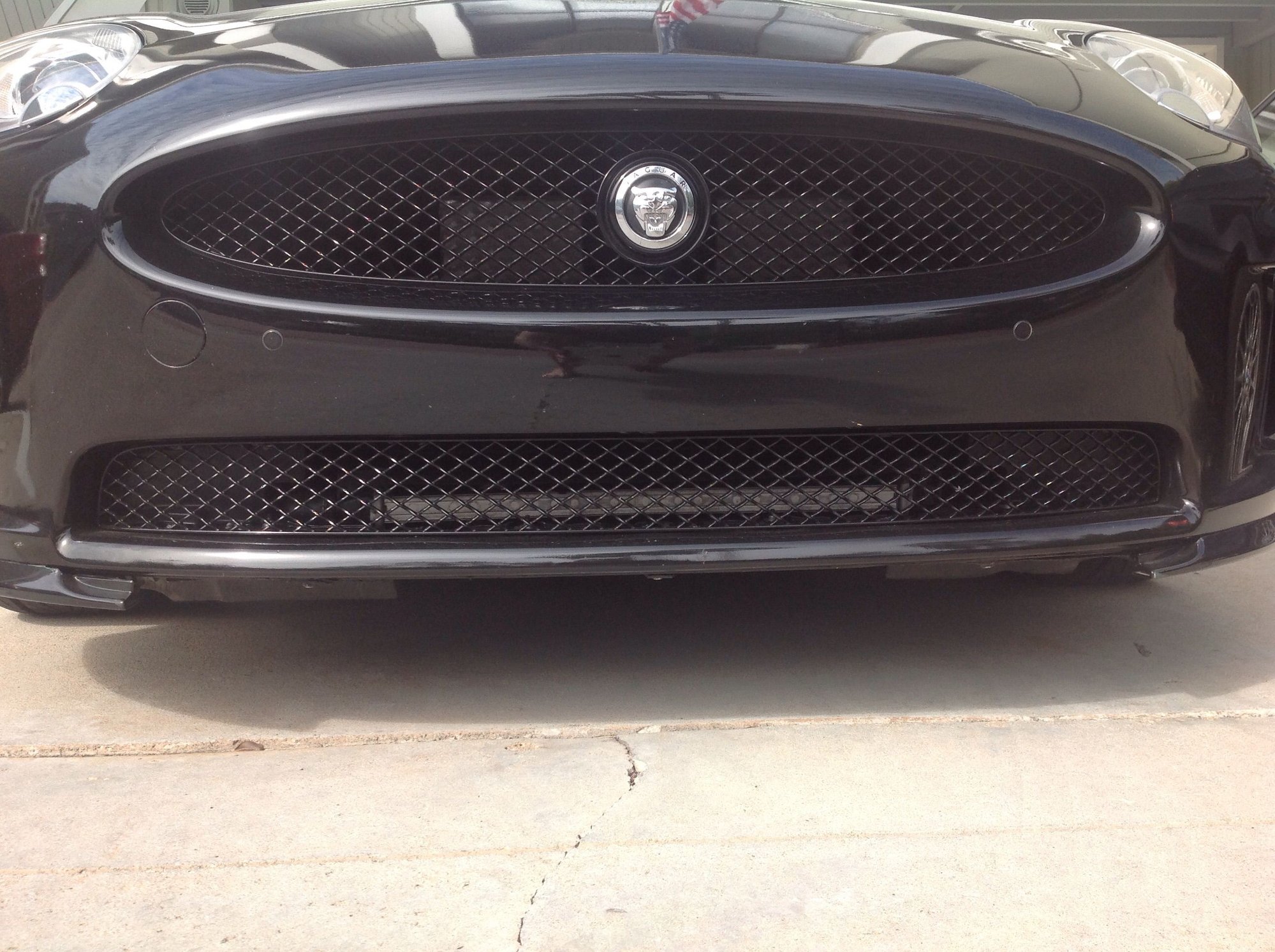

My car is missing a chunk in the front. I believe it came with a body kit from the factory, but the center piece appears to have been ripped off. I have tried to look for a part number, but I can only seem to locate the right and left pieces - not the piece that goes in the middle.
Incidentally, I thought it was part of the design since I see several other cars out there that look similar. It wasn't until I got the car up in the air that I could see a piece had been ripped off
Pictures below - see how what appears to be a chin spoiler only has a right and a left piece, and nothing in the middle?
Thanks,
Henrik
Old Feb 28, 2015 | 05:56 PM
NBCat's Avatar
Posts: 6,068
Likes: 2,983
The centre splitter part number for 2010 - 2011 vehicles is C2P20417XXX. For MY 2012 forward, the part number is C2P22276XXX.
As always, provide the VIN when ordering parts from a Jaguar agency.
