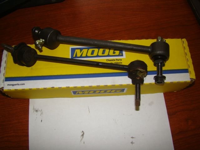

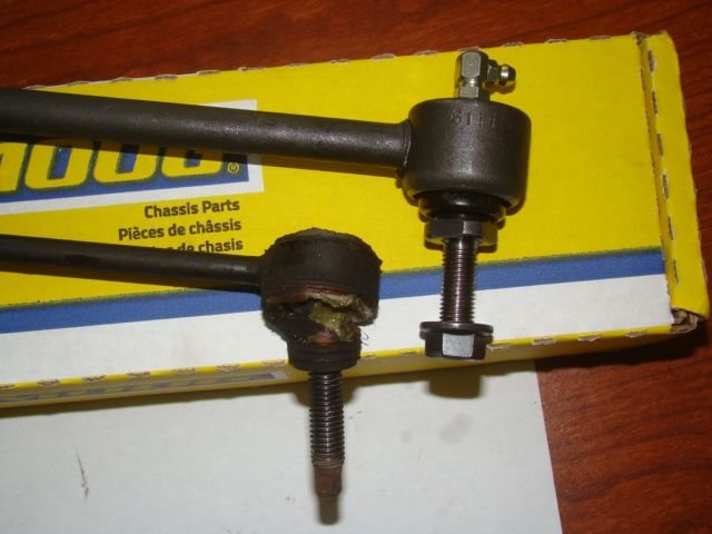

Hope photos help those that haven't done this R&R, but the OEM links are much thinner than replacements. These replacements are probably 4X stiffer/stronger. In addition, these MOOGs (and possibly others) have zerk fittings which allow the joints to be greased, just like the old days.
