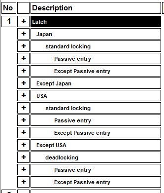

Judging by the parts manual, only Japan and the USA don't get deadlocking.

I think you're right that USA didn't get deadlocking (w/ ultrasonics as well) - often called double locking due to the double fob press. We must have worse thieves over here
