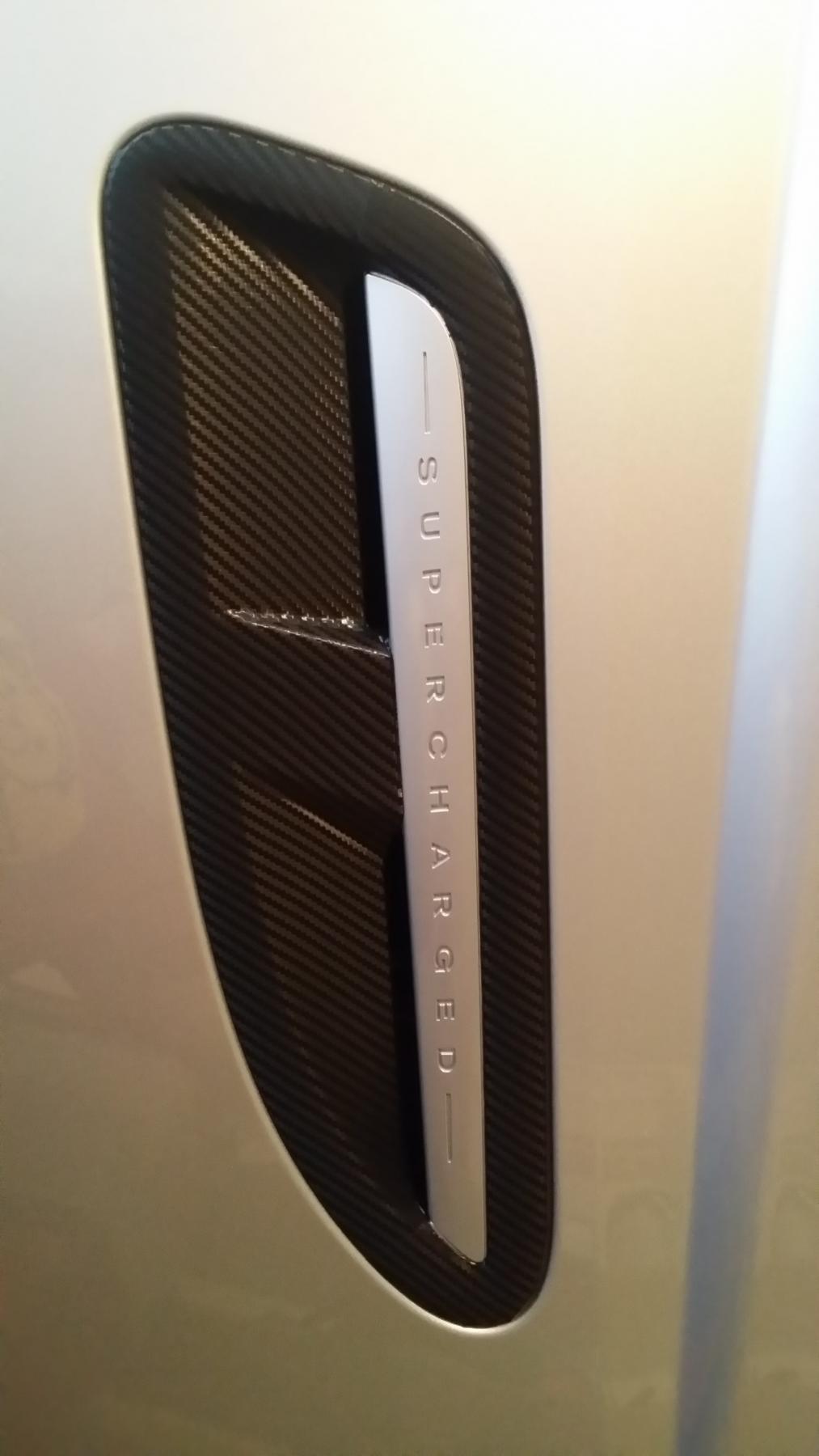

I have to confess to a serious case of wrap addiction. Having found that it is pretty much the one thing that my meagre skillset can actually achieve, I'll wrap just about anything. So I had leftover black carbonfibre wrap from my last assault on the interior, which I have been itching to put to good use. My wife suggested that she might come home to find that I had wrapped my old feller. She was only half joking.
But anyway my thoughts have wandered to getting carbon fibre bonnet vents. Strangely enough I hated them on the astons when they came out, but now I like them. But I dont like the price - it looks like something in the order of $900. For something with absolutely no purpose save cosmetic. It even occurred to me that they are probably heavier than the plastic stock vents. So I've done the next best thing - wrapped the existing. Now it is actually pretty hard which is why I'm posting, if anyone else wants to try. It is hard because you cant really do it in one piece, because the wrap wont stretch deep enough with the contours of the vent, it eventually tears or lifts.
So I did it in two pieces, first a piece that did everything up to the top "bar" (effectively above where the "supercharged" is) and with that you can essentially make it fit the depth contours that you couldnt otherwise if it was done in one piece. Second, I did the top bar, trying to match the lines of the cf as best I could. Ultimately I couldnt because the lines will never match given the bottom piece is distorted a little from fitting in the third dimension, bit I satisfied myself with the bottom one marrying up and the top not. By the way, gettiing the vents out is very easy. They have clips which you can press with a flat screwdriver, and it essentially pops out.
So here it is. I love it. Others might cringe, but horses for courses and I've never been a subtle person. I even like that the "supercharged" stayed silver (it would be hard to wrap with the writing). My wrapping desire is satisfied. My old feller is safe, for the time being.

Thanks! The hydrographic coat looks awesome. I dont think that I will be trying the mirrors any time soon because of the shape. The side vents are a chance, but what I am thinking about is doing the boot (trunk) finisher - the silver bit over the rear license plate. I might have to fill in the "jaguar" with some sort of putty but it would be pretty achievable. Then I could buy the cf leaper and pop it on above it.
tberg, I think our cars are twins!
Actually one thing that I will add as a tip for anyone doing this is to make sure that the lines on the cf are going the right way when you wrap. Now that sounds simple, but it is easy to stuff up. On my first attempt (which is actually the photo of the whole bonnet) I got it wrong and had the lines of both vents going the same way, whereas I wanted the lines of the left vent going away to the left and the right vent going away to the right. It essentially took 3 attempts to work out the "2 piece" system. Luckily I am much more patient in my middle years.
Update - just tried the boot finisher, but took it back off. It is "too much" against the silver car, even for my tastes. Probably look OK with a darker coloured car, maybe red or black.
