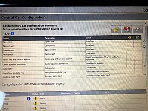

I am sure it doesn't actually make any difference but while scanning the car configuration file on my new '10 XKR I noticed that the setting for audio was set to Premium sound with 12 speakers.
Maybe the mid range frequencies on my car are trying to play on the 4 missing speakers

I'm out of town again so I haven't had a chance to do anything more with this. I'll be home again on the weekend.
The setting in the CCF where it has the speaker count isn't really relevant. Only the Base, Midline or Premium part matters.
