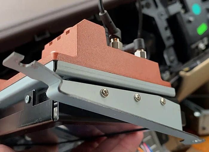

The screen brackets are mounted to the display with 3 screws, indeed easy to create a custom bezel.
The original head unit of the XF is similar to the XK one, I can't believe that Jaguar arranged the cables / pin layout differently. But I may be wrong...

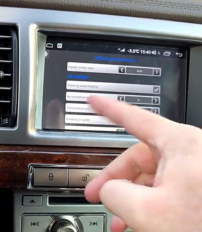

From Taffyduck on the X250 forum. He took a pic of the smaller unit after selecting the XK in settings. Heated steering is there. Now whether any of it works as intended is another question.
If Yes, then I want it.

Oddly enough Bob, the mounting brackets that came with mine are horizontal as opposed to the verticals in the pics above. So mine would not be direct but very easy to fabricate one. Either way it will be a non issue.
