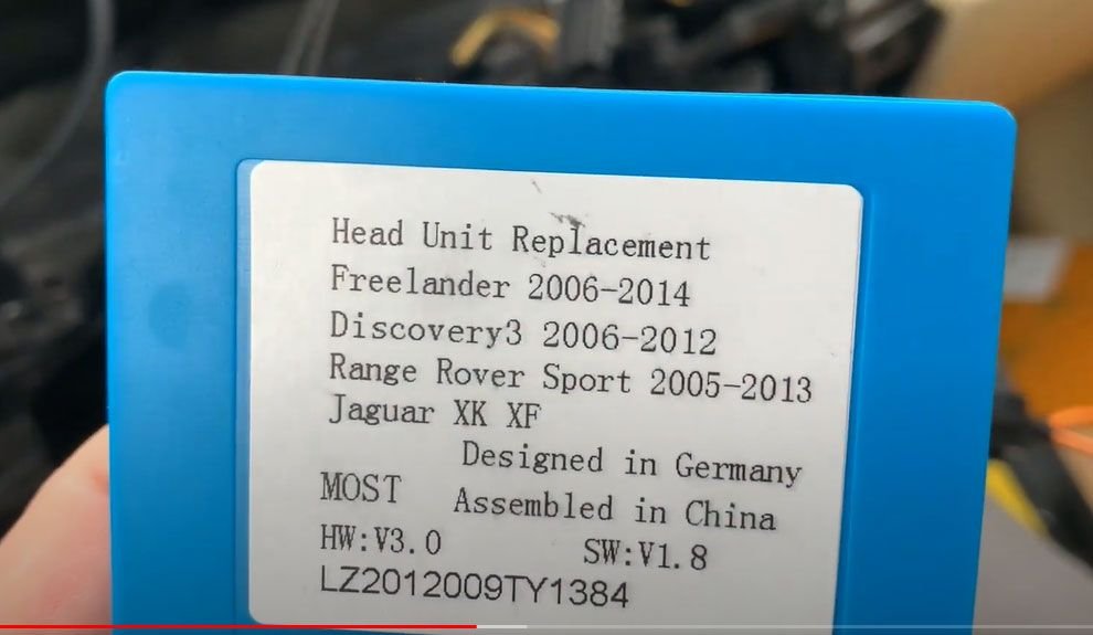

You can buy this device without doubt.
Here is the image from the box of the device from my video, which is showing undoubtable that is also made for the XK.

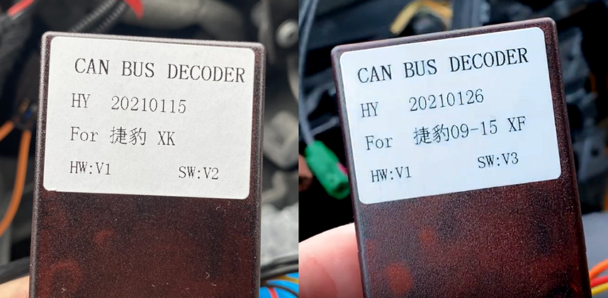

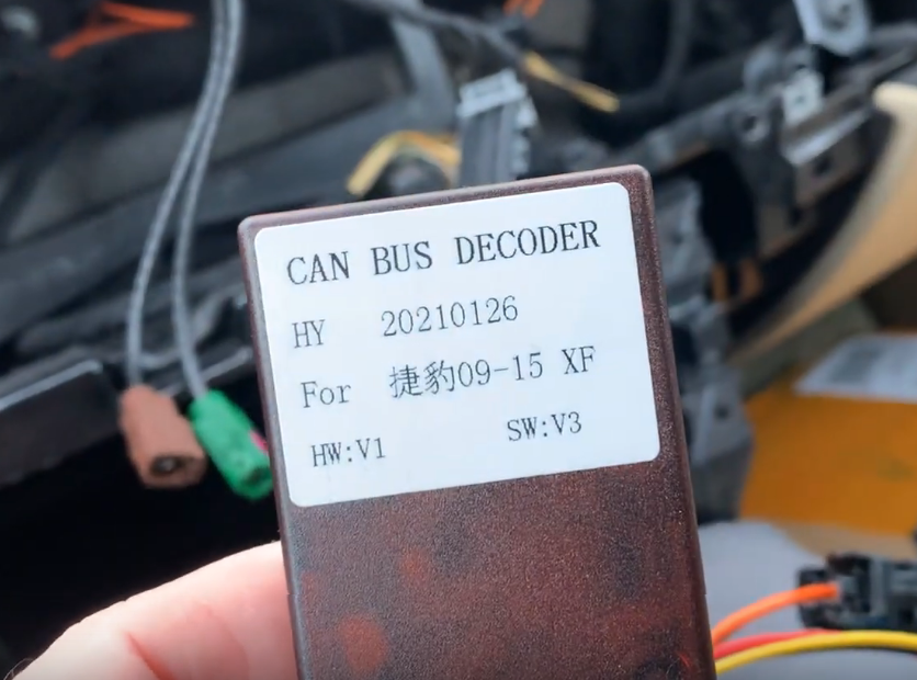

That device is probably gonna work, but the CANbus decoder might be vehicle-specific.
Also from your video:
can bus decoder XF
Then you have to ask Jaguar if the Canbus is the same in the FX and the XK and if they say yes, then you know it will work.
You could also ask somebody who bought the Tesla version for the XK to show his decoder what it says.

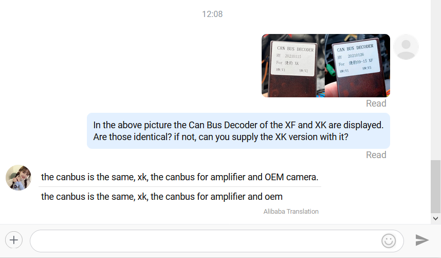

Question has been answered, they claim both are the same:
aliexpress answer
XF and XK can bus decoder

I would not trust the answer!
If they were the same why would it not say XF/XK?
Ali seller just wants to sell.
I could be wrong though.............
Only one way to find out!

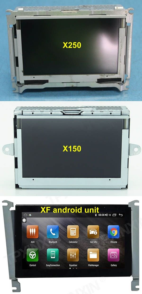

Looking at pictures of disassembled dash parts I see that there are some differences how the units are mounted,
the XF has the unit mounted to the dash with 4 screws, the XK has the unit mounted to the bezel with 2 screws.
The physical mounting points would not deter me from installing this unit IF it worked as advertised. Moving brackets and braces around is super-simple.
It just has to work is all. The rest is always doable.
agreed, mounting is a non issue. In fact most of the units I've had don't use the front mount on the X150, they use 4 screws in the side. Some units don't even have those front mounts The unit will fit in the X150 slot, it can work.
