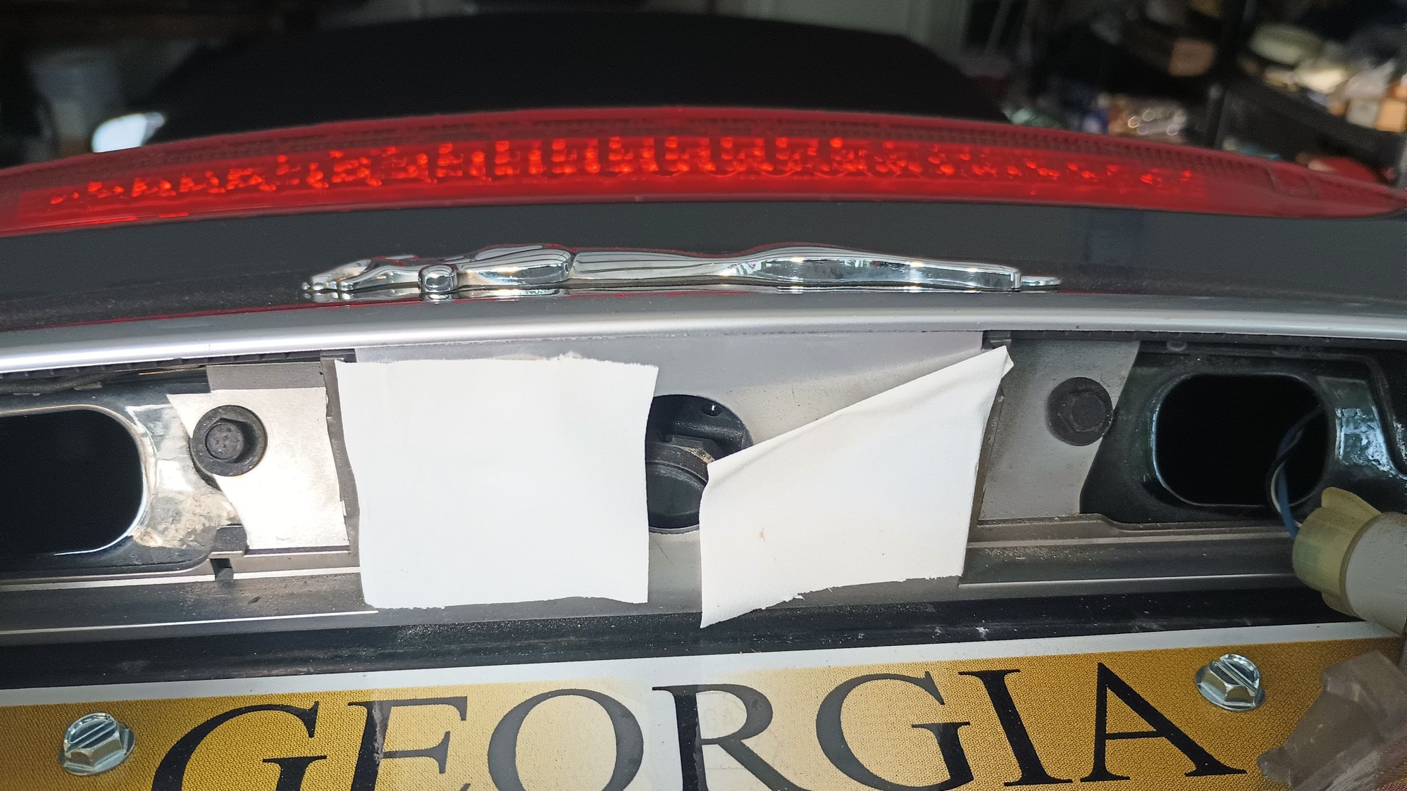

Mine is a 2007 XKR 150 and I am requesting that the Moderators move the thread if possible. I pried out the license plate lights, they are prised from the center with a thin screwdriver taping the trim so as to not scratch it.
Once the light fixtures are out there are additional 7mm screws underneath. Removal of these and the outboard ones under the plastic plugs allow the plinth to be pulled out. There are additional clips on each side, one came out easily and the other required some force. Nervous that I would break it, but finally came loose.

The 7mm screws hidden under the license plate lights. Gaffer's tape to protect the finish.

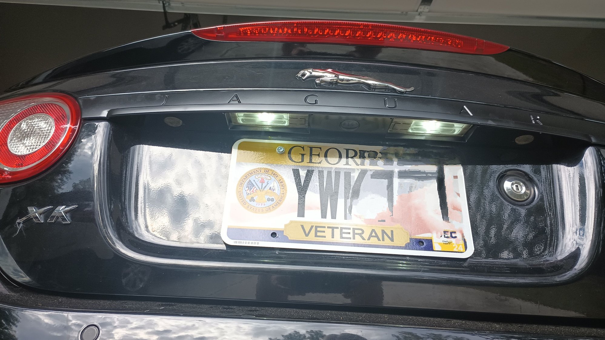

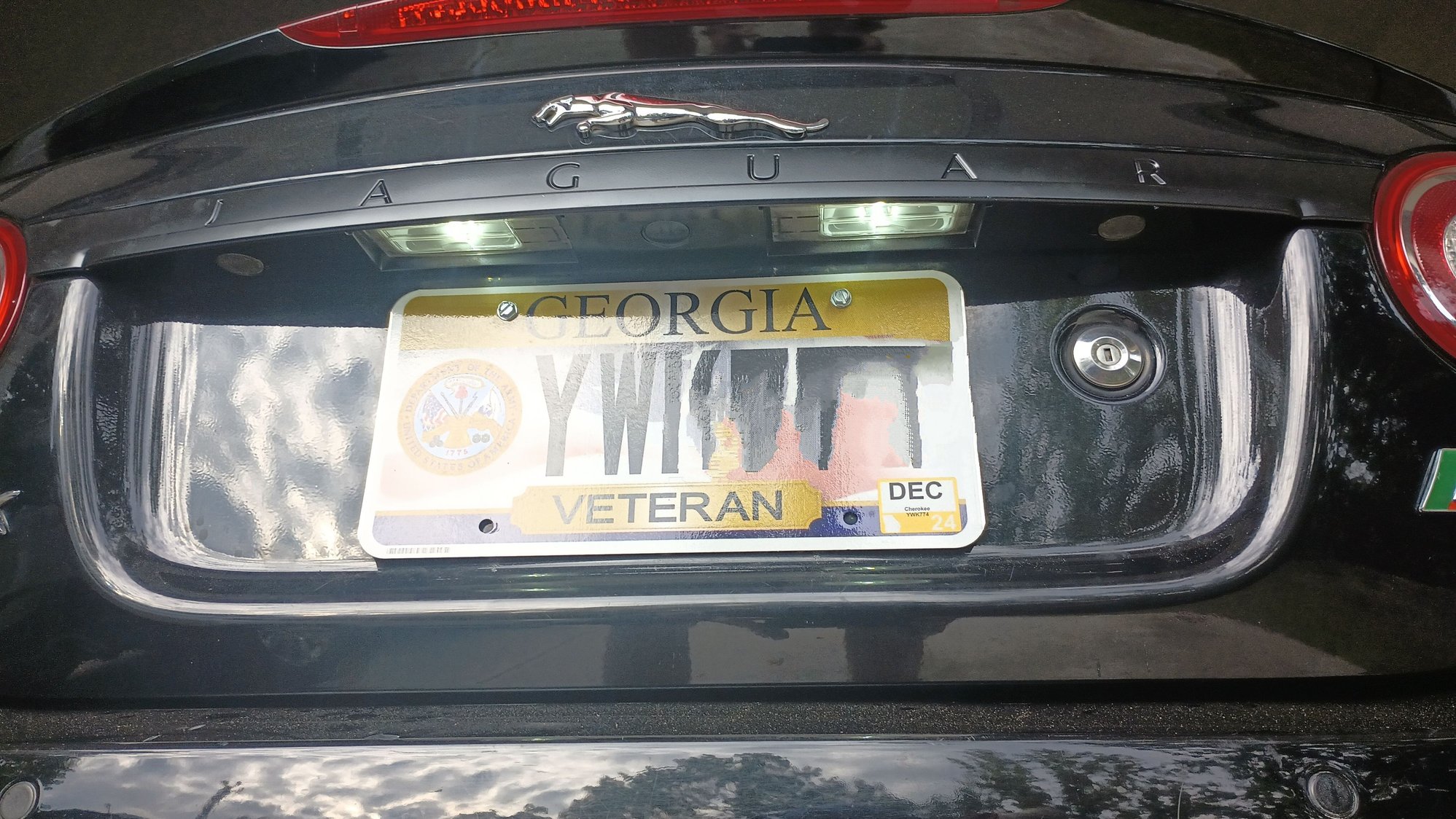

The job is finished! Here's the glued and reinforced plastic bosses to hold the boot release button and once fastened I potted it slightly with JB Weld clear five minute epoxy.
I didn't have any silver paint to dress up the plinth so I used the satin black. Plugged in the T10 LED lamps and put it back together. The lamps are described as CANBUS and I've not had any codes thrown. It's not perfect, but then again neither am I!
