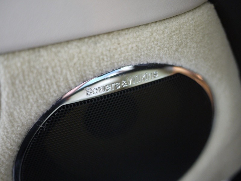

1. Premium sound on EU2008/USA2009 models are identified by the Bowers & Wilkins logo on the speakers in the front doors. Here's mine:

Good luck, and I think you'll enjoy the XKR.
