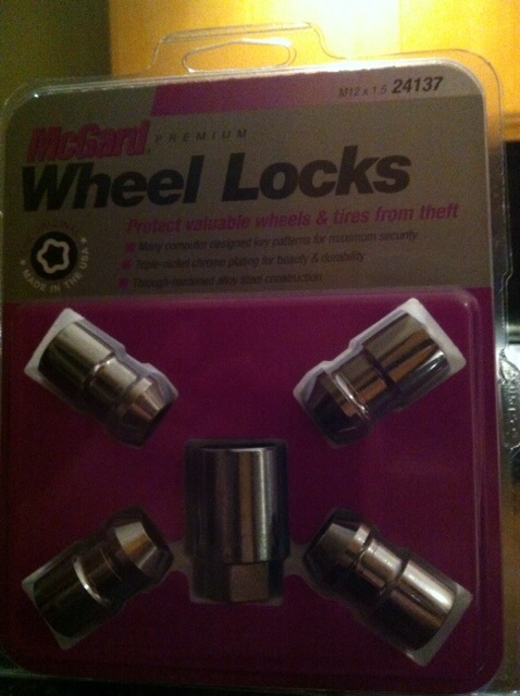

Yes. Here they are. I incorrectly stated earlier that I purchased these on Ebay. I actually purchased them from Amazon.com for $19.95.

I just ordered them from Amazon.com for $25. I took one lug off and the picture makes the locks look longer than what I have, but the measurements of 1.5 inched deep and 3/4 inch across seems correct. Does each lock sit evenly with all the other lug nuts? I just don't want to have it sticking out. I love my symmetry!

LOL. Yes, both the regular lug nut and the wheel lock have 1.5 inch spines. Your symmetry lives on.
