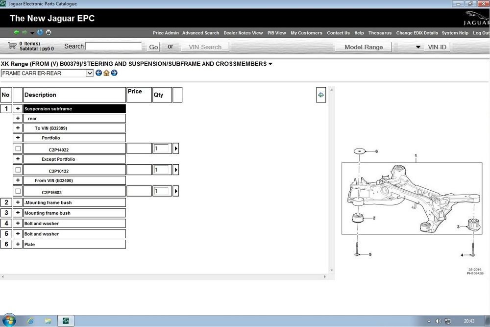

Looking at a XK subframe perowned. They look pretty much the same but will be it a straight bolt on?
Old Jun 7, 2023 | 05:25 PM
Likes: 17,005
Welcome to the forums ronzinio,
Not suprised to hear the bushes are perished but unlucky to have rear subframe problems on an X150.
According to the Parts Catalogue, the same subframe fits both XK and XKR (except for Portfolio) with a change at VIN B32240.
