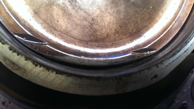

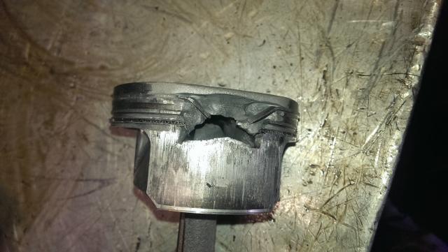

engine now stripped and it appears only one piston and bore is affected possible faulty injector?

now looking for a single piston if anyone can advise , unavailable from jaguar!

I have had luck through ebay, you would need to find a seller in your area that sells engine rebuild kits.
I would suggest internal engine parts group, but they are here in the US and I'm not sure if they will ship internationally.
You could always give them a call to find out. I might be able to help you ship that via the us postal service, they are much cheaper than fedex or ups for shipping in europe.
This is the number for their tampa, FL location: (813) 630 4646
Do you have a picture of the side on that piston?

Would this be another reason for the makeshift gauges to check on A/F ratio etc.?

PS
I would highly recommend removing a neighboring piston to have exact measurements of the piston, so you can call a manufacturer such as wiesco or mahle (mahle has sellers in europe)
With the measurements they might be able to cross reference the piston with a similar unit.

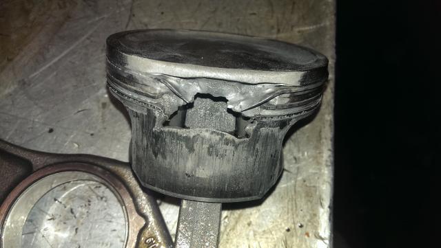

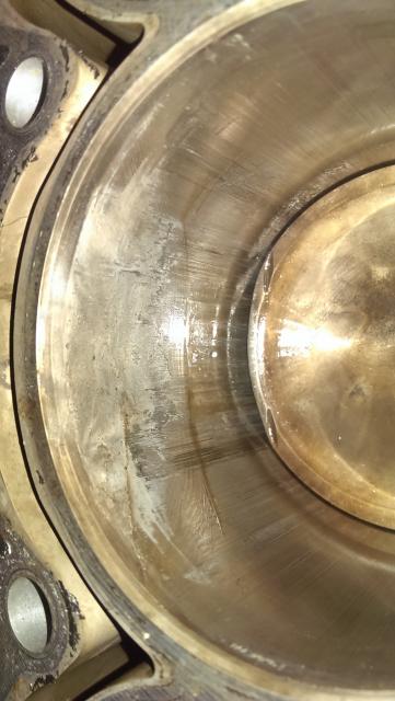

engine stripped and a lot more damage sustained than originally thought

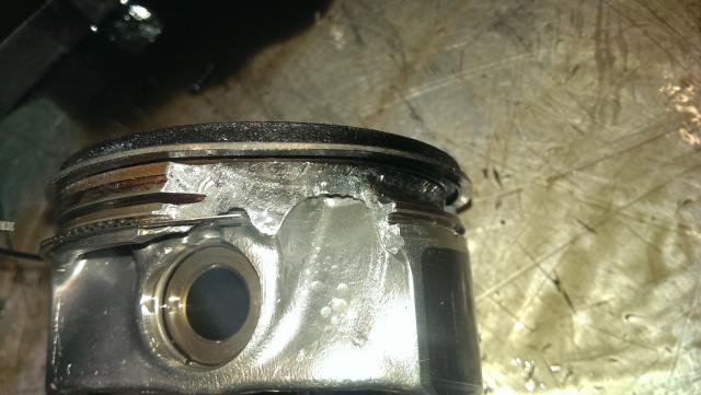

opposite side piston also damaged , why?

Opposite side of same piston, or piston from opposite side of engine?
opposite bank

In that case, weird. It does seem that engine's either got some intrinsic flaws, or has been abused. The way that the top ring of the fractured piston is bent down, just above the missing chunk, might suggest that something got ingested into the cylinder and was trapped between the piston ring & the head, shoving the ring downwards and chipping a chunk of piston off. But that's just a guess - and if it was something like that, where's the foreign body gone?

What did the mechanic's say was the problem. It looks like the ring may have broken and taken out the piston. Could it have been a denotation problem ? Was this limited to just one cylinder or is there more damage. Is the cylinder salvageable or would they replace the block. Any info on how this happened would be worthwhile.

the mechanic ie me , I was driving it at the time ,cruising at aprox 80mph , flicked down shift and heard it pinking then it misfired on that cylinder and puffed smoke out exhaust . coasted to around 30 and drove home , stripped and foud this ,
I recon the injector wasn't correct or maybe a fuel pressure issue but that would affect all cylinders, doesn't explain the broken ring land on the opposite bank piston
all very strange , anyway , sample piston sent to various manufactures to see if I can get them made as they are unavailable from factory
