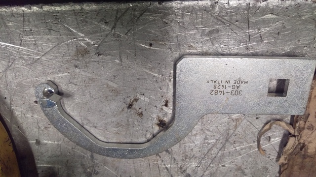

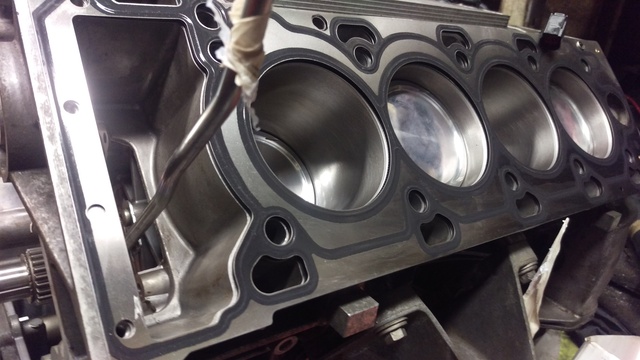

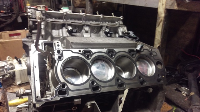

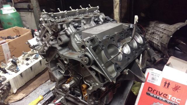

sorry for the lack of updates , finally getting to rebuild this engine , new pistons in , gaskets and timing alignment tools bought

Jagal,
Great pictures........in the States you can rent the Valve timing tool from JCNA, at least the 4.2L, not sure about 5.0L (may be same!)
Cheers, Adrian

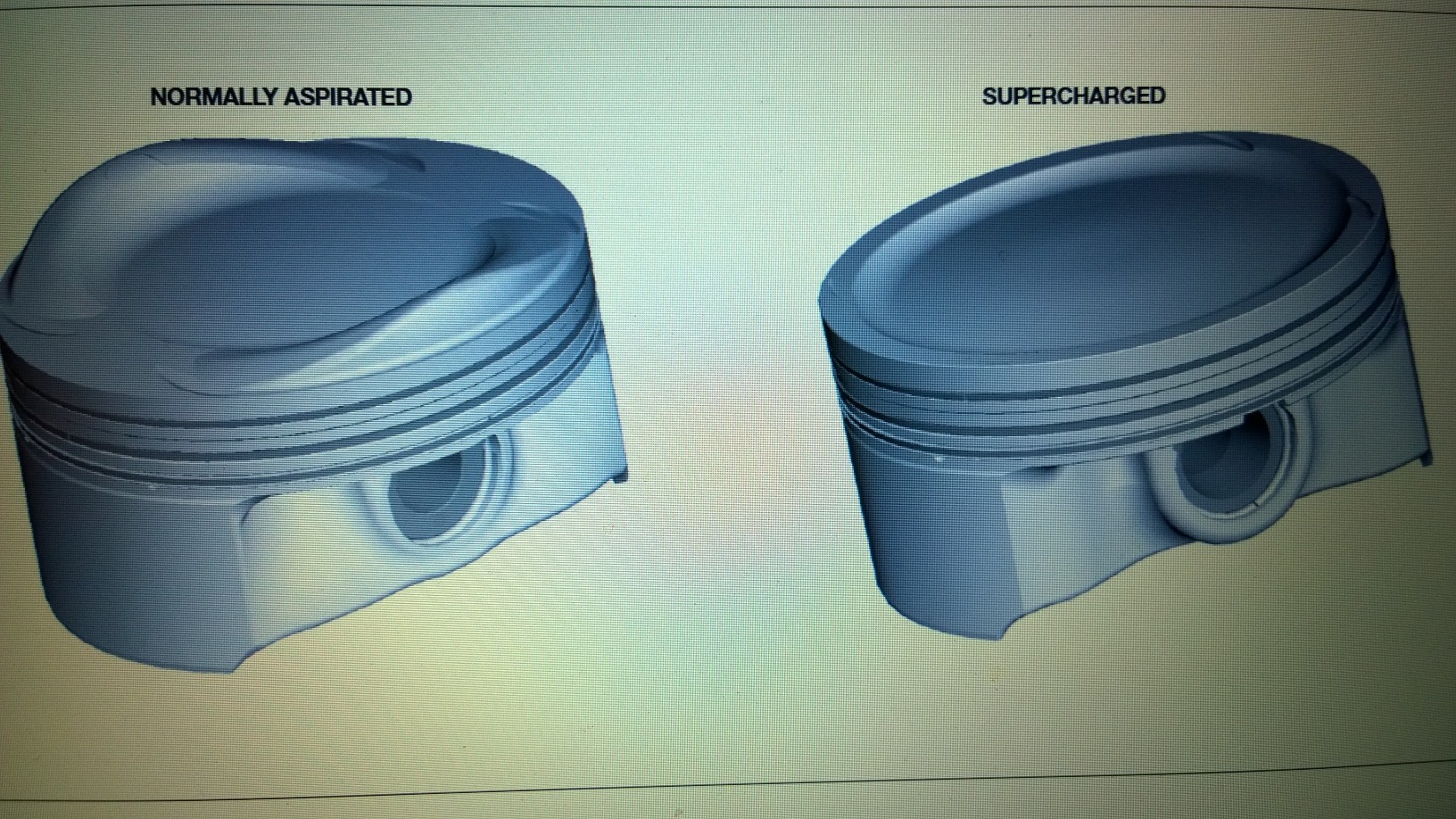

I was quite surprised when read 5.0 V8 engine manual that they really have gone for cast pistons , also in SC engine. That's a downgrade from forged pistons used in 4.2 V8 engines and back to 4.0 which also had cast Mahle pistons.
Jaguar says:
"The cast pistons incorporate a number of features designed to enhance durability, minimize friction, and reduce wear. "
Cast pistons give longer life but do not like any detonation. Forged and specially the ones made from alloy 2618, give more safe margins for possible detonation and higher boost . This also explains why Arden replaces the stock 5.0 pistons by forged pistons when makes installation of twin-screw SC.
Jaguar says:
yes im upgrading performance so opted for forged bespoke cp pistons
engines assembled now pics to follow
Good decision. My CP : Forged Piston Photo by savirta | Photobucket
