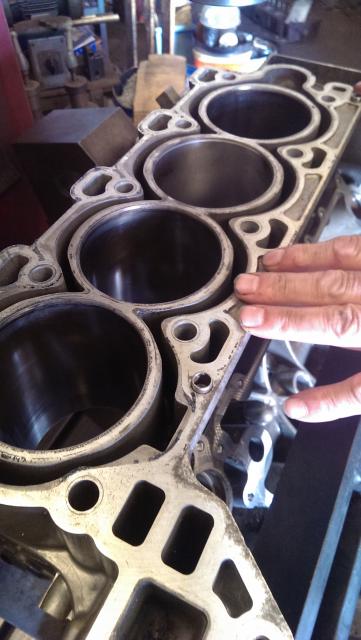

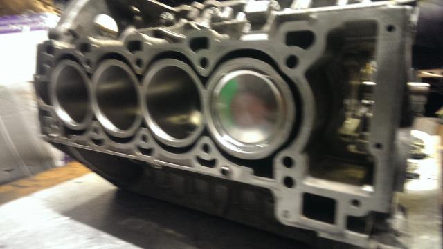

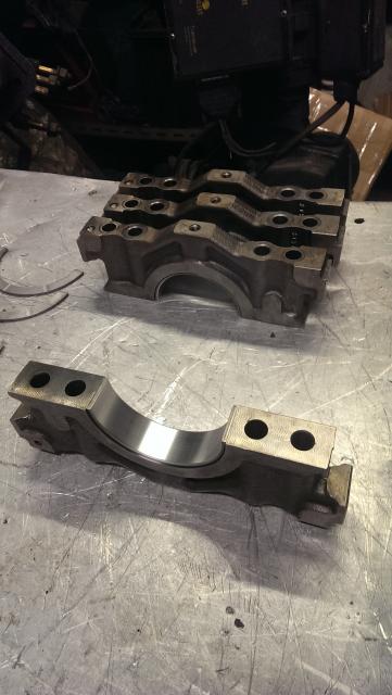

block being over bored 20 thou , 0.5mm

Blocks are so much more 'skeletal' these days, compared to the old cast-iron lumps I used to work on.

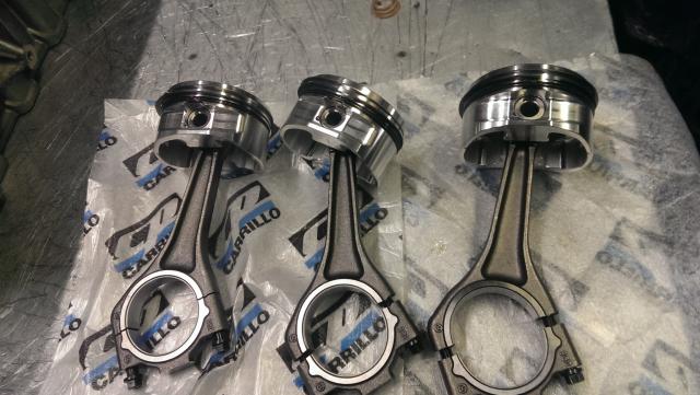

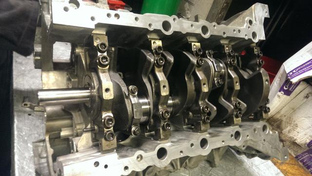

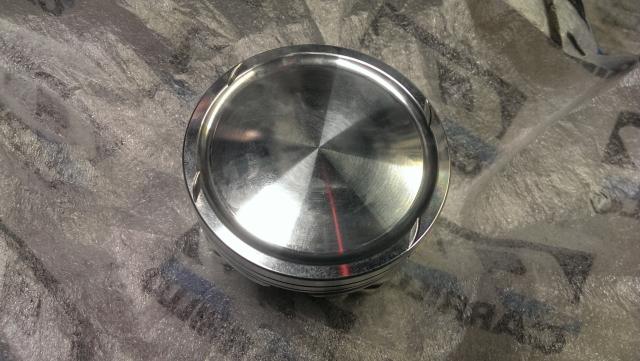

bespoke oversize forged race pistons

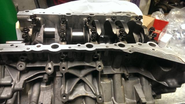

short block all assembled , probably the first 5100cc xkr in uk, next step fit heads /cam timing etc

Wow! 6 months of downtime with the engine.
Assembly looks great, however. Are you doing the work yourself? Are those cylinder liners removable or, an integral part of the block?
Good luck and keep us posted on the final assembly and running of the engine. It would still be very helpful to be able to pin down the cause for the failure. Without that I would be quite worried about a repeat.

5054cc - to be exact, if the bore was oversized by 0.5mm to 93mm

yes a long time indeed, took a while having the pistons made as they are unavailable from main dealer , the liners are integral to the block
ye 5054cc close enough lol
might ad a few bhp
cheers
