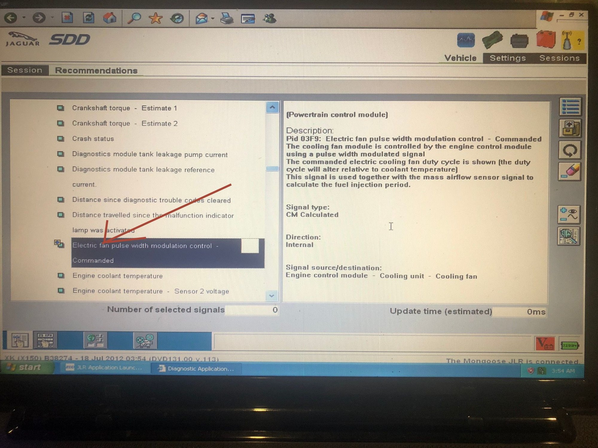

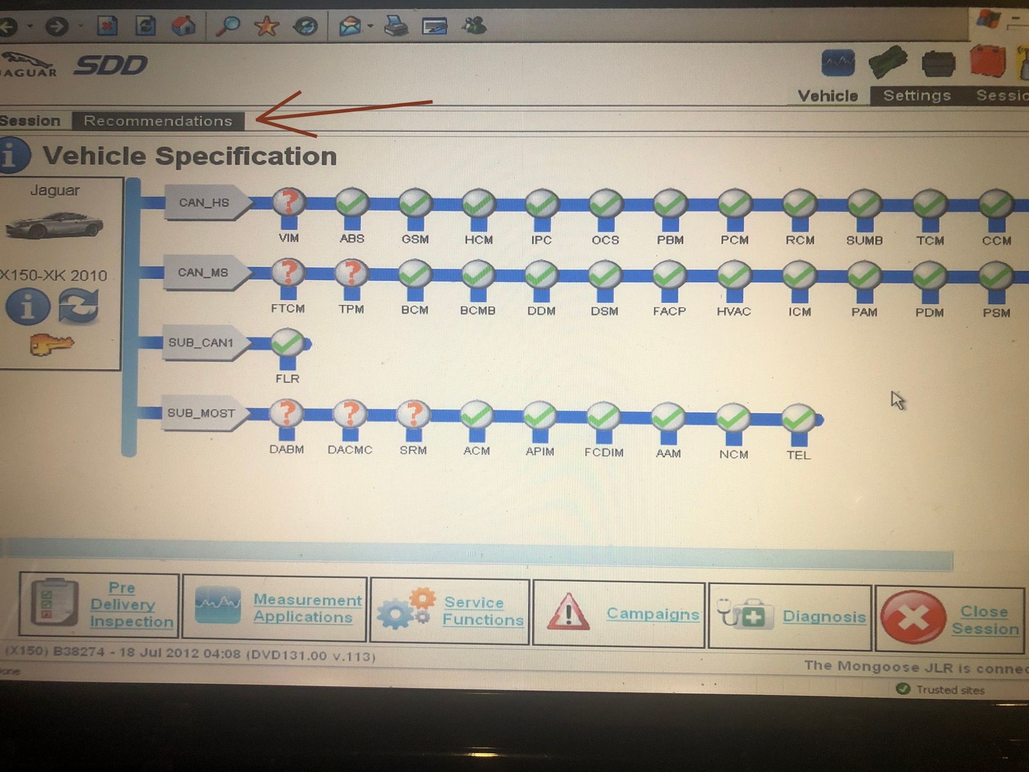

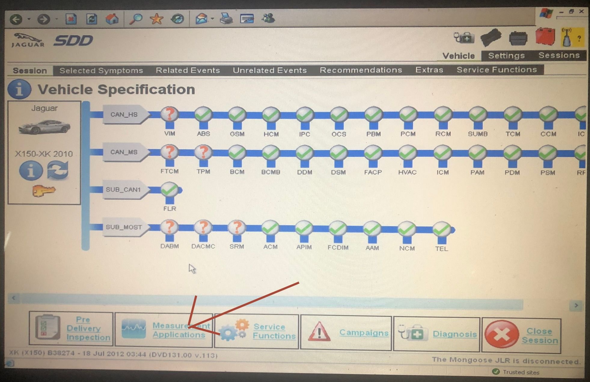

Unfortunately SDD isn't very intuitive! I haven't played for over a year and I don't have it plugged into my car at the moment but I have fired up SDD and grabbed some screen shots.
You need to open the Datalogger by selecting Measurement Applications

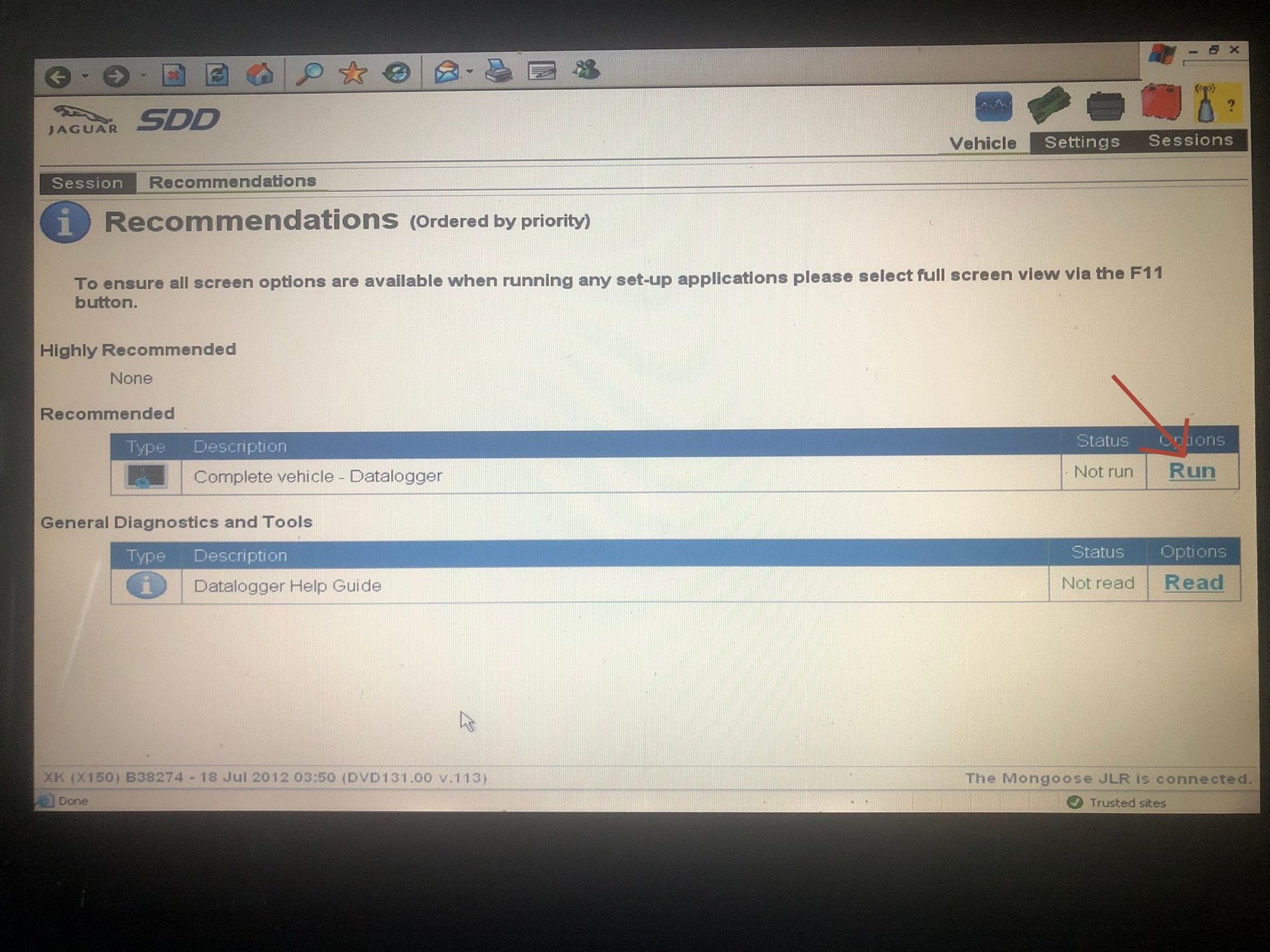

That doesn't appear to do a lot but you then need to click on Recommendations:
This screen will appear and you click on Run:
Welcome to the Datalogger!
A menu of options will appear and the fan control is actually under Engine System:

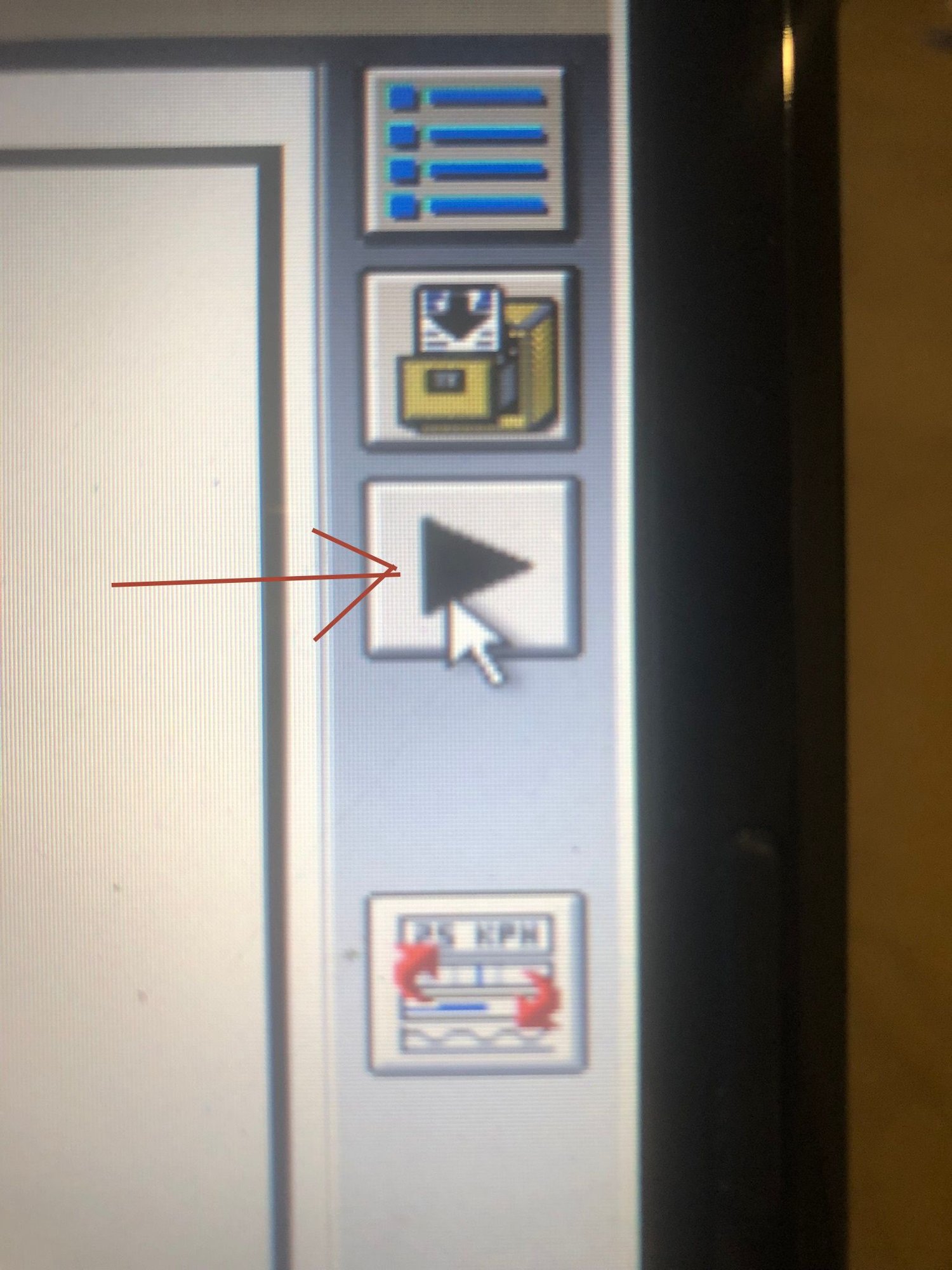

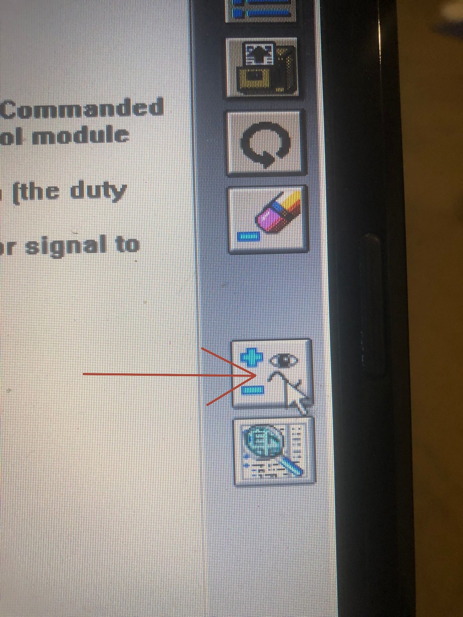

Select it in the menu then click on the plus/minus button to enable the tool (a black start icon should appear next to the menu item:

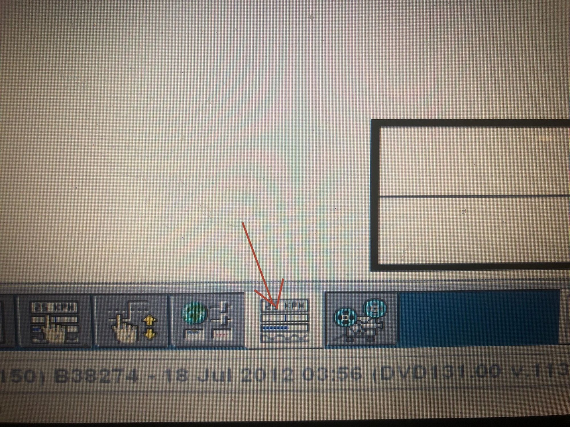

Click on this icon to go to the logging screen:
Click on the Start button to start logging:
This is where is gets a little hazy!

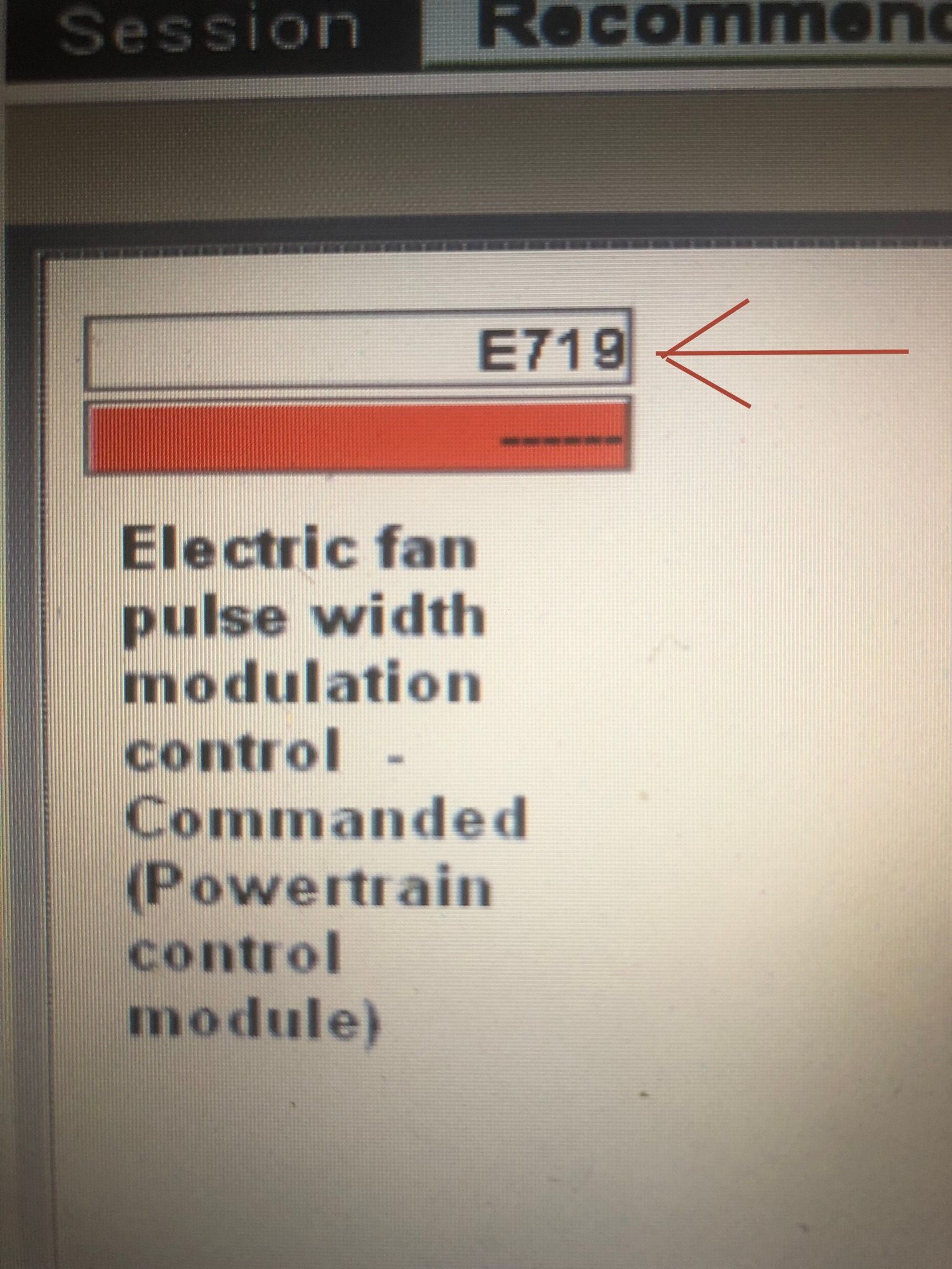

Because SDD isn't plugged into my car I am getting an error but I think you can control it from this box, possibly by editing the value:
I don't think it was very obvious but have a play and if you can't work it out, or it is the wrong box, I will plug SDD into my car and refresh my memory.
Old Feb 19, 2023 | 01:04 PM
TraxtarXKR's Avatar
Joined: Apr 2019
Posts: 391
Likes: 151
From: Dallas, TX
Could not have asked for a better reply. Incredible.
I'm able to toggle the pwm percentage (percent), but the fan isn't spinning. Hoping someone can confirm that playing with this setting while the ignition is on (engine off), should indeed spin the fan, and the fact that mine isn't means it's a bad module.
