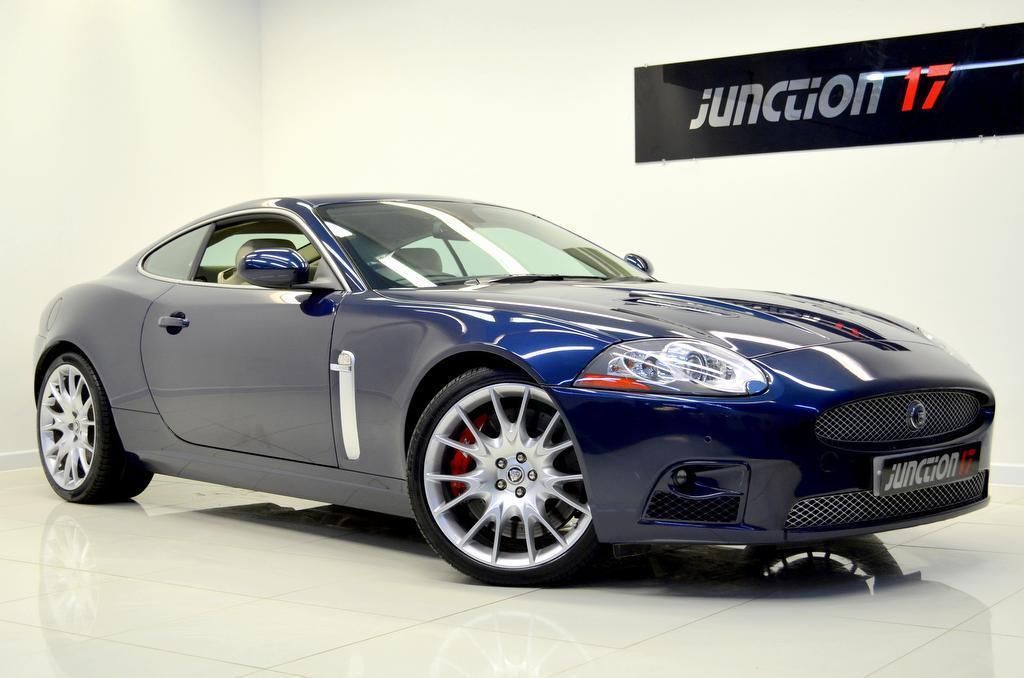

Here's a photo of the 2008 XKR-S with Alcon brakes and Vortex wheels:
Stuart

The 2008 XKR-S (European model) was equipped with Alcon brakes and Vortex forged wheels, so I think the Vortex wheels should fit. Although the fronts are the same 9" width as the Selenas, the rears are wider - 10.5" compared to 10". I prefer using an OEM Jaguar design wheel, and a forged wheel is much stronger than a cast wheel (and more expensive, but worth it IMHO).
I'll see if my dealer's parts department can determine if the Vortex wheel will fit and, if so, the cost.

Stuart:
Love the Vortex Wheels also:
Our OEM 20" Selena wheels are:
Jaguar 2009-2010 XKR Portfolio "Selena" Triple 5 Spoke
Size: 20x8.5 front and 20x9.5 rear
Bolt Pattern: 5x108...
Centerbore 63.4mm....
Offset: +49mm front and +31mm rear
The Vortex wheels cost about $800 each....just not sure they would fit.
Let me know what your Jaguar dealer tells you.
