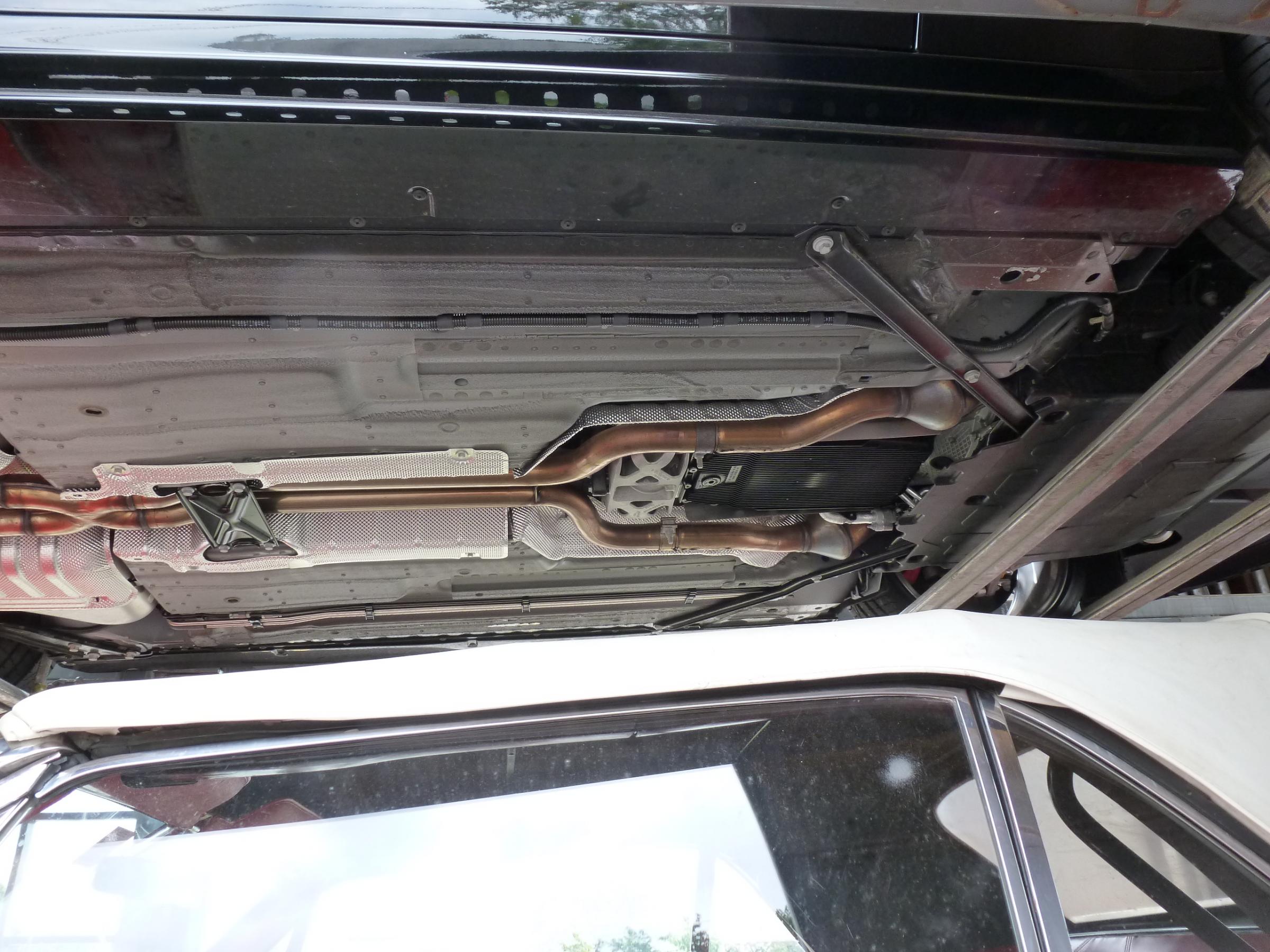

It shouldn't be any problem to switch the 2 resonated boxes for the X-pipe. I had the resonated boxes on my 2011 XKR 175 which I sold. I have the performance exhaust on my current 2013 XKR (same as XKR-S exhaust) and it is soooo much better. I've attached some pictures. There are no sensors involved in swapping out the resonators for the X-pipe. Let it roar...
Attached Thumbnails XKR Centre Mufflers Delete-p1010822.jpg   XKR Centre Mufflers Delete-p1010808.jpg
