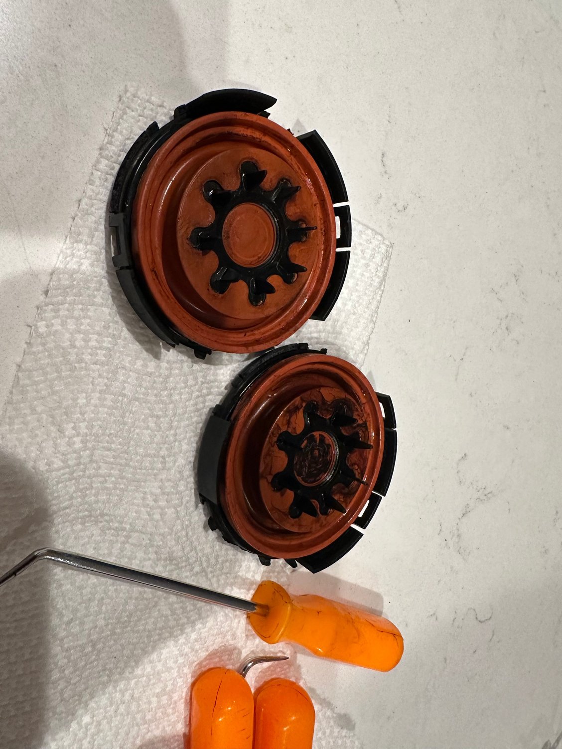

For future DIYers -
wish I took more photos but unfortunately was deep in “did I fck up” territory
this job is possible without removing the supercharger BUT it is extremely tight and you have to break off the older parts so make sure you have new parts ready
Once you break off the tabs from the prior PVC caps (see photo below), rotate around the caps and keep breaking. then you have to manhandle the cap off but be sort of careful because there are springs underneath
For the reinstall, I found it easiest to put the spring on the valve cover first.
put the replacement cap on halfway, and use a tool to align the spring to the center of the cap
Then once roughly aligned, you have to push with force towards the V of the engine. The new plastic has some give as it is new and flexible.
Then once in place, you have you align the orange seal part with the top of the cap in order to get the tabs to click cleanly on the valve cover
the tabs towards the V of the engine are really hard to clip, so I used a trim piece removal tool to “jam” against the supercharger and the top of the cap to provide a bit of leverage from up top. This is why the prior alignment step is important. You should hear 2 clicks on the backside. 6 clicks total.
now repeat for the 2nd one.
photo below of the old caps with the tabs broken off
this is a good video that shows how it should be removed/installed when you dont have a SC. with the SC its a different animal
