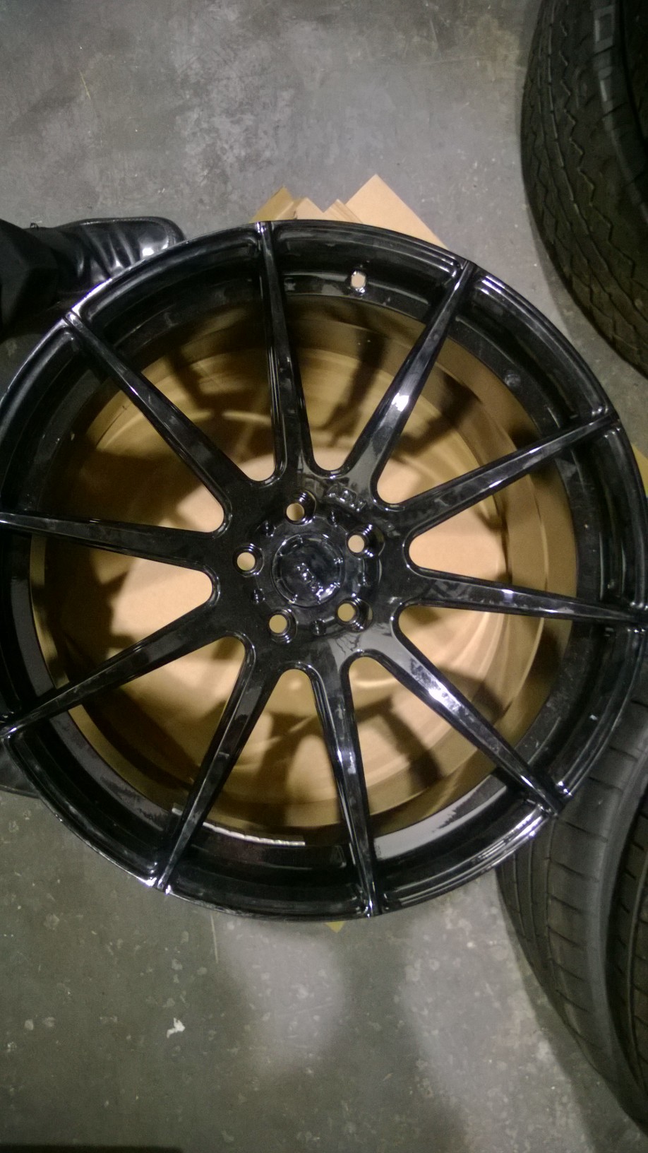

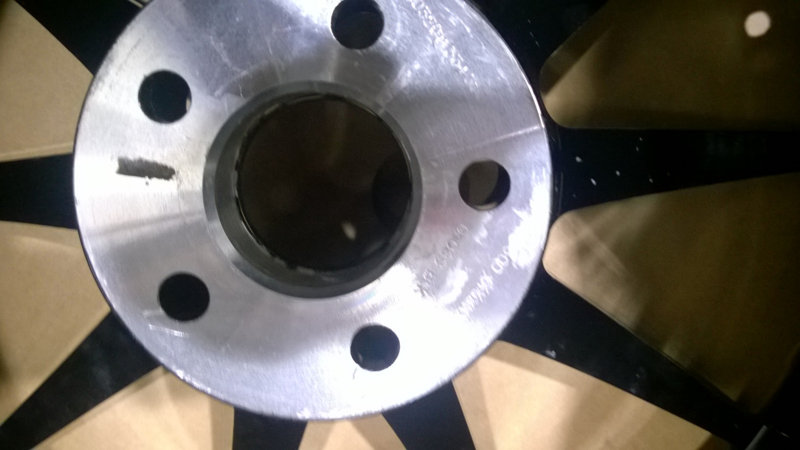

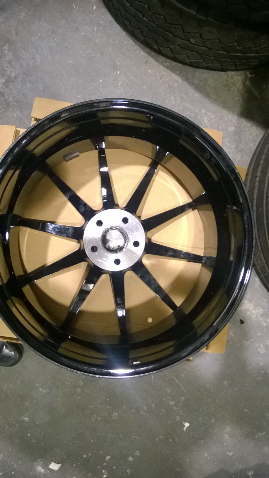

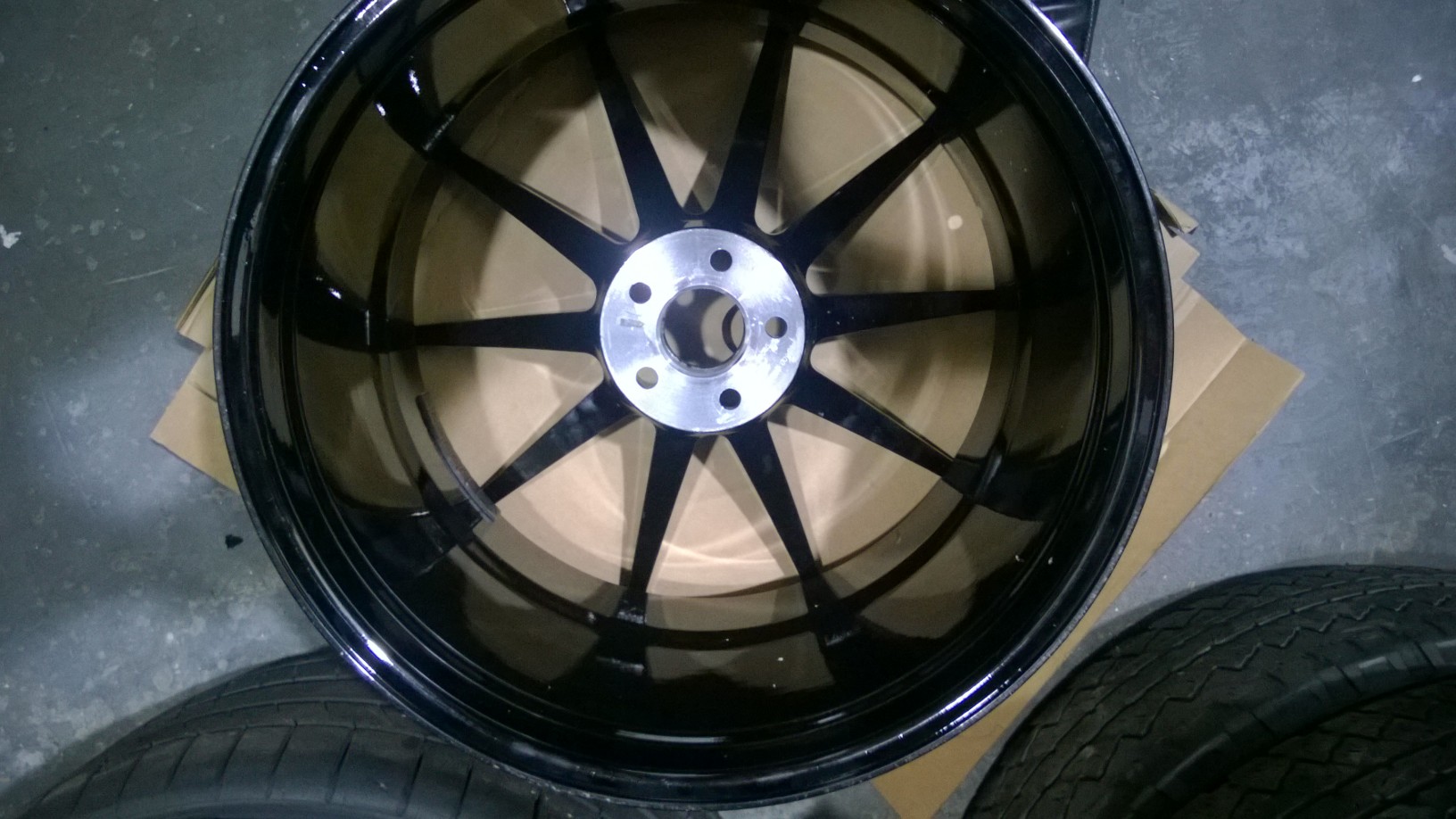

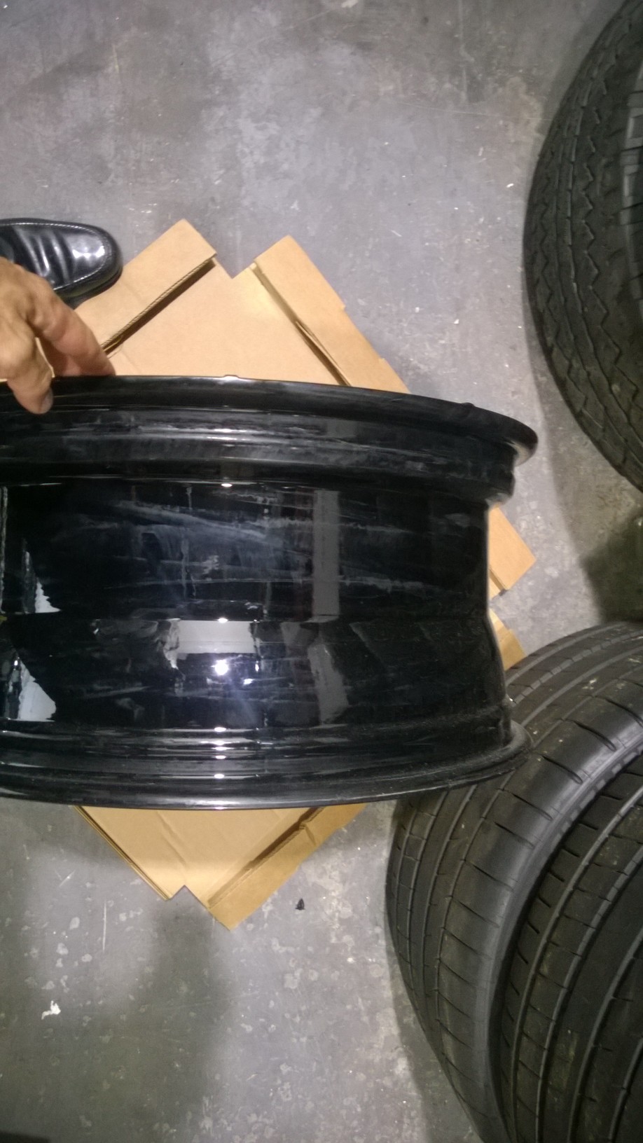

Thats exactly what I thought as I think remember the offsets being pre 2010 cars. Here are some pics so if any 2007-2009 owners are interested. They are brand new and had tires mounted on them once. Never have then been driven and have been stored ever since we realized they were not the proper offset for a 2013.
Please excuse my photography I took the best I could and if you would like to see more let me know.
I'll tell you honestly the dealer cost was 5190 and I paid 6400 for the set. I just need to get rid of them as they are taking up space.
20x9 fronts and 20x11 rear with ET49 and ET31 offsets respectively. The 4600 you see stamped in the inside wheel center is the PO number that you can see here ADV.1 Order Status » PO 4600
