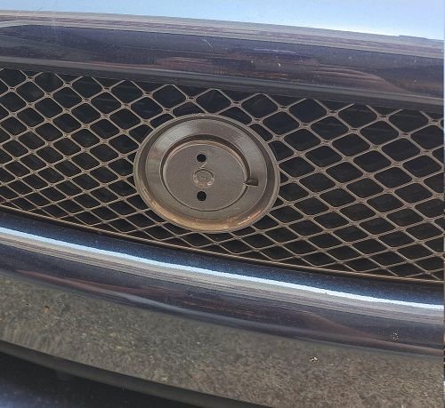

Old Jun 8, 2025 | 08:59 PM
MCX's Avatar
MCX
Joined: Oct 2022
Posts: 28
Likes: 39
From: St Louis, MO, USA
Mine was missing today and as I was at a european car show , I'm assuming it was knicked and didn't just coincidentally fall off. SIgh.
I can see wehre it looks like you could just press and stick one with adhesive, but screws would be better to deter another thief. (of course a thief might do more damage with a screwdriver if it's actually not coming off easily too)
Do I need an 'emblem' replacement that has a bezel around it or just one of the badges from ebay that seem tor un about 30-40$? I'm super frustrated right now as I don't think i can get the same exact growler, so it will change hte look a little bit.
argh.
It appears to be about 86mm which is what I've been browsing on ebay. They come with adhesive backing which seems the simplest approach. however, QUESTION - I've also seen quite a few that had the 2 posts horizontally when you are looking at the cat's face...the holes in my grill are vertical.
Does this indicate the back/bezel some holder of the badge should spin, or do you need to get one without theose horizontal plastic guide posts in this case?
EDIT, AHA - i see Paul did address this later in the Life on Cars video, phew, I was really wondering if the standard replacement badges I'm seeing weren't standard for my year or something.
This is what I'm looking at now and what it was. Sigh. it's all well and good to change the character of the car when you want to, but having someone else **** it up and make me do that ruined my sunday.
Appreciate any input if you've done this and hopefully it's just a simple $30 part and some adhesive and I will have to live with the little growler's appearance becoming a bit cheaper, going to match the whee caps it looks like.
Thanks
MC
