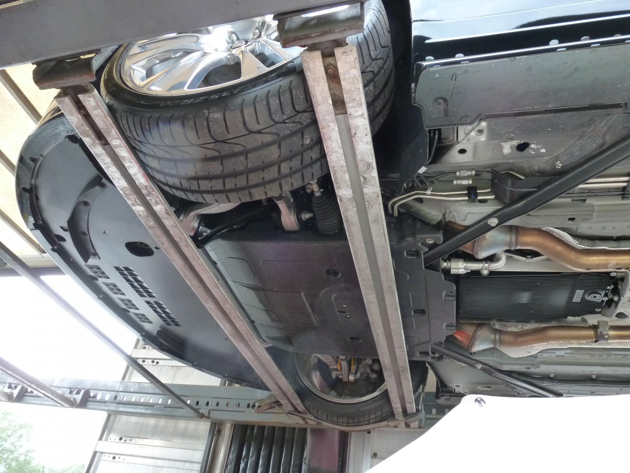

Picture of performance exhaust X-pipe:

DGL,
Is that the way it came from the factory? If so, do you have a picture of the front section where it comes out of the headers? In most of these applications I have seen the x pipe is installed where the headers meet up in the front section of the car.

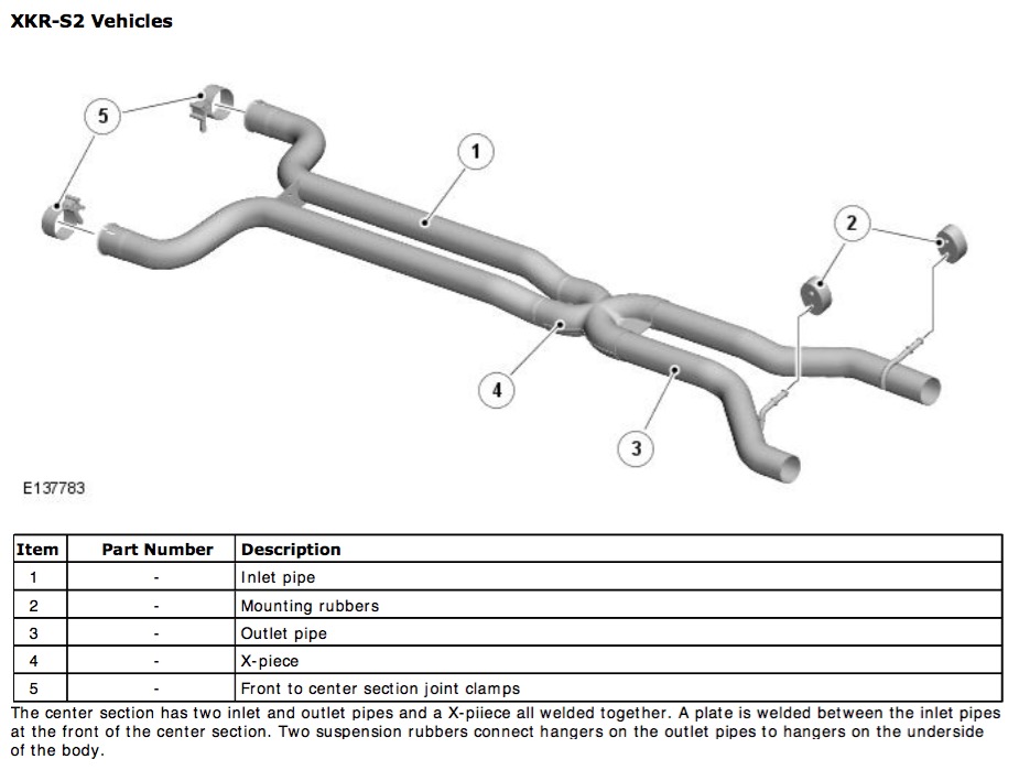

It connects to the end of the cats. Here's a diagram of the system from the workshop manual:

Originally Posted by Greek175
DGL,
Please let me know,
Yes, these pictures were taken when my car was new with 300miles on it. Here are some other pictures from the same time:
Attached Thumbnails XKR175 exhaust mods-p1010817.jpg   XKR175 exhaust mods-p1010810.jpg   XKR175 exhaust mods-p1010808.jpg   XKR175 exhaust mods-p1010815.jpg

Wow,
That is amazing Essentially, I can run straight pipes to x pipe and right into rear muffler. Should be real simple. This should save weight and dramatically increase flow. I think I will leave fuse 19 in so that there is some back pressure and just put it in dynamic when I want to run WFO. This should make it sound XKR-S similar I would think...
Thanks again for the pictures. I m still curious why Jag didn't put the x pipe closer to the headers. Must be some engineering reason why.

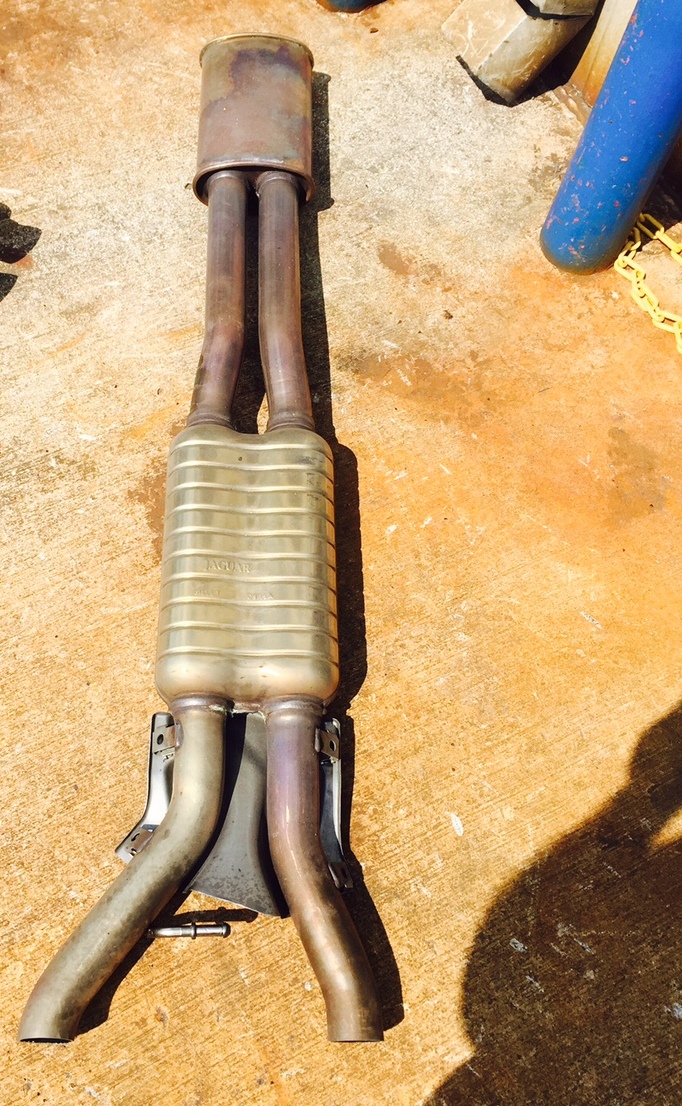

Just in case someone wanted to see before and after.
Attached Thumbnails XKR175 exhaust mods-exhaust-before.jpg   XKR175 exhaust mods-exhaust-after.jpg
Old Jun 8, 2015 | 02:42 PM
jagtoes's Avatar
Joined: Sep 2013
Posts: 5,209
Likes: 1,847
From: NY
Looks like a pretty neat job. Have fun.
