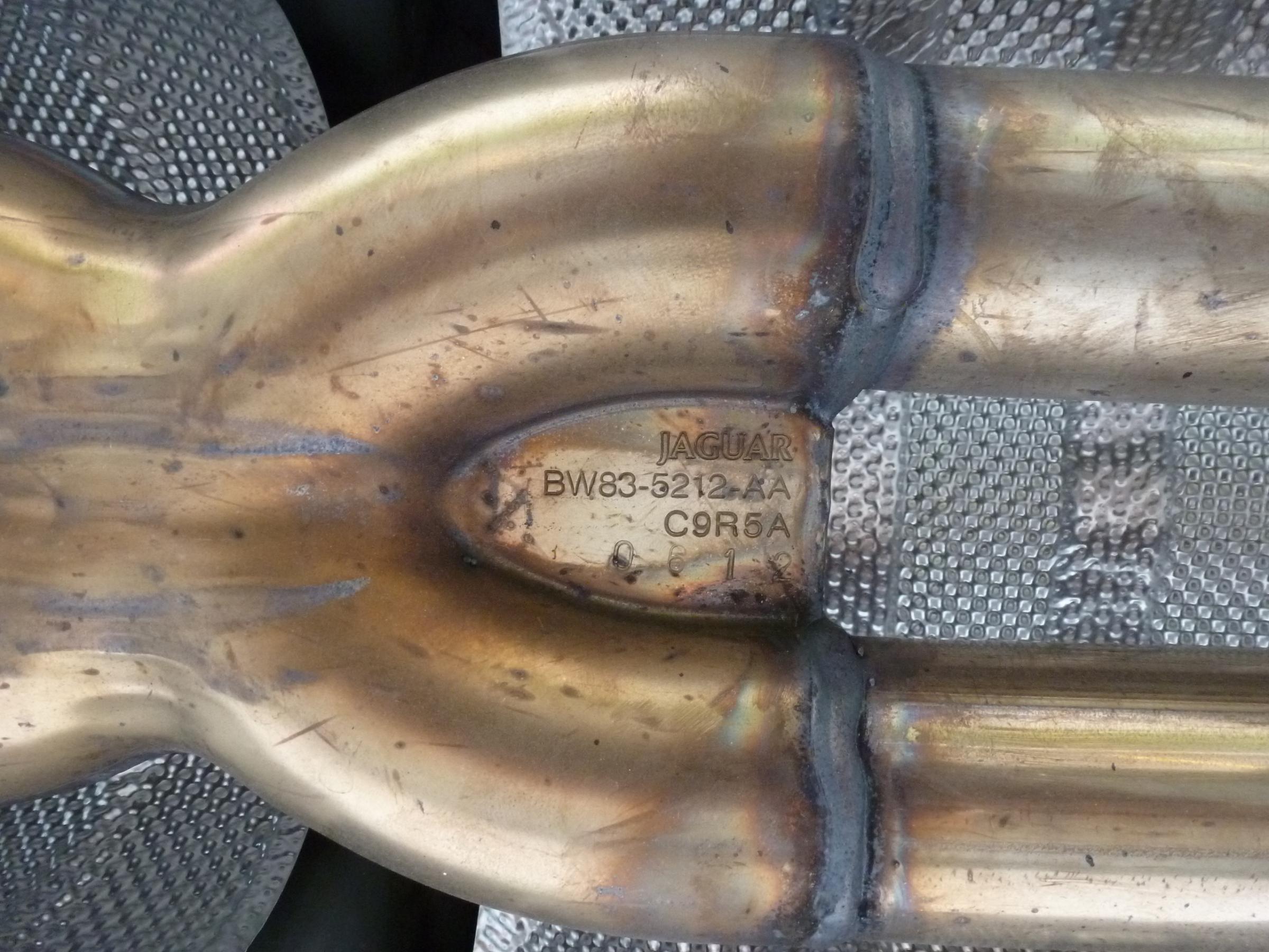

Originally Posted by R_Rated
How much is that simple crossover pipe from Jaguar?
Picture of crossover pipe with Jaguar number from my 2013 XKR

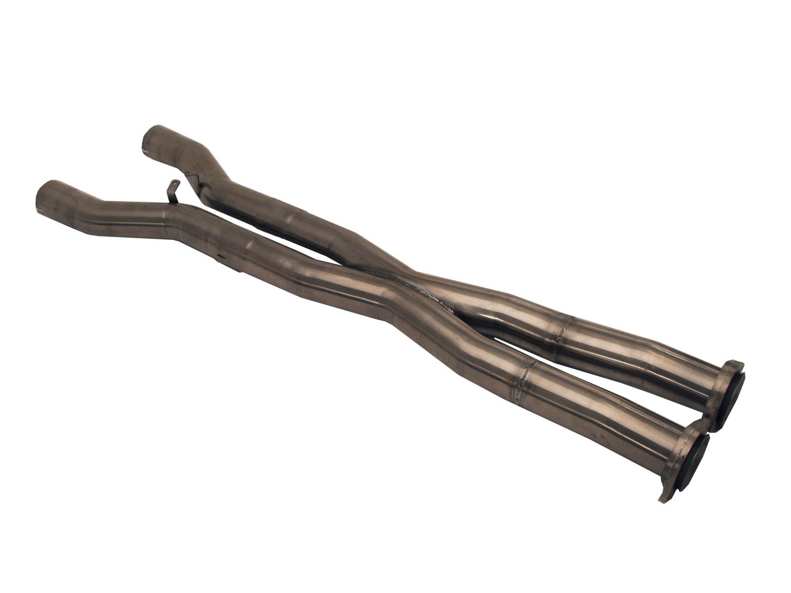

The nice thing about the exhaust from the cats to the muffler is the entire section is clamped together making it very easy to remove the pipes and resonators in one piece and save for possible future swap.
I had a custom exhaust shop make an entire replacement section including the crossover. I could have gotten a quote from dealer parts for the same factory section from the performance exhaust option, but this was easier and faster.
Can't give you a price because I made a barter deal with the shop owner but I imagine it would cost around $300 + or - a little.
Here's a picture example of what he did since I was not there to take pics.

Here is an option but you would need to measure spacing and pipe size. They sell a few options and a good muffler guy could put this together fairly quickly.
JEGS Performance Products 30680 JEGS Narrow Universal X-Pipe - Free Shipping on All Orders @ JEGS
http://www.autoanything.com/exhausts...A2672A0A0.aspx
