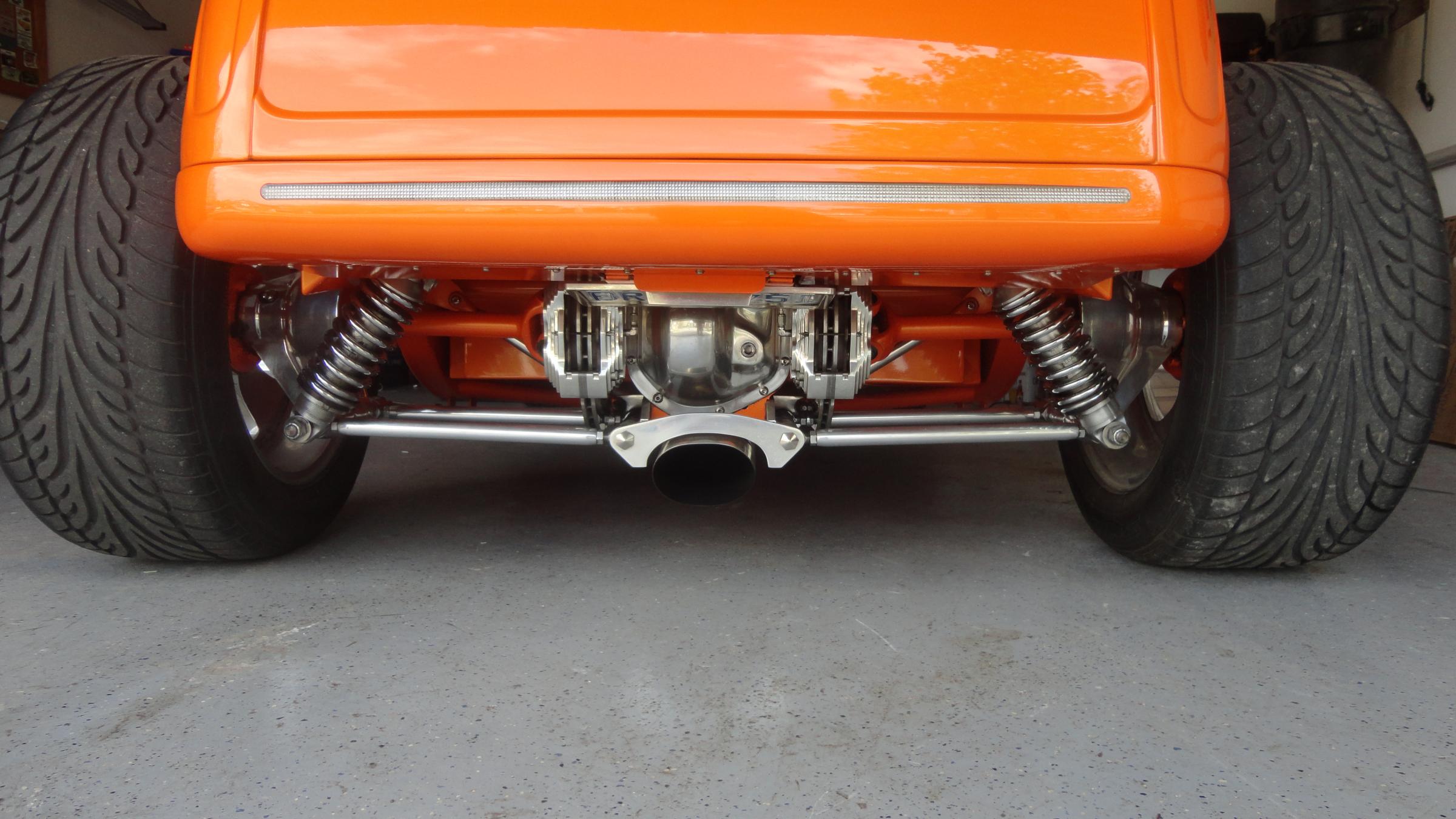

Right you are Ken a couple of my past cars have had flow masters that were very droney (if there is such a word) that at hwy speeds it was very hard to talk or listen to music so I started to experiment with H pipes,simply weld a pipe across joining the two pipes,the farther back I put the cross over the less drone (harmonics) I got but I've been out of the loop for a few years since I built my 32 so these X pipes make a lot of sense to me.When I built the 32 I went two quieter mufflers going into single tailpipe under centre of diff and it has a great sound all through the rpm range.

Randy, just noticed....you're a "rodder" too! That's why you know 'bout 'dem flow-masters, "H" pipes, drone and stuff.....
I'm liking your roadster! love the color. What's the power plant?

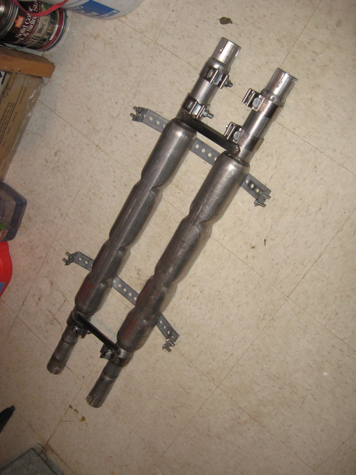

Randy, just thought of something, do you know about power sticks? These are what a number of the Cobra guys use in the their outside exhausts. I modified a pair for my
E-Type when I got tired of replacing the factory stuff every two years.
they can be purchased in custom lengths. I have found them to be the best sound, outside of a Harley and a Healy.
Are the XKR's pipes only 2.25?

Yes I've seen those but I'm usually limited for length in the cars that I've built although we put them on a friends 66 BB corvette to replace his burnt out factory ones. The engine is a 97 mustang cobra 32 valve 4.6 and yes we are getting off the track of this thread,I hope I'm still ok as the 32 has a Jag diff in it I'm still about a week away from picking up my car so I'm not sure the exact size of the pipes but the X comes in 2.25,2.50 maybe someone will let us know so I can order the X in the right size.

The nice thing about those power sticks is you can get them made to a custom length. Since my 2+2 is 9" longer, I them made to my specs. Yeah, I notice the inboard brakes and thought it was a Jag rear. Is it a 3.54? Looks awsum!
