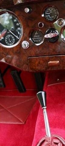

Default Comparison of pedal spacings: 150, 140 and 120
These jpgs illustrate the pedal spacing of three Jaguars in the XK-1n0 series. Left to right are illustrated the 150, the 140 and the 120. The 120 snapshot does not give us a really clear view, I will keep and eye out for a better photo.
However, it appears the odd, exaggerated gap between the brake and acclerator pedals is a peculiarity of the XK-150.
I am still wondering if there isn't a bolt-on fix for this--a modified pedal stem that would float the brake pedal in the region of that shown for the 140. That 140 looks like perfection to me.
Thank you for your insights. John
