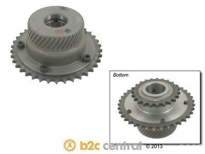

The larger of the gears (one cam) advances and retards. It does so thru a fairly simple mechanism that works with oil pressure produced by engine rpm and the actuators (if you have them I forget with your model year) at the top and very front of the cam cover... I really don't think this is your problem... Skipping and jumping teeth (unless your sprokets are WAY loose) is the only way (I think) "creep" could occur and still, by then, you and the engine would be up ***** creek!!! I mean, when you remove the covers do the flats still line up,,, or not?

Does/do your cam gears look like this/these?
I'm confused

Flipped what gears?
I'm confused

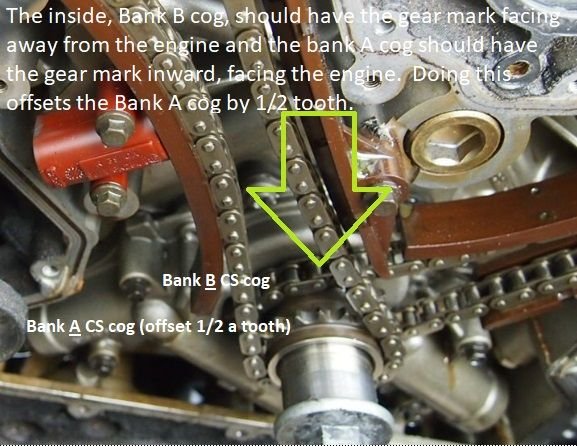

No Jay, not the cam gears, the crankshaft cogs/gears. They keyway match up on the crankshaft but you must flip the gear for bank A so that its 1/2 tooth offset. I DONT REMEMBER IF I DI IT THE LAST TIME I HAD IT ALL APART.
Jay, here's what I'm talking about..... Made this just for you. lol

Ex, this car is trying to kill me, im sure of it! Lots of good info in there and I appreciate it. As of 30 min ago, the car is once again stripped down to the heads and timing chains. All tensioners and the A/B primary crank gears are perfectly in place with no skipped teeth n whatnot.
