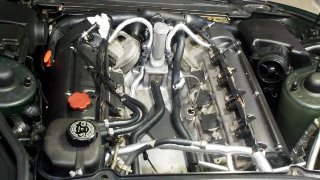

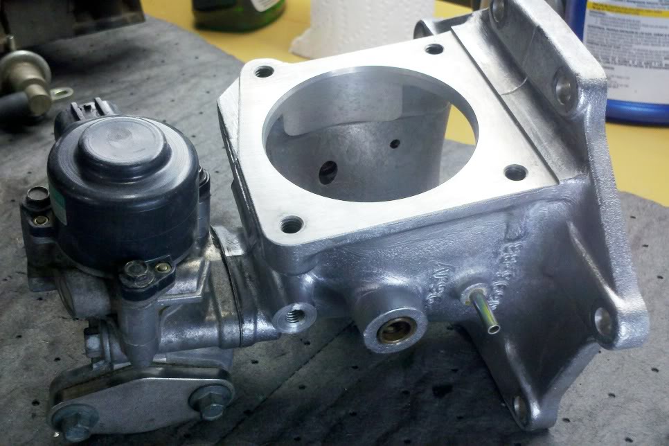

Here's few photos from my work in that area...
Name:  EngineIntakeManifoldandThrottleBodyRemovedaftercleaningandcooltubesinstallb3-12-2012_zp.jpg

If you look at the photographs in post #2, the "valley" (heater) hoses are the two which run from the front of the engine to the back in the "valley" betweenthe two heads. No - a bit of off-the-shelf hose won't work, they are a particular shape. a) they are not particularly expensive, and b) if you're going in there which is a fair amount of work - why not do the job properly ? If you remove the intake, you will need 8xseals, a throttle body gasket and an intake elbow seal. Again - not particularly expensive. The octopus hose IS quite pricy, but looks like you already did that one ?
